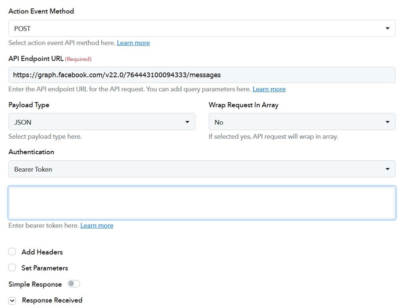

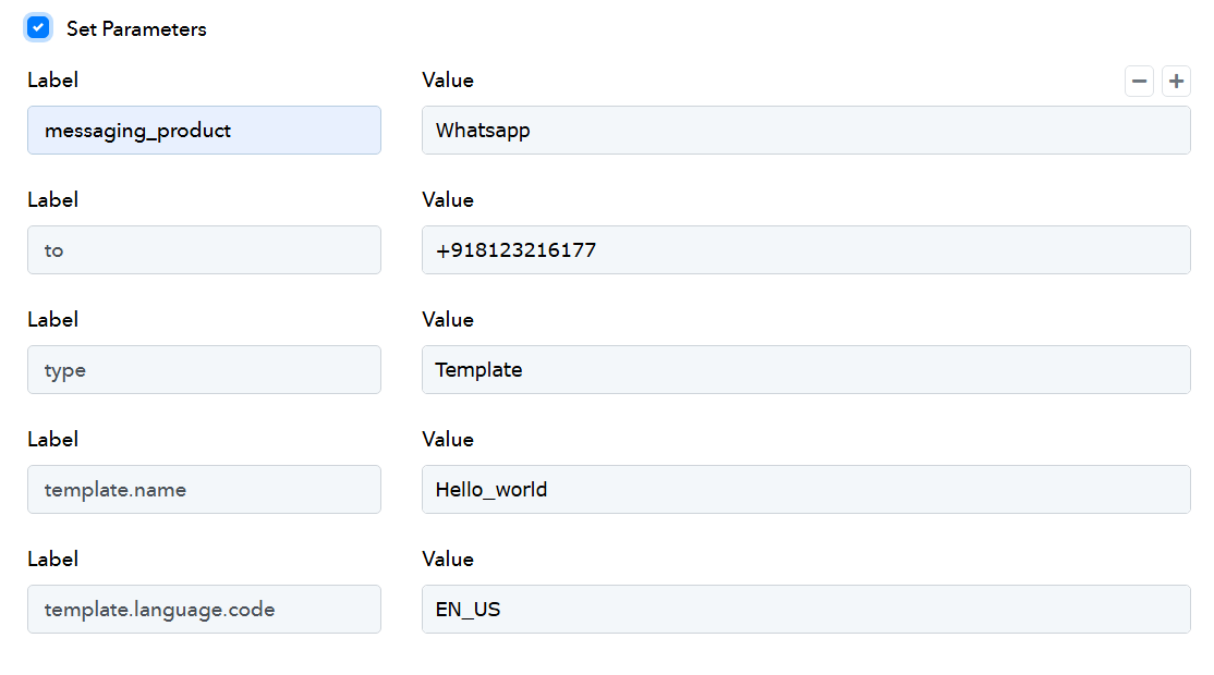

I have added API in workflow and provided all required details but i am facing error.
1. I have selected json but could not able to see the data(json raw)

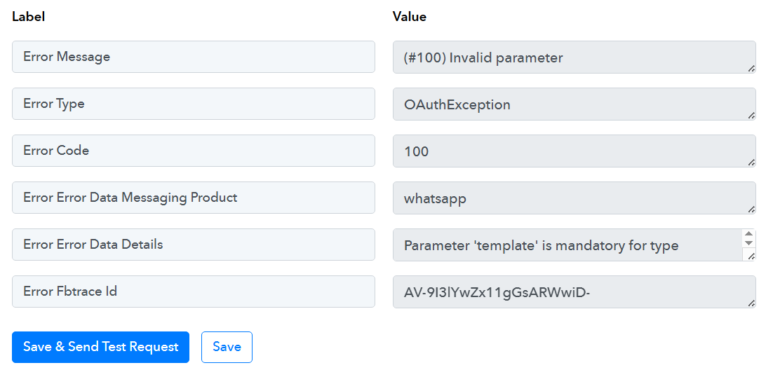

2. I have update manaully under set parameters and could see below error
Please suggest

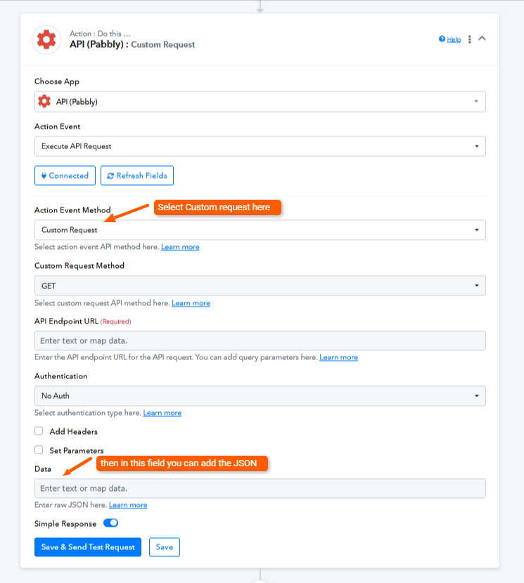

Hello @Amruth2010,

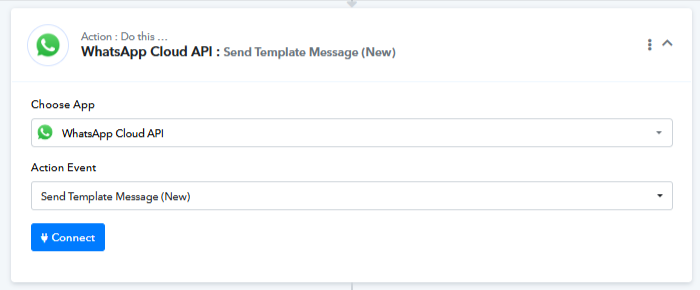

We have an integration with WhatsApp Cloud API where you can directly use the Send Template Message action. The error you are facing occurs because the template parameter is not being passed correctly. We recommend trying the WhatsApp Cloud API action in Pabbly Connect to see if it works for you.

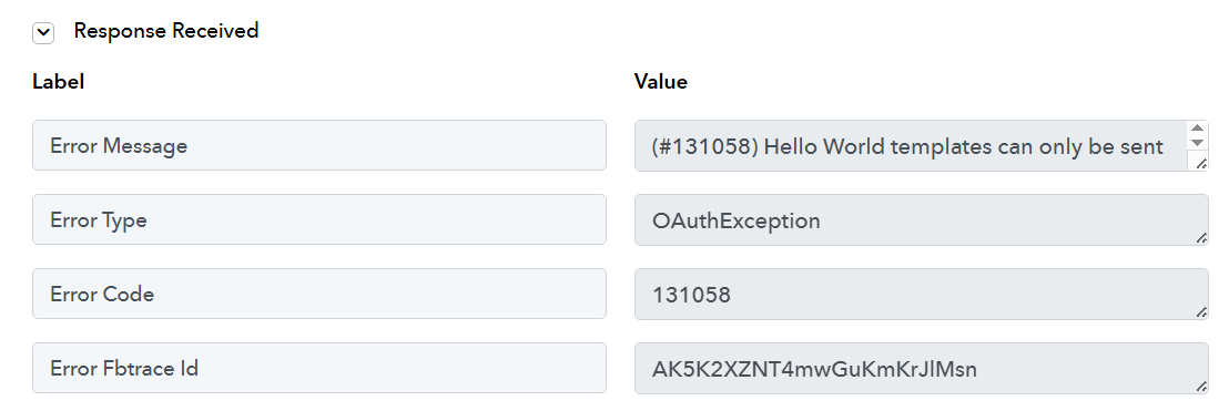

now i could see below error, can you please suggest
(#131058) Hello World templates can only be sent from the Public Test Numbers

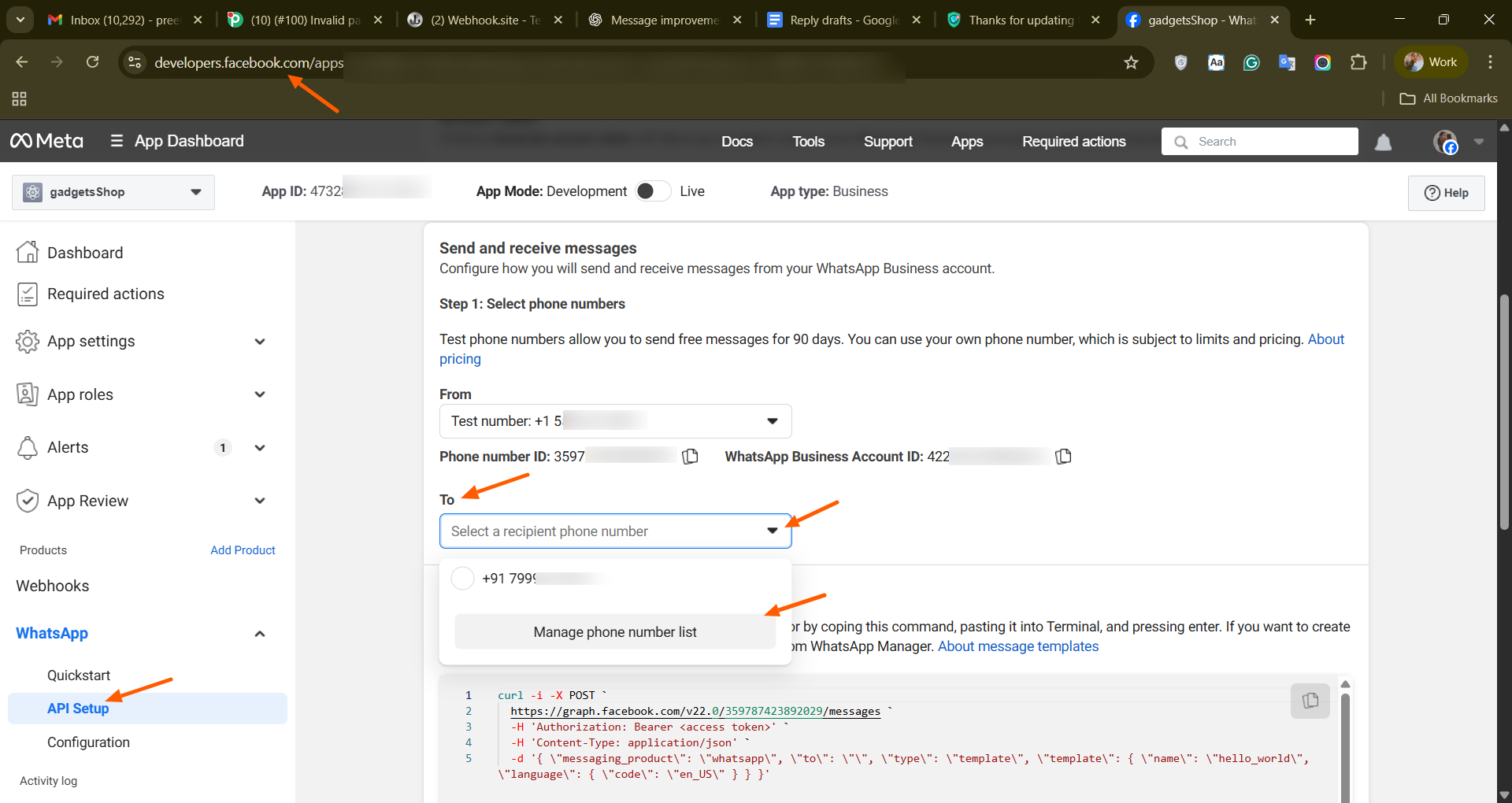

It seems that you are using a test number to perform this action. Please note that when using a test number with a temporary token, the recipient numbers must be added to the test number list (refer to the attached image for clarity). You can add a number there and then try sending the message again.
Hi @@Preeti Paryani,
Thanks for your quick response.

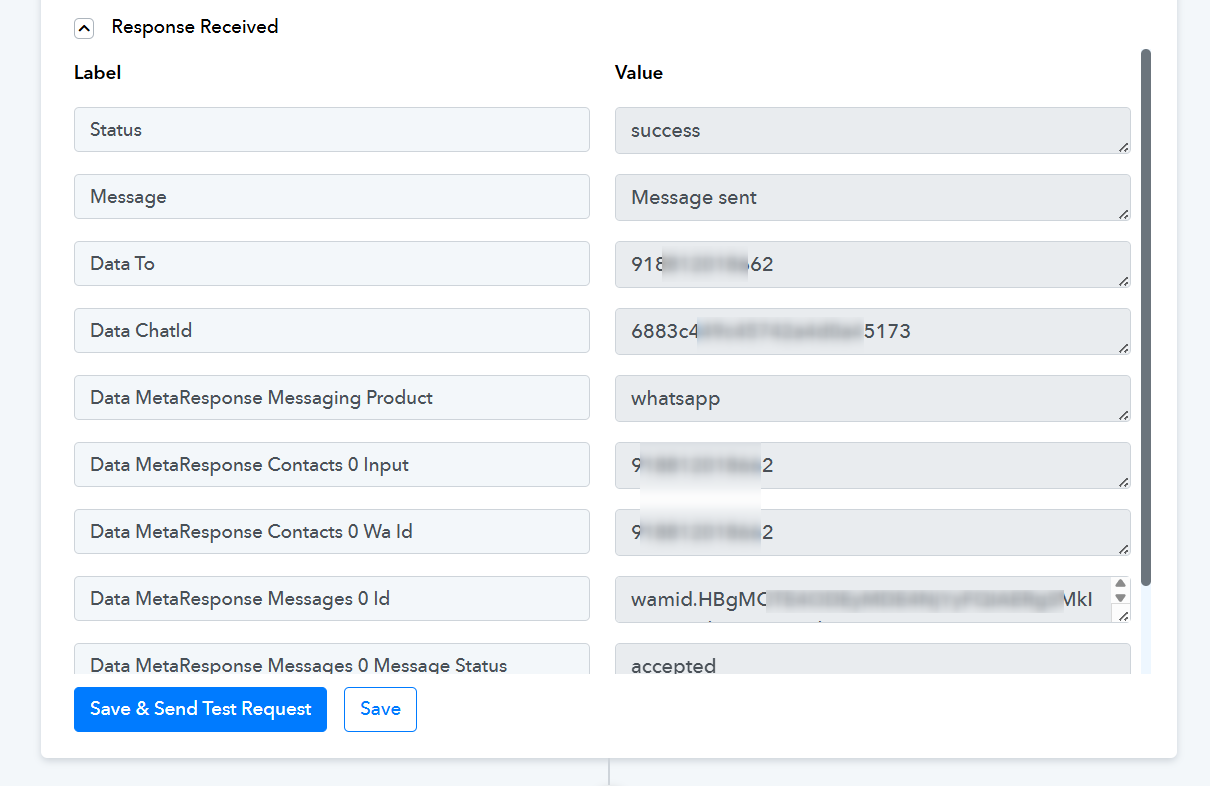

I just tried recreating everything again. Based on your above suggestion, it is working now.
