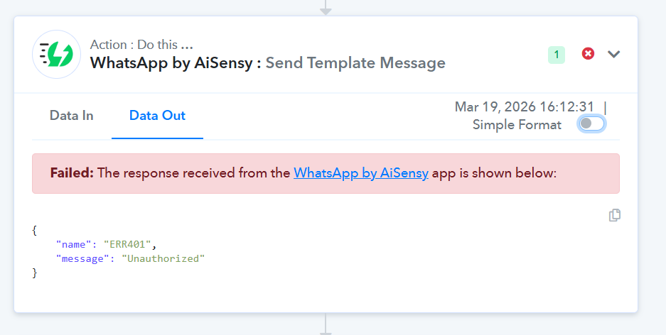

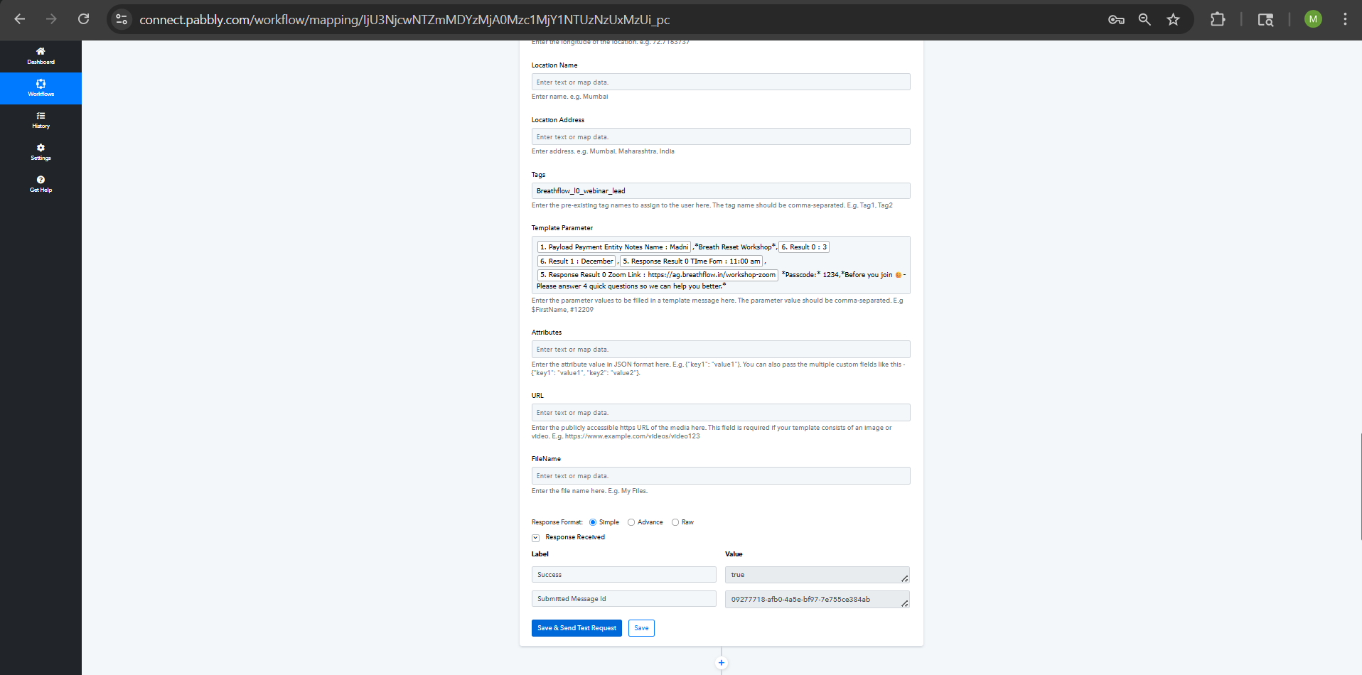

I am using Aisensy to send whatsapp, here when I did "Save & Test Response", I got the whatsapp confirmation message(True as you can see in the screenshot), but when I did testing by triggering whole workflow, it says Aisensy unauthorized, so can you please look what has gone wrong here:

Our team has checked the issue, and it appears to be related to the current setup of the workflow. To verify this, we cloned your existing workflow and reconfigured the AiSensy action, after which it worked correctly in automation.
We have created a separate test workflow for reference. Kindly do not delete it, as it may help in further analysis if required.
https://connect.pabbly.com/workflow/mapping/IjU3NjcwNTZmMDYzMjA0MzM1MjZhNTUzNzUxM2Ii_pc
As a resolution, we recommend the following steps:
  1. Go to your original workflow.
  2. Delete the existing AiSensy action steps.
  3. Reconfigure the AiSensy actions again from scratch.
  4. Save the workflow and test it via automation.
This should resolve the issue.
