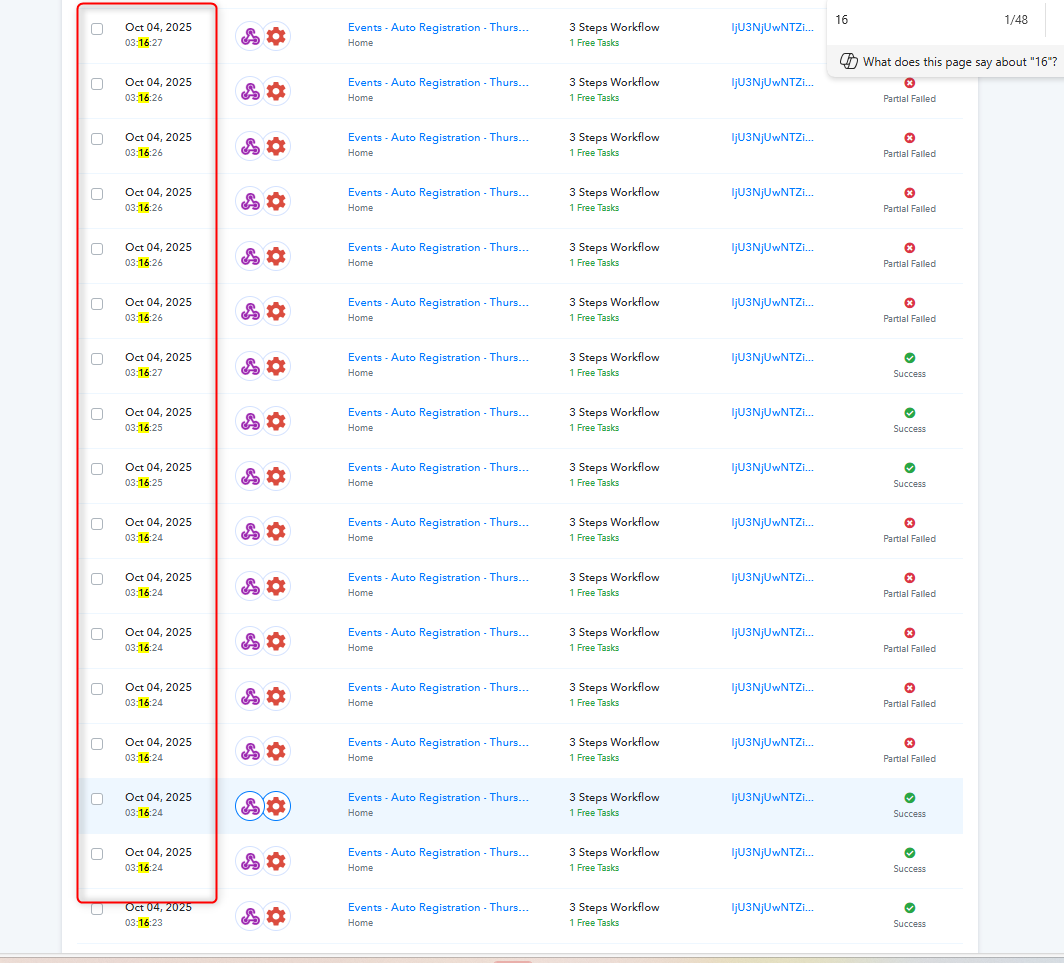

The workflow is triggering once a week for approx 85 records at once, where there is a GET request being sent to Ontraport, to get data and that step is failing due to - API concurrency limit exceeded. Please try again later.

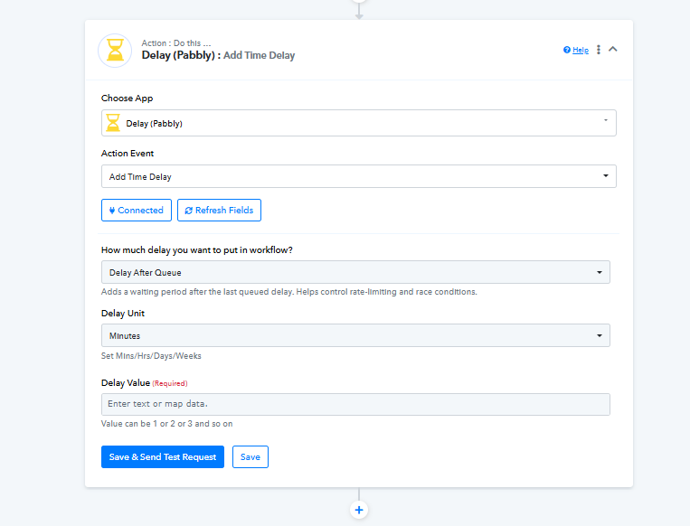

As we checked, the workflow is sending a large volume of data at once without any delay between the requests. To help resolve this, we recommend adding an additional action step “Delay After Queue” to introduce a gap between requests.

Regarding the 'Delay After Queue' action, can you share how this can be added to the current build? And does this mean that you'll progressively release the records running through?

Additionally, to reduce the likelihood of hitting this limit, you can add a Delay step before the API action. This will process the data in intervals, allowing the next action step to run smoothly.
