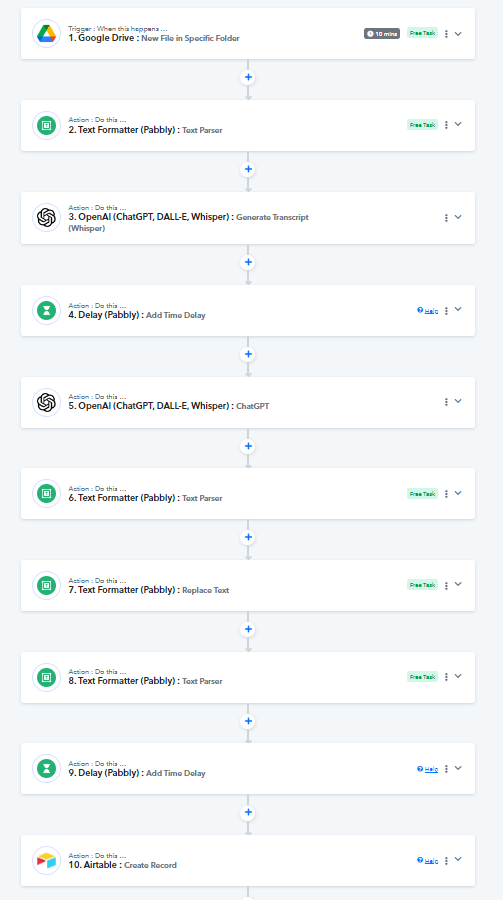

I am frequently encountering problems with my automations. Although they seem to be functioning correctly, the update step on Airtable is not executing as expected.
The main issue is that I am using OpenAI credits inefficiently because the results are not being imported into Airtable. Specifically, either I receive no results in Airtable, or an error message appears on Pabbly stating: "Rate limit exceeded. Please try again later." or "Empty Data 123."
What is particularly frustrating is that I either have to set up my Airtable with Pabbly every month or I end up with no results at all. This constant need to reconfigure my setup every month is unacceptable and severely disrupts my workflow.

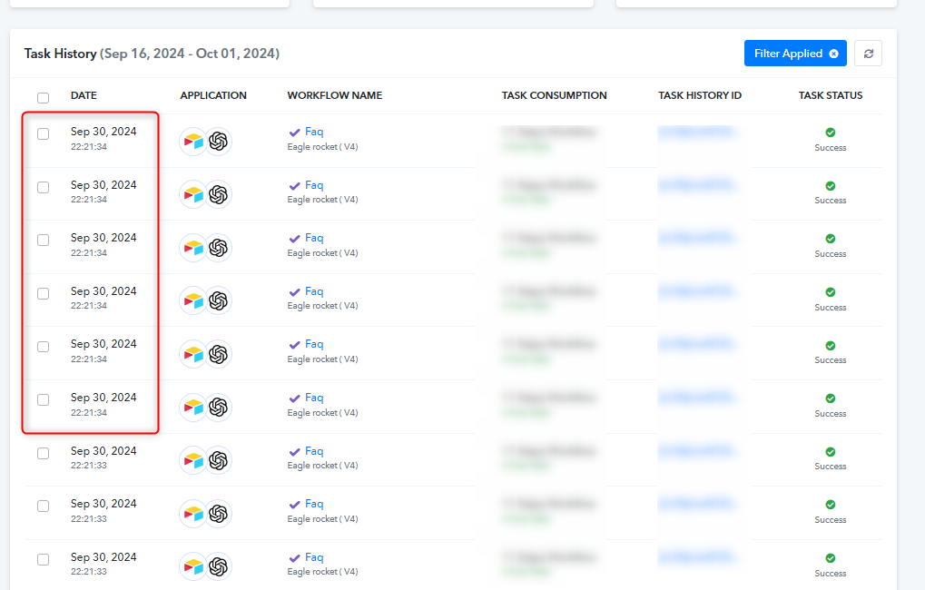

Hey @OlivierFrench

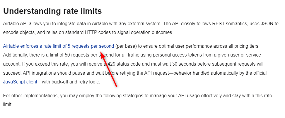

It appears that the "Rate Limit Exceeded" issue arises when there is more than 5 requests per second. This information is provided in the API documentation of Airtable. Kindly refer to this link -
https://support.airtable.com/docs/managing-api-call-limits-in-airtable#:~:text=Airtable%20enforces%20a%20rate%20limit,given%20user%20or%20service%20account
And in your workflow, it is visible that you are capturing more than 5 entries almost every time. You can add a delay for 1 minute before the "Create Record" step to try and rectify this issue.

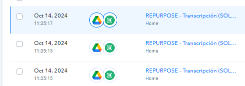

Hey I have the same exact issue with this airtable error. What happens in my scenario is that the trigger for the whole process is a new file in specific folder in google drive.
The problem with this is that we upload hundreds of new files to be processes at the same time.
The delay before the "create record" which i am trying right now, will delay by one minute all of the executions. But the problem is that they execcute at the same minute after 10 minutes of watch time.
So i guess that the delay before "create record" in airtable is going to delay all of the executions by the same time, but again in 1 min, they will all try a api call to airtable making it fall into the error.
Is there a way to delay every 10 executions of the scenario by 1 minute? Or something similar?

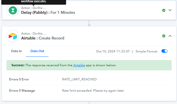

I just wanted to make this uptdate. I added the delay for 1 min but again the rate limit happened, only by processing 5 archives in the same minute, i think those 5 archives have to make 2 api calls each to airtable, meaning 10 calls in 1 min. 4 of the 5 archives got well processed, but this one.
I hope we can solve this soon.

Thanks for the info but both the errors are different. Our team is looking into the issues happening because of the "Empty data 123" error. Regarding the Rate_Limit_Reached error it would have raised due to a certain number of requests, you can refer to the following link for more info on rate limits with Airtable - https://airtable.com/developers/web/api/rate-limits
