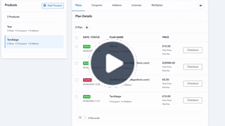

See here please for demonstration
https://share.getcloudapp.com/mXuxpLQN
When will this be fixed?
And what do I do in the mean time (apart from manually customizing each duplicate manually)?

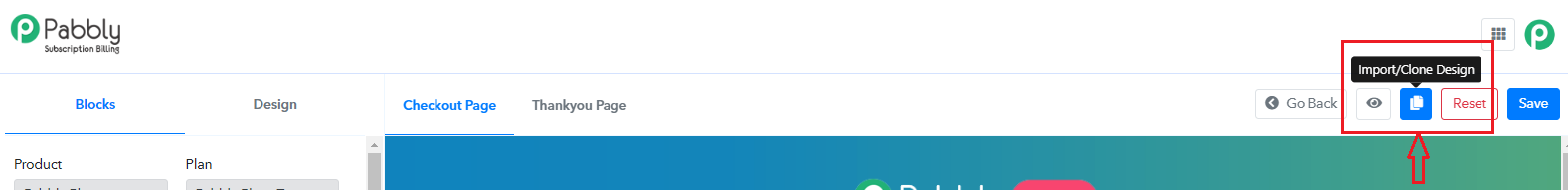

Hey Anders,
Cloning a plan does not duplicate the checkout customizer settings.
To clone a checkout page design, you need to go to checkout customizer and use the "Import/Clone Design" option. Refer to the image below.
