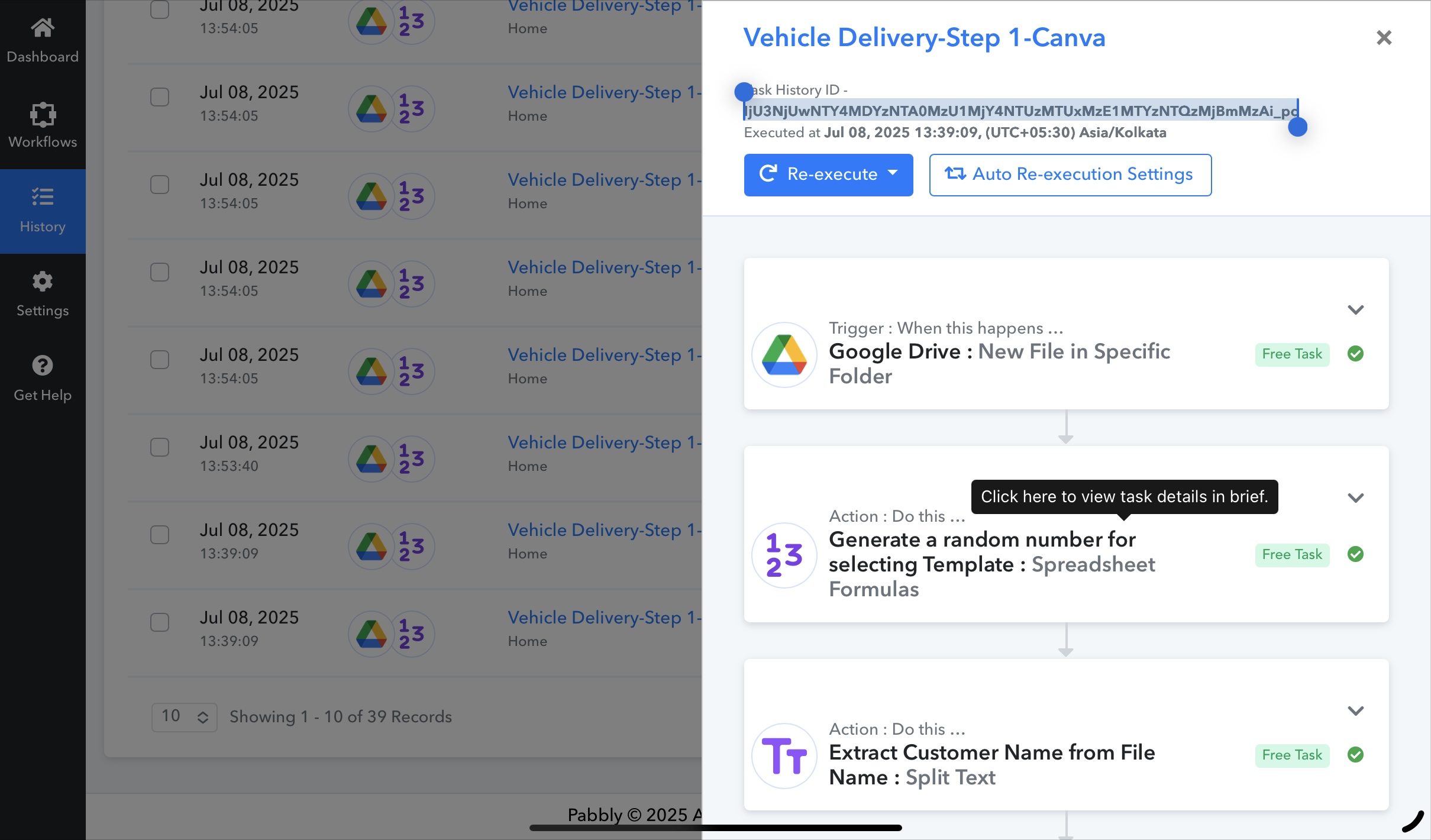

Task id: IjU3NjUwNTY4MDYzNTA0MzU1MjY4NTUzMTUxMzE1MTYzNTQzMjBmMzAi_pc
Workflow name: Vehicle Delivery-Step 1-Canva
The above task id is one of the failed ones out of the few.

Ok got the connection issue again of access token revoked.
Task history ID: https://connect.pabbly.com/task/history?filter_status=applied&filter_by_task_id=IjU3NjUwNTY4MDYzMDA0MzY1MjY0NTUzNzUxM2I1MTYyNTQzNTBmMzgi_pc

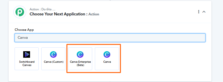

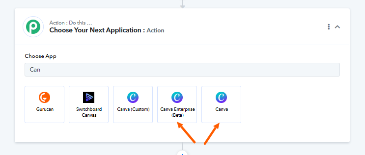

Hello @usman,
We’d like to inform you that our team has created two new applications for Canva:
  • If you have a Canva Enterprise account, please use the Canva Enterprise (Beta) application.
  • If not, you can use the regular Canva application in your workflow actions.
These updated applications are designed to resolve the token expiration issue you were facing.
Please give it a try and let us know if you encounter any further issues.

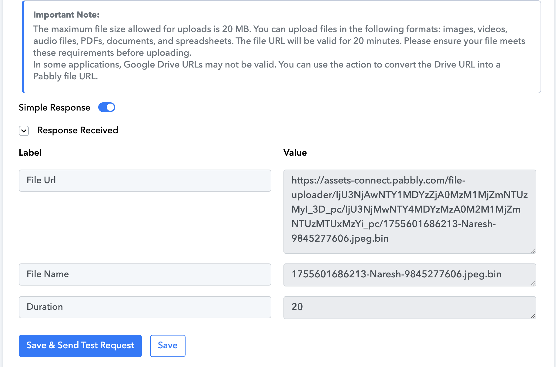

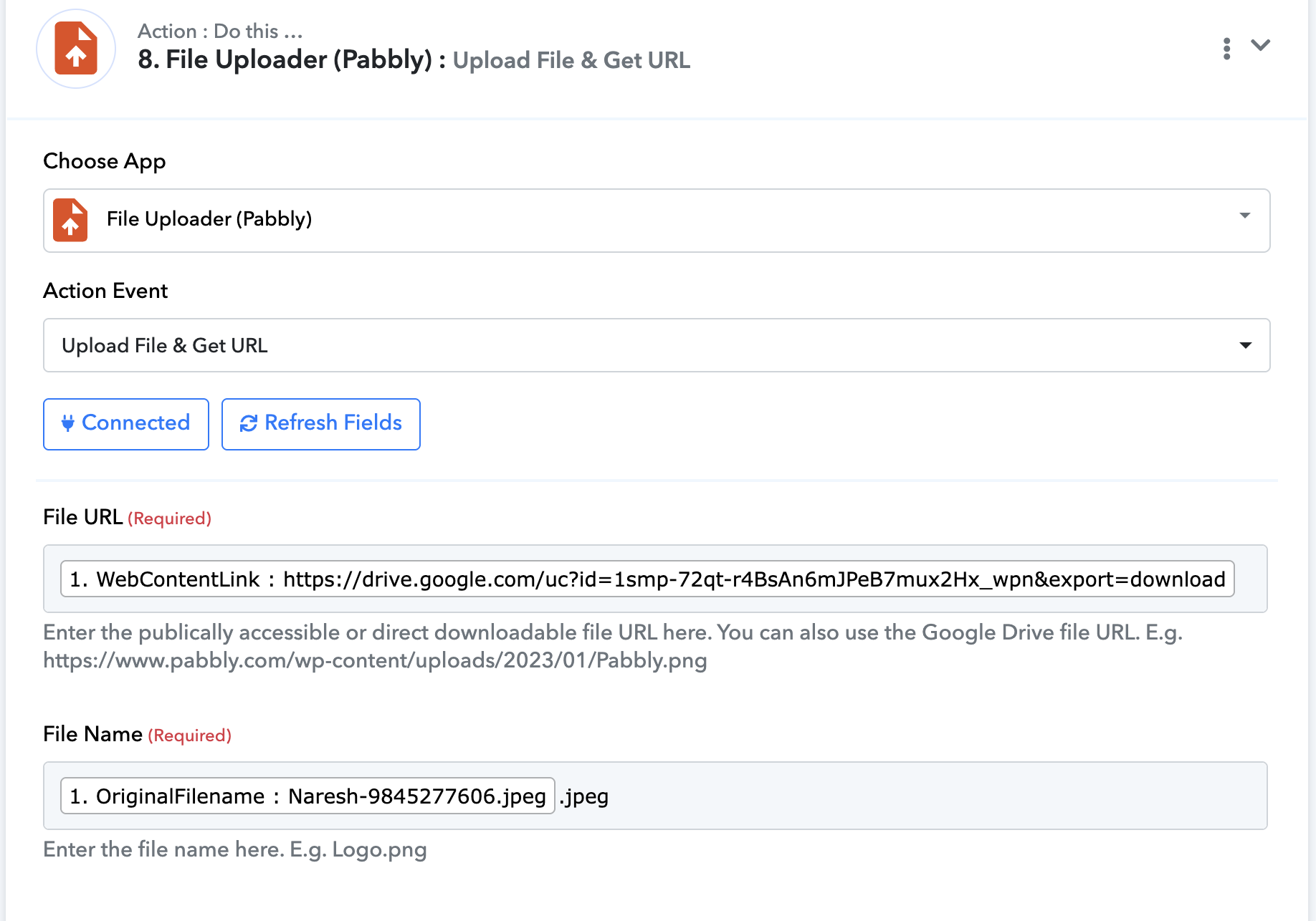

Hi I have tried the new Canva app connection. It does not accept google url for uploading the asset, so i used the Pabbly File uploader. I am uploading a jpeg file but the file url i am getting back is a *.bin format. I tried adding the file extension as well separately in the file name field but the same issue.
Hello @usman,
usman — Reply ·
This is sorted. The file in drive had got deleted as it was an old one and the same files wa sbeing processed.

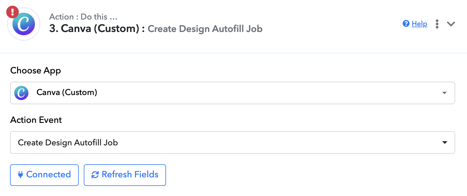

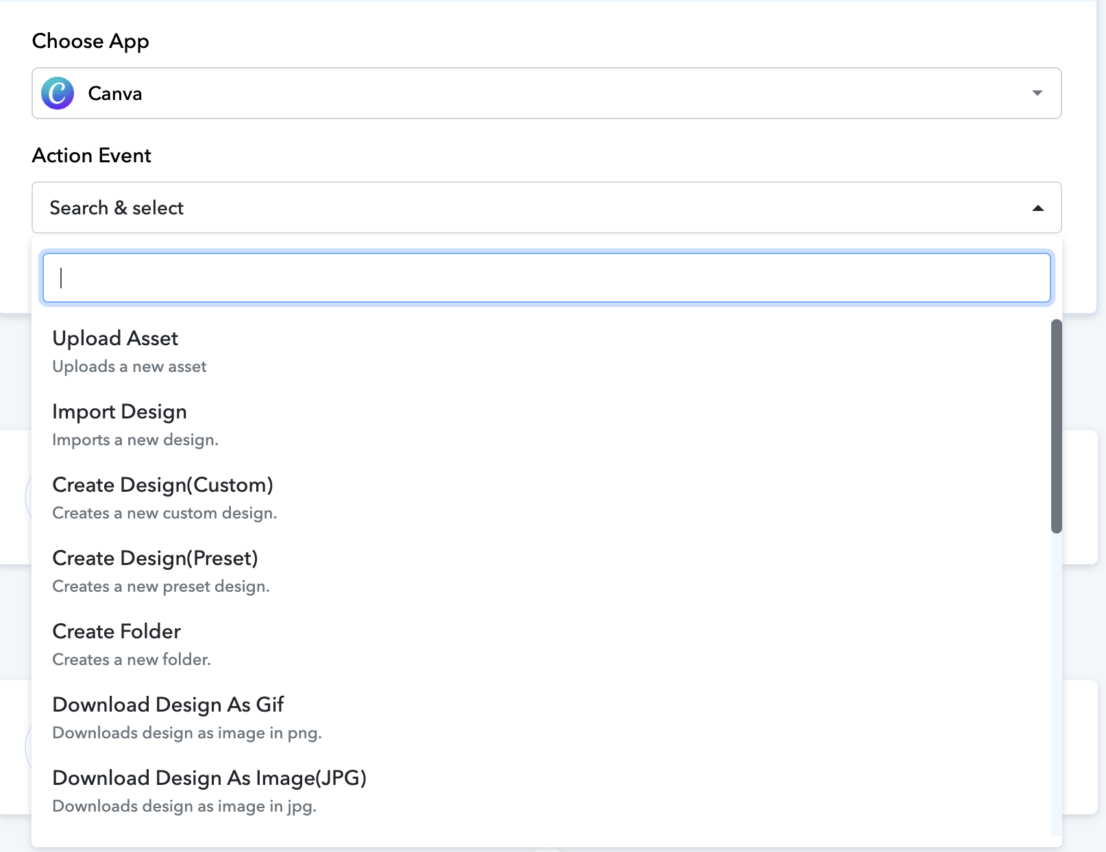

dont see the Create Autofill Design job in the new app. What is the alternative.
Hello @usman,
The Canva custom application you are currently using has been deprecated. To move further, we recommend switching to the updated applications.
  • If you have a Canva Enterprise account, please use the application named Canva Enterprise.
  • If you do not have an enterprise account, please use the standard Canva application.
Please note that the Create Design Autofill job is available under the Canva Enterprise application.
Kindly make the switch based on your account type and let us know if you need any assistance
usman — Reply ·
I don’t have the Canva enterprise account. So how do I do this in the pro account.
Hello @usman,
That particular action is currently available only under the Enterprise account. If your account is not on Enterprise, you won’t be able to use it.
