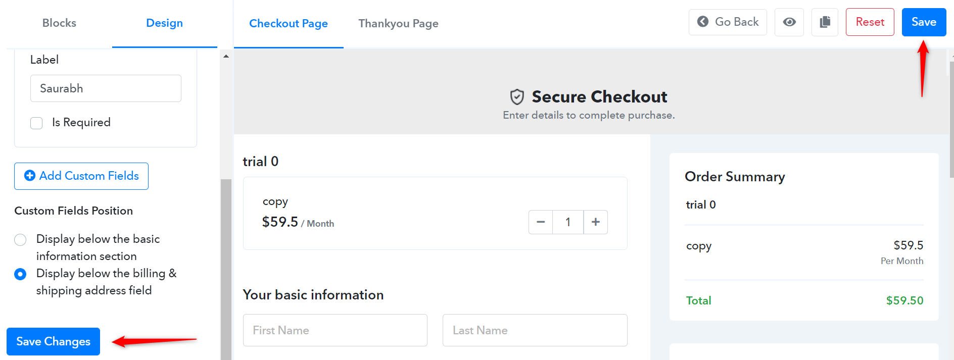

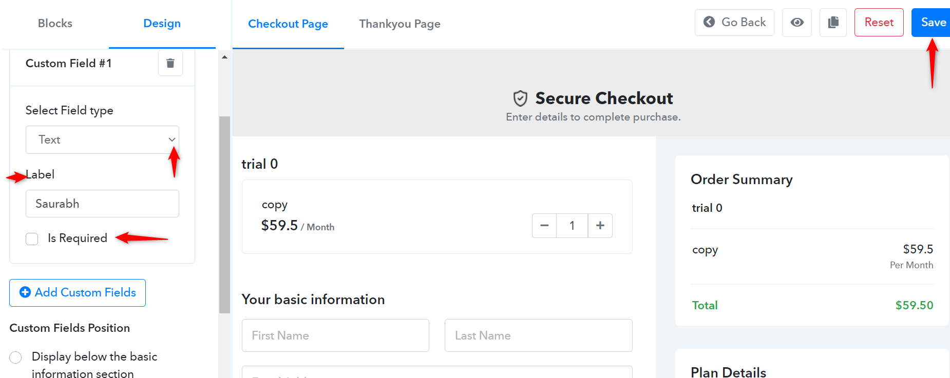

Hello There!
We would like to inform you that you can add the additional field (Company Name) in Checkout Page through Checkout Customizer and also this could be reflect on the Invoice through the Email Notification under the Settings.
Steps for adding Company name in Checkout Page.
Click on 3 dots given against the plan >> Checkout Customizer >> Custom Field >> Select Field Type (Text) >> Label (Company Name) >> If you want your customer to add company name mandatory then click on Is Required box. Then Save this on Design as well as on Checkout page option.

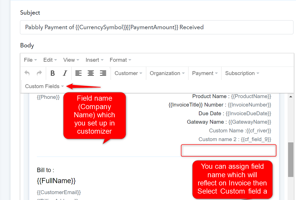

Vipin Mishra — Reply ·
Also, this field can reflect in Invoice through the Email Notification of Invoice editing.
Steps required :
Settings >> Email Notification >> Click on 3 dots given against Emails >> Edit
Hope the above information helps.
If you need further support please reach out to us.
