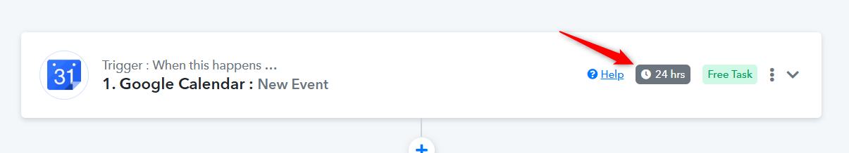

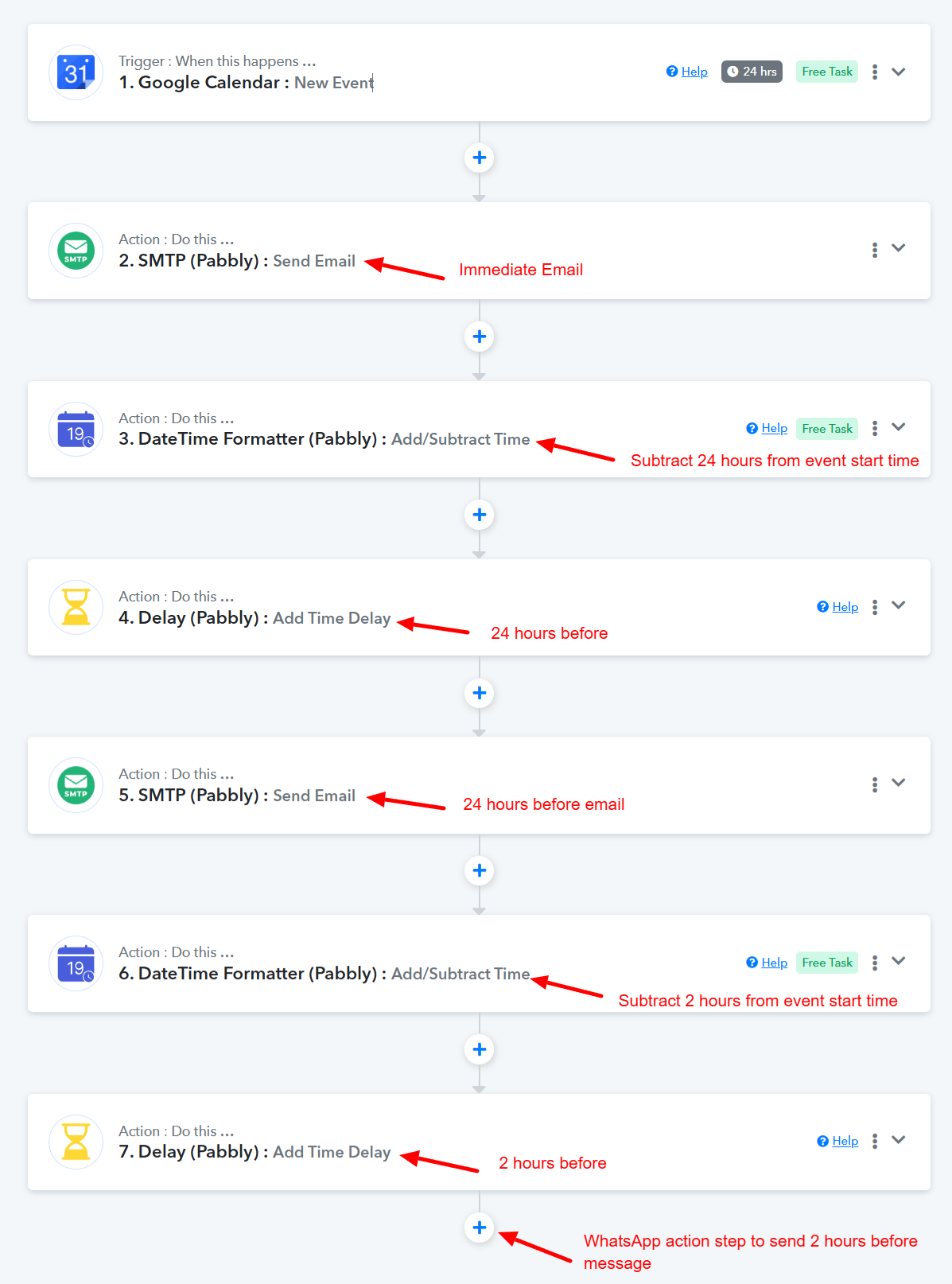

We have added the Date/Time Formatter and Delay steps to your workflow. You can now add the email to be sent 24 hours before the event start time, as well as a WhatsApp action step to send a message 2 hours before the class.
Please note that Google Calendar has a trigger interval of 24 hours, which means Pabbly Connect checks for new events in your Google Calendar once every 24 hours. If a new event is found, your workflow will be triggered accordingly. However, due to this 24-hour trigger interval, it may cause issues with the use case you are trying to achieve.
We can reduce the trigger interval to 10 minutes on paid plans.

Hello @Tokyorob77,
Yes, that's correct. Since the trigger time for your current workflow is set to 24 hours, any customer you add will only be captured in the workflow after that period.
However, most of your customers being added a week in advance should work fine with this setup.
If needed, you can reduce the trigger interval to as low as 10 minutes, but this option is available only on our paid plans. Once you feel confident that Pabbly suits your needs, you can consider upgrading to a paid plan to enable faster trigger checks.
