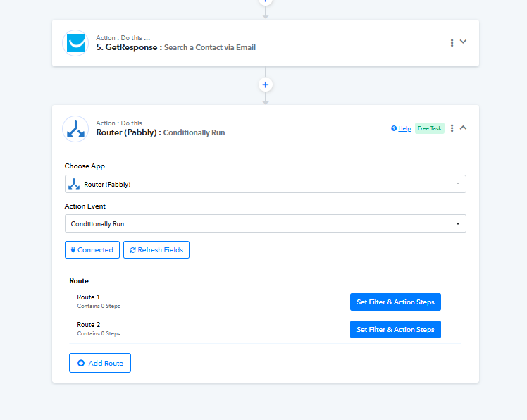

- First, add the action step “GetResponse: Search a Contact via Email” to check if the contact exists.
- Then, use “Router (Pabbly): Conditionally Run” with two routes:
- Route 1: If the contact doesn’t exist → add the action step to create the contact in GetResponse.
- Route 2: If the contact exists → add the action step to update the contact in GetResponse.
This setup ensures your workflow handles both existing and new contacts without errors.

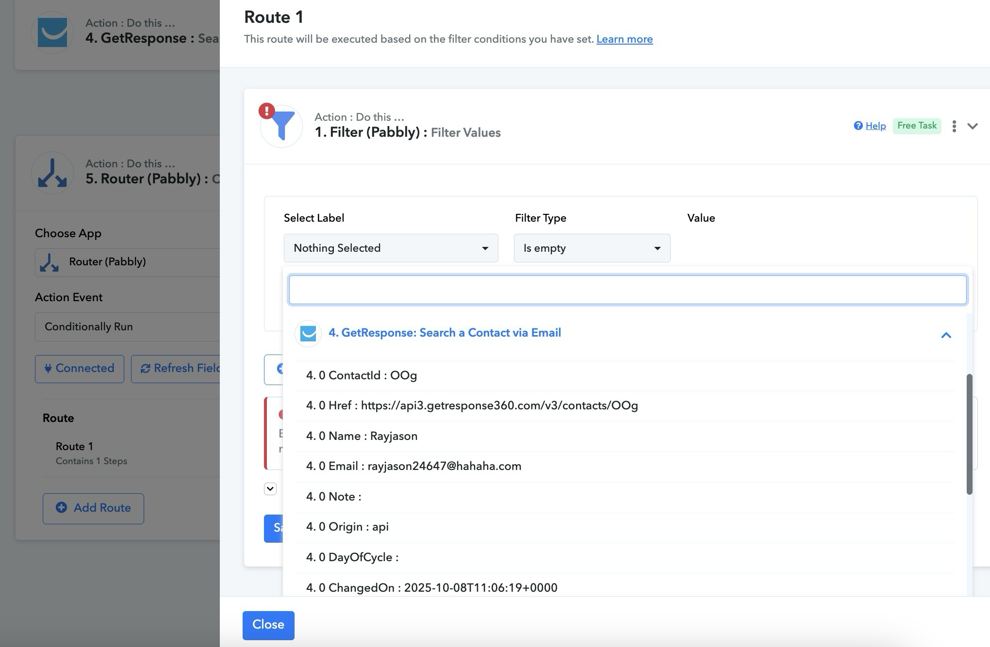

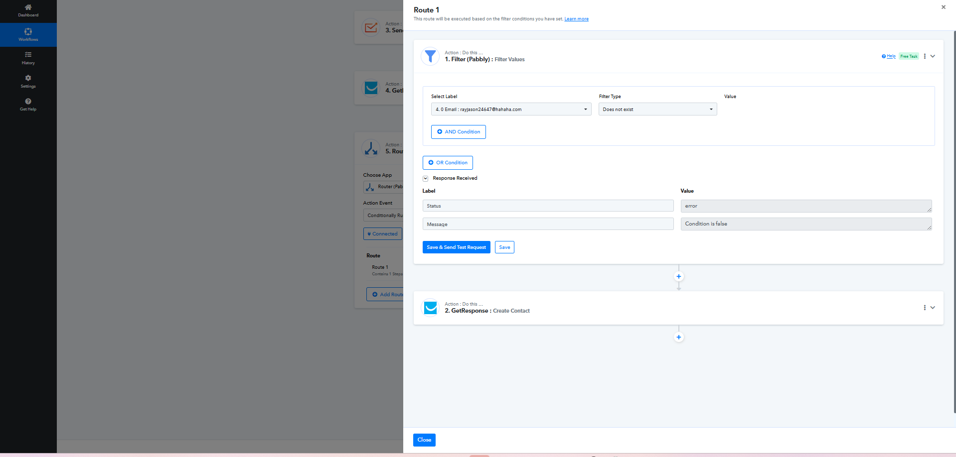

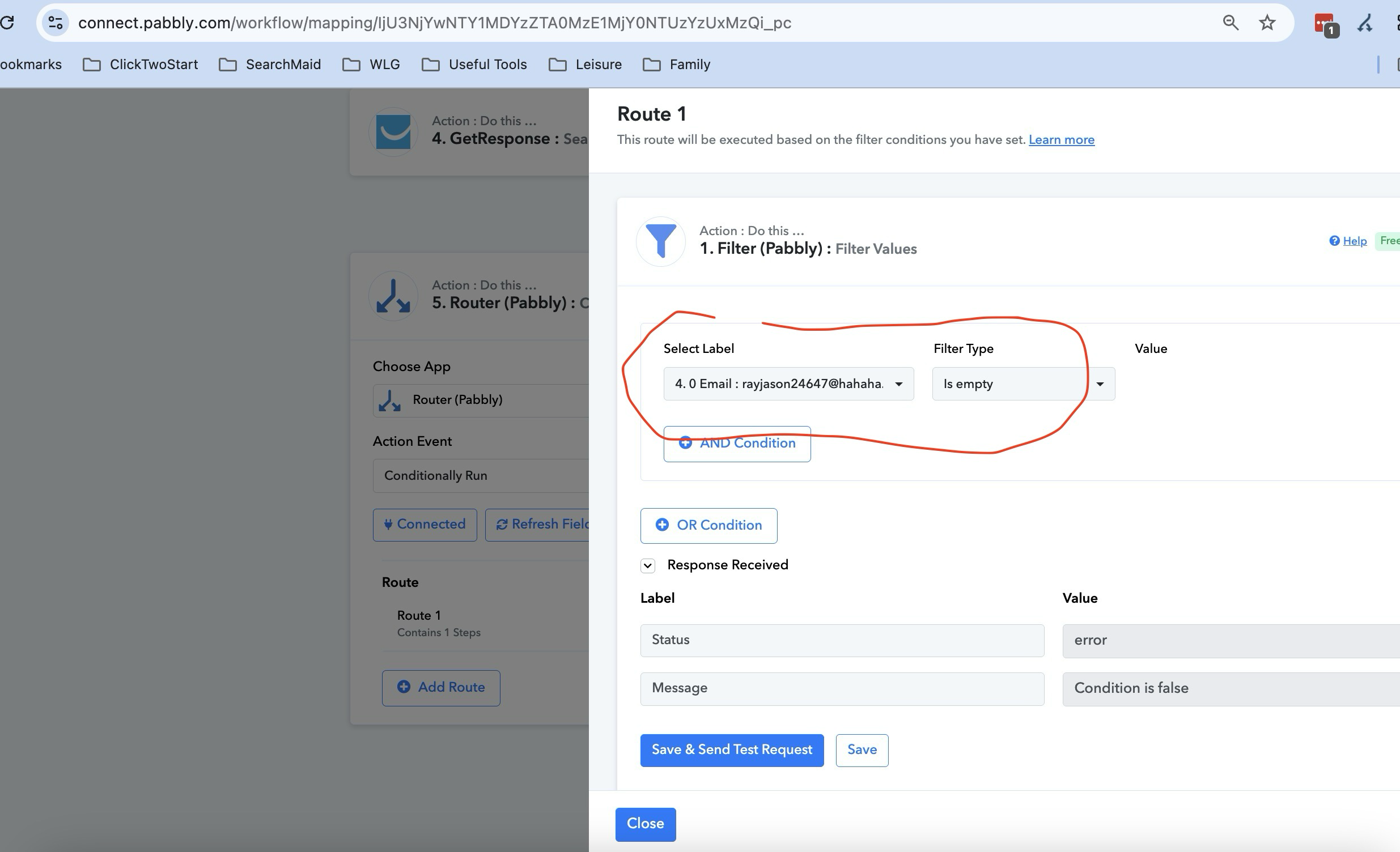

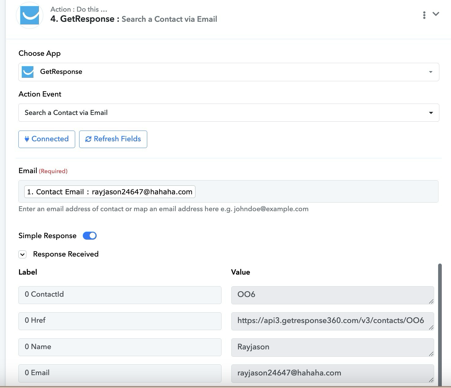

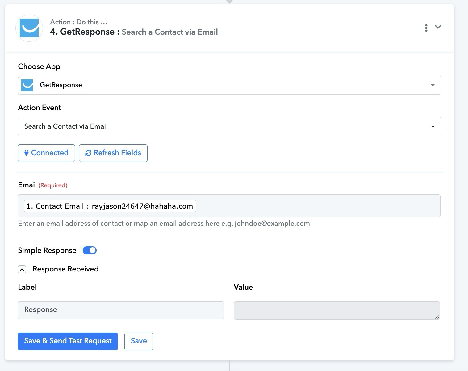

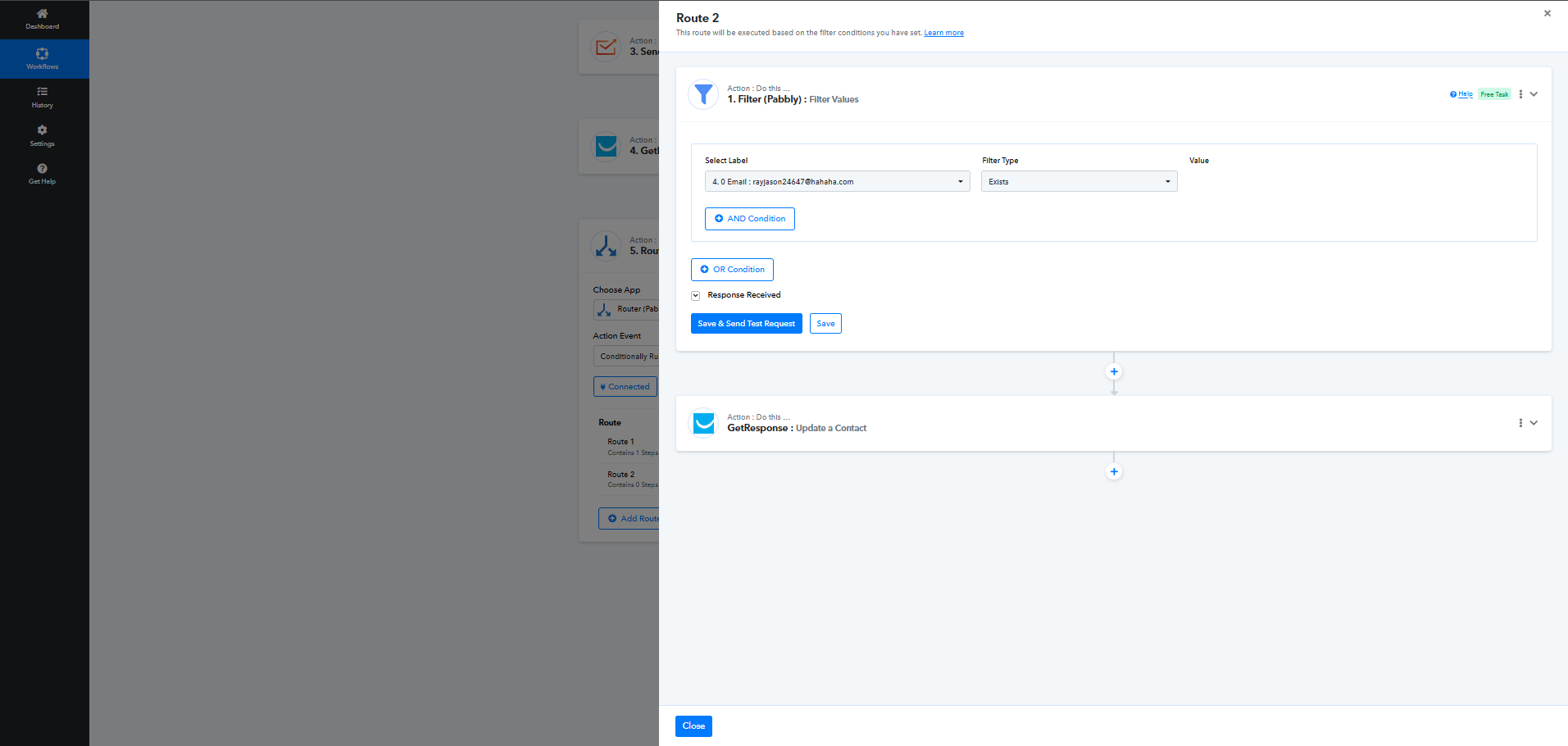

When the email is not found on Getresponse, "Search a contact via email" will return only Response = (empty)
But it will not return the Response field if if the contact exist.
In this case... how do I create "If the contact doesn’t exist" if Response field is not available in all situation?
Hello @clicktwostart
In the filter, you don’t need to select “is Empty.” Instead, you should select “Exists” or “Does Not Exist.”
For email addresses that do not already exist in GetResponse, the label shows Response: Empty, whereas for contacts that exist, it shows Contact ID, Email, and other details. You can use any of these two as parameters for filtering.
This works, thank you for the huge help!
