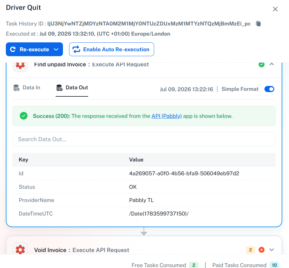

task ID: IjU3NjYwNTZjMDYzNTA0M2M1MjY0NTUzZDUxMzM1MTYzNTQzMjBmMzEi_pc

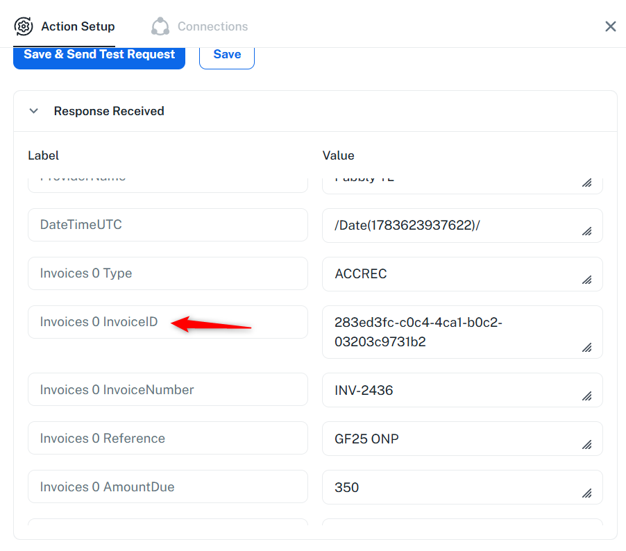

Workflow: https://connect.pabbly.com/v2/app/workflow/mapping/IjU3NjcwNTZlMDYzMDA0MzE1MjZlNTUzNjUxMzci_pc
From screenshot below you should be able to see an ID was generated from the api called "Find unpaid Invoice".
The second screenshot shows that the id was not loaded into "void invoice". It shows as blank even though the previous step did in fact produce an ID.
I set up the workflow to use the ID generated in the find unpaid invoice step in the void invoice step.
Pabbly Support β€” Reply Β·
In your workflow setup, you have mapped the ID using the key Invoices 0 InvoiceID. However, in your automation, this key is not being returned. Instead, you are receiving only the ID key.
Because of this mismatch, no value is being mapped to the next step.
If you want the ID to be passed to the next step during automation, please map the ID field instead.

I am still looking into this as when I manually do it, its Invoices 0 InvoiceID.
So I am testing some other accounts to see if they change based on number of invoices or if there are no invoices at all.
