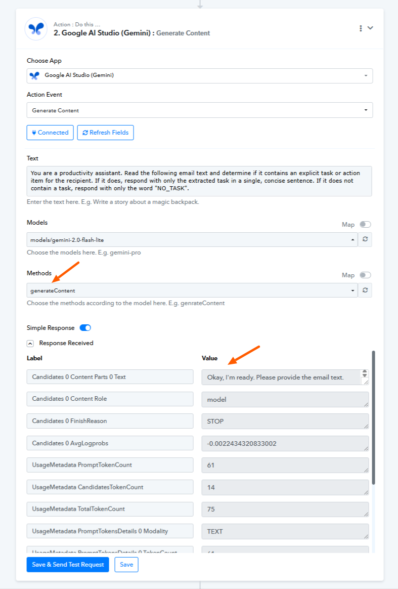

Hi All,
My workflow is failing on the Google AI Platform / Gemini step with a persistent 404 Not Found error.
I have already done the following troubleshooting:
  • Confirmed my API key is correct and that billing is enabled on my Google Cloud project.
  • Confirmed that the Vertex AI API is enabled in my project.
  • Tried reconnecting my account in Pabbly multiple times.
  • I have tested multiple different models from the dropdown menu, including gemini-1.5-flash and gemini-1.0-pro, 2.5 and all of them return the same 404 error.
What could be causing this, the API endpoints? I'm only using the suggested ones.
Hello @PGK,
It appears that an unsupported option has been mapped in the Method field, which is causing the issue. Please select the method from the dropdown list, and it should work fine.
