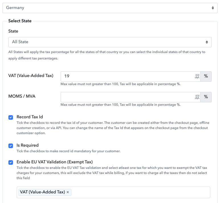

Example - Germay: 19% VAT. My VAT set up is as below.

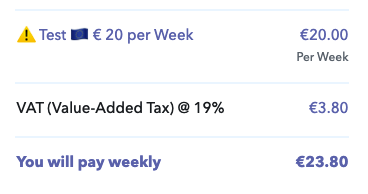

My product is €20. When I proceeded a test payment with a fake VAT ID ( I used ABC123456 ), it shows that 19% VAT is to be included - see below.
After I clicked Next, Stripe was chargning me €20 and not €23.80 - No VAT was charged. Then when I checked in Invoices in Pabbly, it showed that the charge was €20, no VAT included.
My questions:
1. How do I charge VAT when a wrong / fake VAT ID is used?
2. When a customer pays, how do I know that their VAT ID is validated and correct?

Hello Thesis,
We have added a proper validation for the incorrect vat as well.
Now, you can test the same from your end and let me know.
