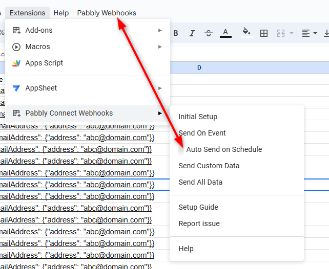

Hey @akajeevan
Could you please confirm whether you have selected the Pabbly Connect ad ("Send On Event" or "Auto Send On Event")?
If you are setting up Google Sheets and getting the data from the Google Application or inputting the data manually, you can only use "Send On Event". However, if the data is coming from a third-party application, then you may need to select "Auto Send On Schedule" and "Send on Schedule", which will take exactly 1 hour to forward.

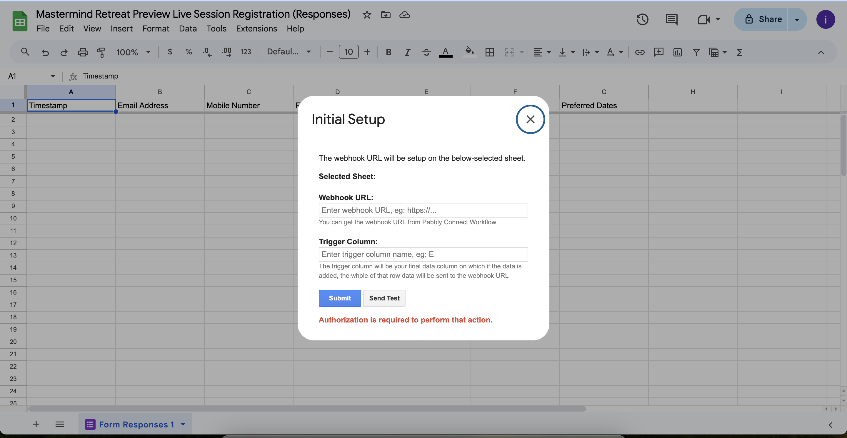

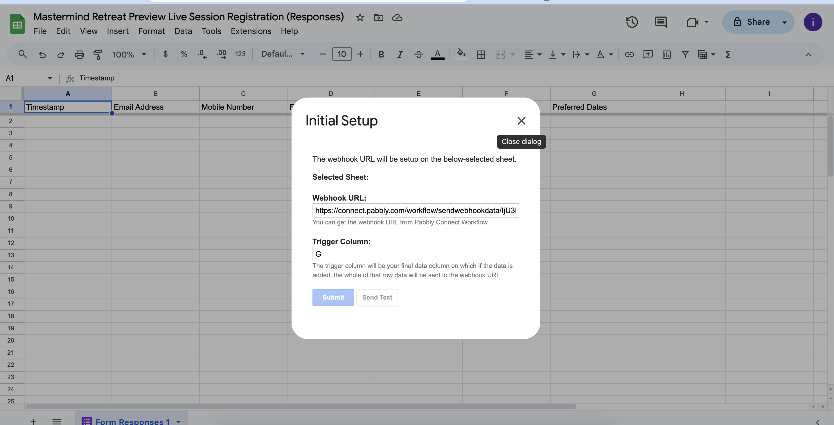

Here's the screenshot, seems like I am not able to add the Pabbly Connect webhook on to the Google Sheet that is attach to the google form. You can see the error message here.
So this is kind of bothering me, since I did a trial run adding my info into the google form, details are added to the attached google sheet but Pabbly couldn't receive the information shared.
Please try establishing the webhook URL of Google Sheets in Incognito mode of your browser, since you may have logged in to many Google Accounts in your browser.
Please configure it in incognito mode and try again.
