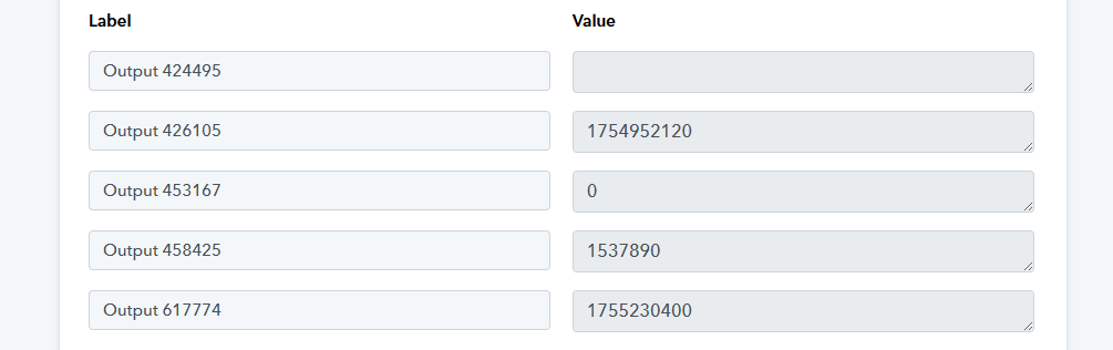

Here is the code that you can use with Code - Run Javascript action
const data = [
{ "custom_field_definition_id": 426105, "value": 1754952120 },
{ "custom_field_definition_id": 453167, "value": false },
{ "custom_field_definition_id": 458425, "value": 1537890 },
{ "custom_field_definition_id": 617774, "value": 1755230400 },
{ "custom_field_definition_id": 424495, "value": null }
const result = data.reduce((acc, item) => {
acc[item.custom_field_definition_id] = item.value;
return acc;
return result;
IjU3NjYwNTZhMDYzZjA0M2Q1MjY0NTUzMDUxMzci_pc
Thank you for sharing the workflow. You will need to add a Code step to the workflow to achieve your desired use case. There is no other no-code way to consistently map the data to the next steps.
You can use the code that Fagun shared with us and map the data directly from Code (Pabbly) action step.
In this workflow, we have shown how you can add the JS code to the workflow.
https://connect.pabbly.com/workflow/mapping/IjU3NjYwNTY1MDYzNjA0MzA1MjY1NTUzNzUxMzQi_pc
