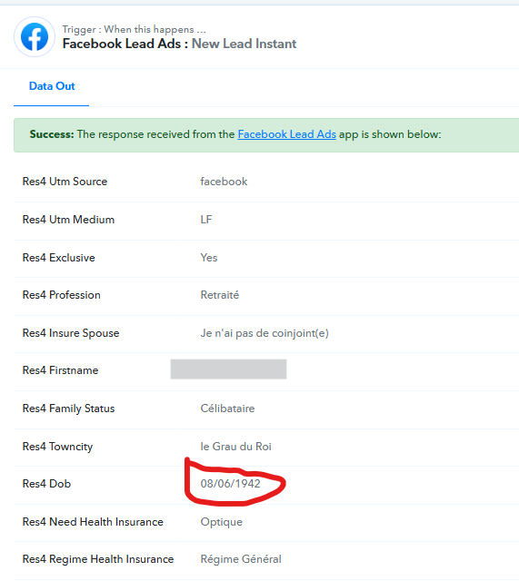

I am wondering why Facebook sends us leads with different date format for the same FORM ID. Is there something that we can do on our side ?

Sure,
Here is a correct task ID : IjU3NjUwNTZhMDYzMDA0Mzc1MjZmNTUzNzUxMzM1MTYzNTQzMTBmMzMi_pc
Exact field :
[TABLE]
[TR]
[TD]Res4 Dob[/TD]
[TD][/TD]
[/TR]
[/TABLE]
Correct DATE FORMAT received :
[TABLE]
[TR]
[TD]01/27/1957[/TD]
[/TR]
[TR]
[TD][/TD]
[/TR]
[/TABLE]
MM-DD-YYYY

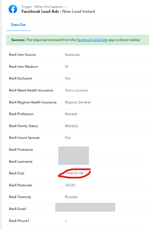

INCORRECT TASK ID : IjU3NjUwNTZhMDYzMzA0M2Q1MjZjNTUzNTUxMzY1MTZhNTQzODBmMzci_pc
[TABLE]
[TR]
[TD]Res4 Dob[/TD]
[TD]1936-07-08[/TD]
[/TR]
[/TABLE]
YYYY-MM-DD I guess.
Both data is received from the same form ID : 2266315310557006

We didn't found that Res4 DOB field appears to be a free-text field on our form. We selected a birthdate parameter in FB lead form creation. Is there any chance to add a rule for those leads which comes with "-" between numbers ? We found that they only come with the same date format : YYYY-MM-DD. We would like to apply a rule like "if the lead contains "-" between days or months or years, format the date into "DD/MM/YYYY"
