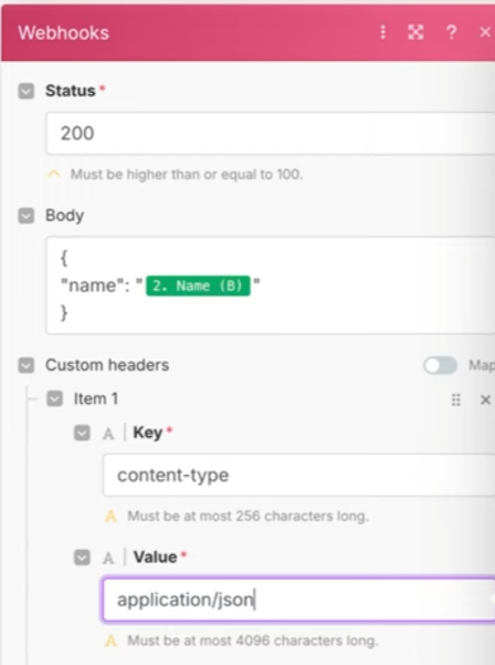

Please see also the screenshot of the Fonio instruction video about this inbound webhook response automation:
Can you please consider making this enhancement to the Action step: “Data Forwarder - Return Workflow Response to the Source”, so that we could also set status and custom headers.

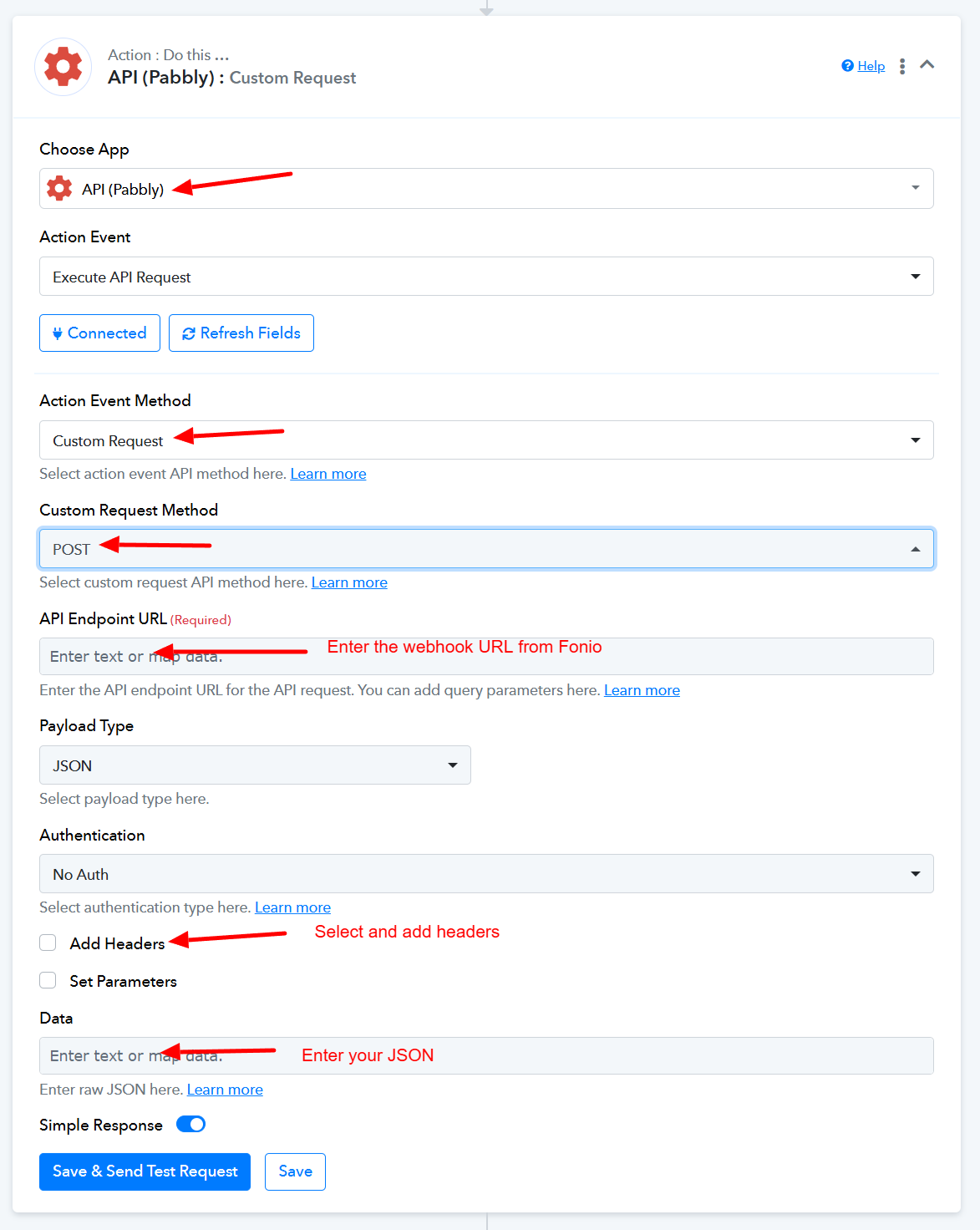

You won't be able to set header parameters in the 'Data Forwarder' action step. If the Fonio application has an inbound webhook, you can use the API by Pabbly action step to send data to that webhook, which will allow you to include headers as well.

That is why I am asking to you to forward my suggestion to add the functionality to set status and custom headers with the "Data Forwarder - Return Workflow Response to the Source” (like in Make or n8n), because to be honest I think it should have been there in the first place, because this small adjustment will make the Pabbly Connect plattform just more flexible and powerfull.
