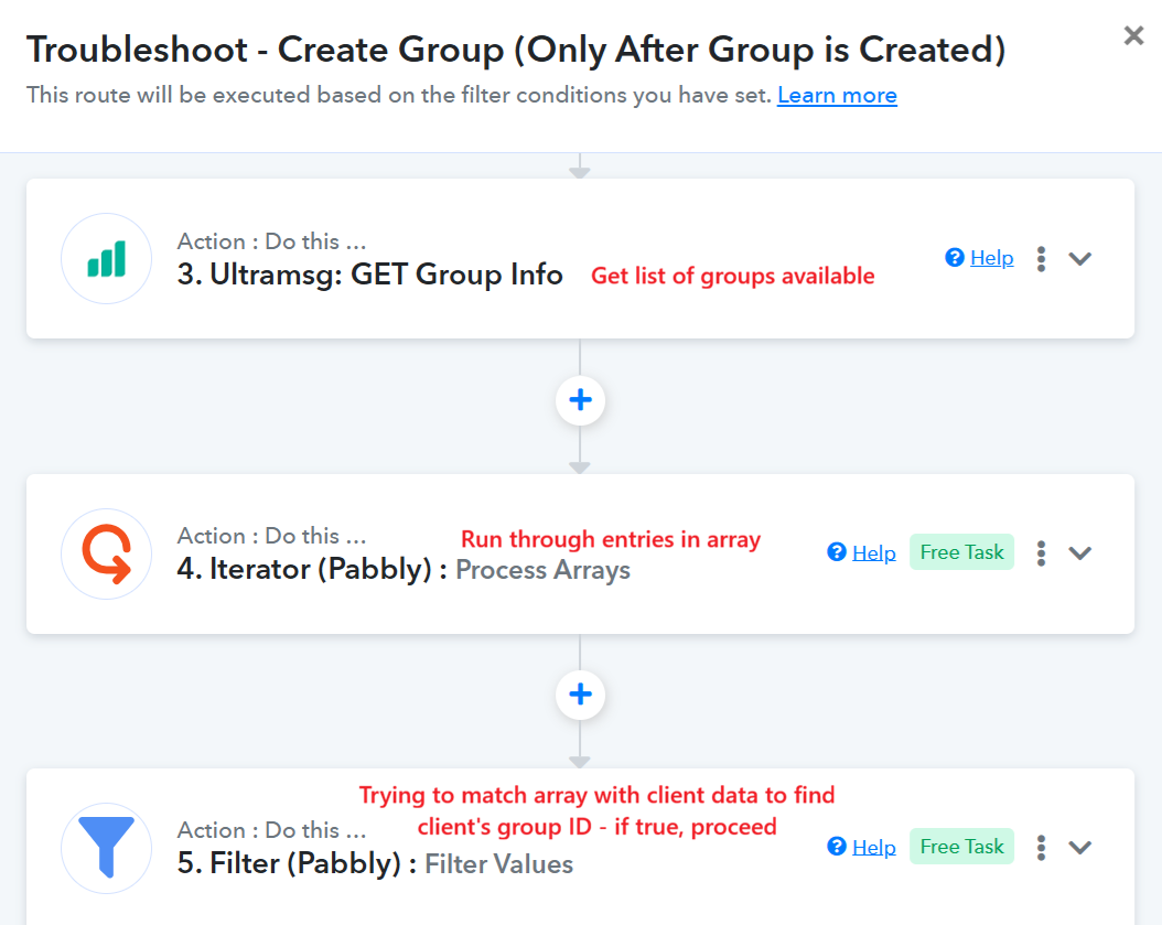

Thank you for getting back to me, Preeti.
Since there's a limitation for WhatsApp with group messaging - I'm using UltraMsg to retrieve the created group ID needed to send messages to a particular group.
However, UltraMsg doesn't seem to have a way for me to fetch only 1 group info without me knowing what the group ID is beforehand. So, I have to GET the entire group list, run through the iterator to see which group matches my client's details, then store that group ID for future messaging within the client's group.
My workflow to troubleshoot is the one labeled Troubleshoot - Create Group (Only After Group is Created).
My iterator at the moment does run, but when I check the logs, it doesn't do anything afterwards. My step for filter isn't shown in the log, so I'm unsure if it ran.
Also, your explanation is what I'm implementing, but backwards. I'm just trying to get the specific group ID from a long array (UltraMsg's response). I can't seem to use text formatter to trim off the array because Pabbly says the response is too long to parse.
Basically, I can't directly search for the group based on group ID because I have to first identify the group ID from a list.

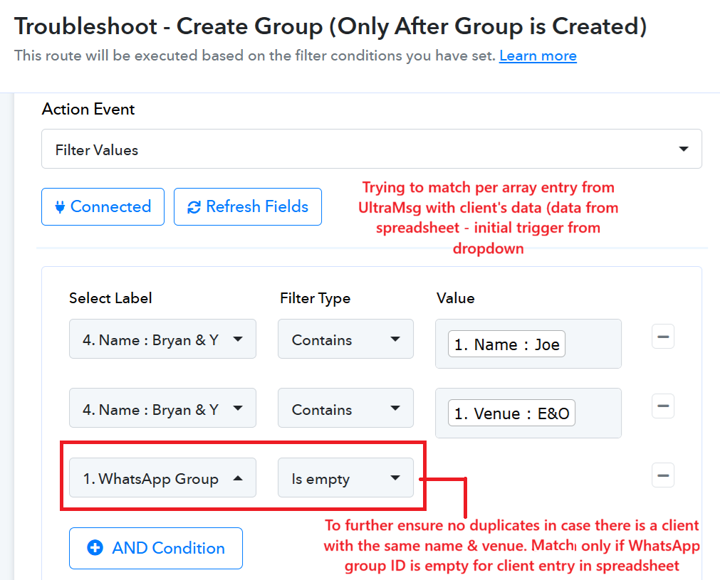

Don't mind step 2 in the workflow. Please ignore & refer to the images as attached in sequence.
Sample GET group response from UltraMsg (this has been trimmed & redacted for clarity, since the actual response is very long):
{"id":"[EMAIL][email hidden][/EMAIL]","name":"Zac & Joe | (date) | E&O","isReadOnly":false,"isGroup":true,"groupMetadata":{"description":"","edit_group_info":"all","send_messages":"all","owner":"[EMAIL][email hidden][/EMAIL]","creation":y,"participants":[{"id":"[EMAIL][email hidden][/EMAIL]","isAdmin":true,"isSuperAdmin":false},{"id":"[EMAIL][email hidden][/EMAIL]","isAdmin":true,"isSuperAdmin":true}]},"last_time":z,"archived":false,"pinned":false,"isMuted":false,"unread":0}
The data in orange is what I'm trying to get. The data in green are what I'm comparing with in my spreadsheet (image 3 below).
The explanation for my filter is as below:
If my filter step isn't clear, then perhaps my logic isn't correct?

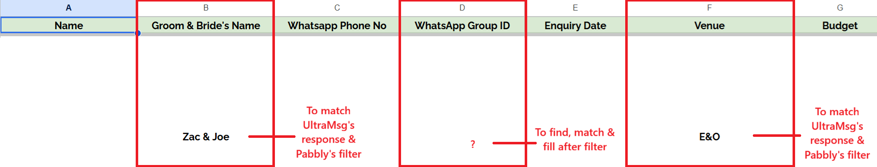

Below is a sample of my spreadsheet entry:
If my filter isn't correct - please let me know & guide me to correct it.
I haven't had success yet with this logic, so there isn't a sample video for me to share.
My original workflow is Create Group (Only After Group is Created). It works, but it is a hit & miss as the group created for the group ID identifier isn't always the newest group created (hence, messing up to matching process). It must be the first entry in the array (from UltraMsg's response) for this logic to work. It works about 80% of the time, so I'm trying to fix it.
This workflow is live, so please proceed with caution as it deals with real clients.

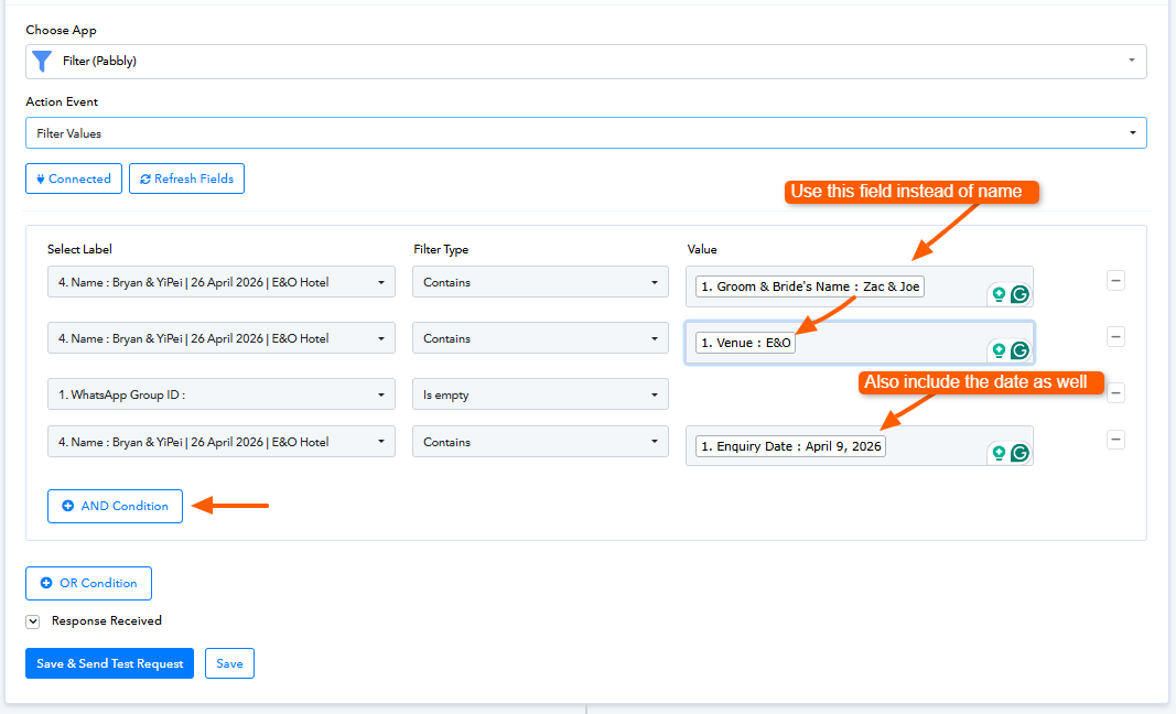

Hi @HelpMeLearn,
Thank you for sharing the detailed explanation and screenshots.
The issue appears to be with the filter configuration. Since the group name contains all values (Name, Venue, Date) in a single field, you should apply all conditions on the same field using AND logic:
  • Select Group Name (from Iterator) in each condition
  • Use Contains
  • Add separate conditions for Name, Venue, and Date
This ensures only the exact matching group passes through.
You can refer to your setup here:
Note: We have not made any changes to your workflow.
Please test this and let us know how it goes.
