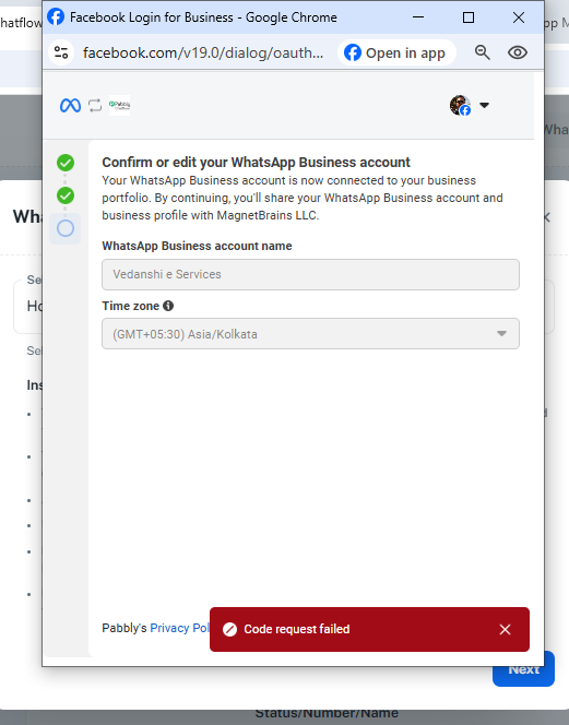

I am sharing the screencast video with you as requested.video link
In the video, you can see that template messages are working properly, but the flow is not triggering for my number +91-9425075719.
I would also like to inform you that I have another number which is not connected to WhatsApp Business App, and earlier the flow was working fine with it when I was on the free plan. But since I upgraded to the paid plan, the flow has stopped working.
Additionally, I have another number +91-9425475719 connected both with WhatsApp Business App and API, and the flow is working fine with this number.
Please guide me with the proper steps on what I should do to fix this issue. If possible, kindly share a detailed video tutorial so that I can follow along and resolve this myself.
I am really struggling with this problem, and your quick support will be highly appreciated.
The video you shared shows only a single page; it doesn’t display the steps you took.
At the 26-second mark of your video, you selected the 'Connect a WhatsApp SMB account' option. Instead, you need to select the 'Create a WhatsApp Business account' option, create a WhatsApp Business account, and then follow the steps provided in the video shared below:
youtube.com/watch?v=3nN12cCZaQc:158
Abhishek Verma — Reply ·
Hello @Abhishek Verma,
Please try completing the process after closing the error, or wait for a while and then attempt the connection process again. Kindly let us know the outcome so we can assist you further.
