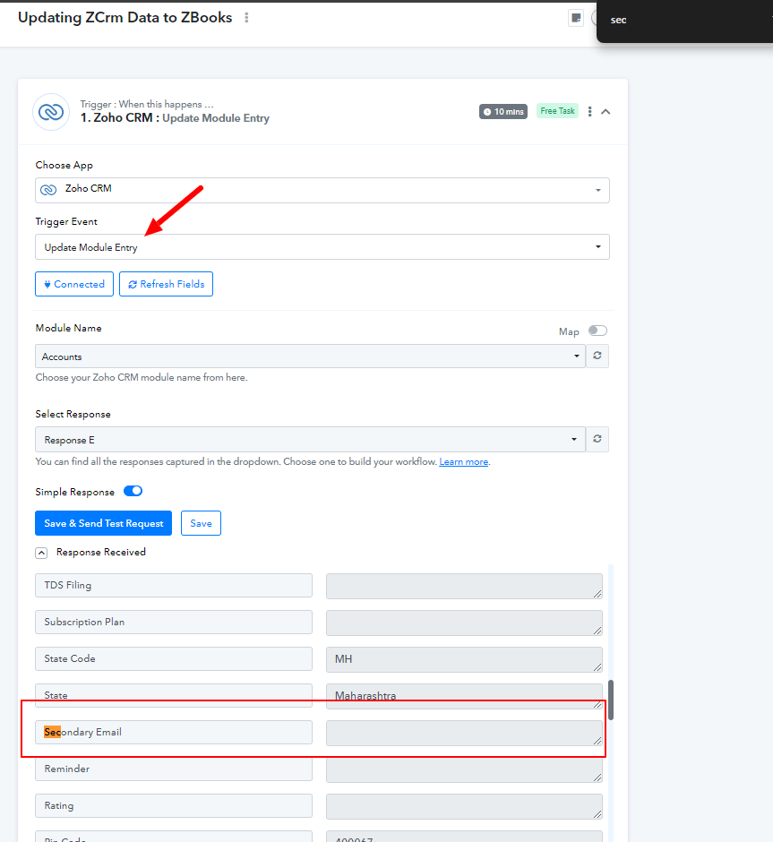

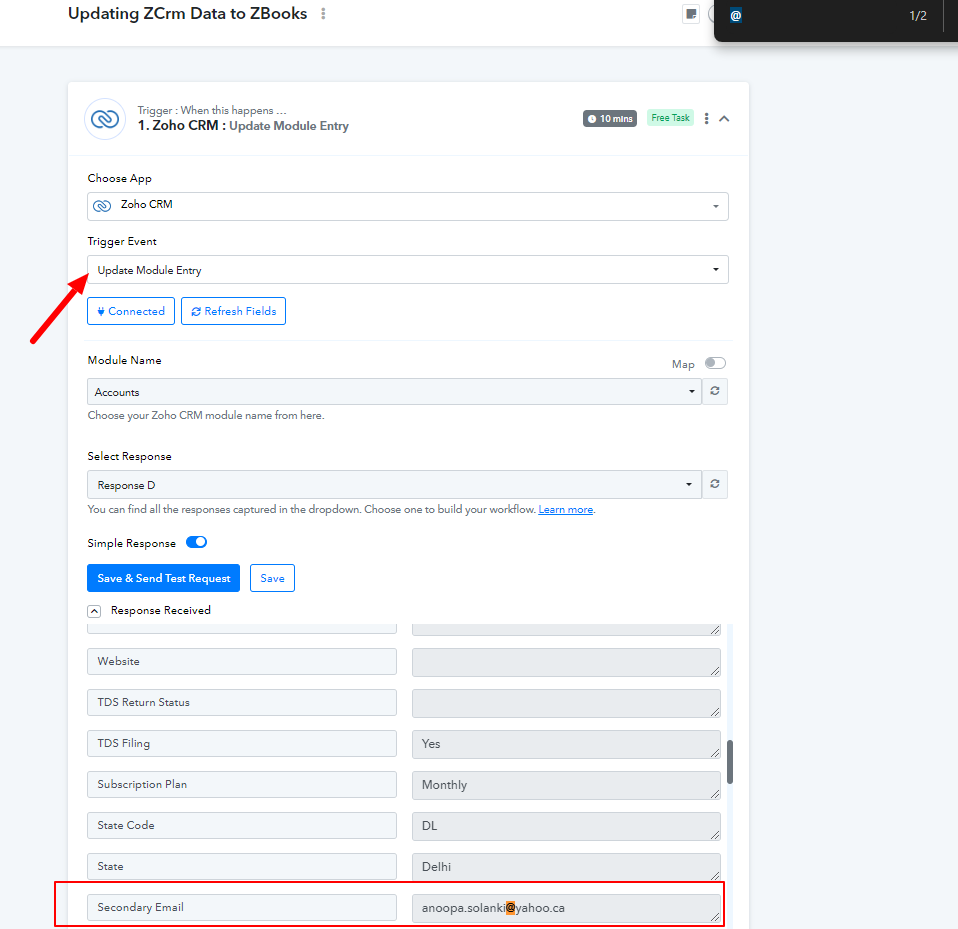

Upon reviewing the workflow, it appears that the issue is related to the trigger response. The Secondary Email field, which is mapped in the subsequent steps, sometimes contains an email address and sometimes does not. This inconsistency is causing errors because the required fields are not receiving the necessary data.
Please ensure that your workflow is set up in a way that the mapped fields receive data in all cases to avoid these errors.
