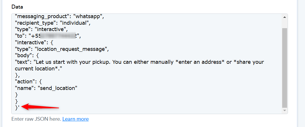

I need help to identify why Custom API Request (Beta) of Whatsapp Cloud API is returning the error message below:
(#100) The parameter messaging_product is required.
I need to send a message template of the "location_request_message" type, but I'm facing this difficulty.
That message template does not require Meta approval, so there is no way to send it in the conventional way, using "Send Template Message (Beta)".
For further instructions, check the Meta tutorial in the link below:
https://developers.facebook.com/docs/whatsapp/cloud-api/guides/send-messages/location-request-messages/
Workflow: (it is on the first route - option “Motorista não recusou") https://connect.pabbly.com/workflow/share/AUkENgNUUDNfFQFrVAsHIAwYAgYHXlU2UUhWRAYJVi5bAQZtBURdNw5CBCYDVFMyXxZUPlUKUDALHwcDUAYCcVBJBQdcX10nWxZTKAJbCzgBXwQsA2I#
Hi @Carlos Melo,
There was an unnecessary quotation mark at the end of your JSON. We removed it, and it seems to have fixed the issue.
