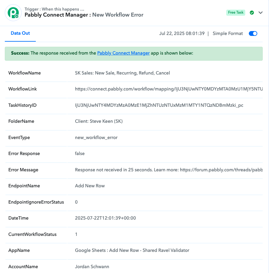

Hi team,
Thanks for your response. As requested, here are the details:
Task History ID: IjU3NjUwNTY4MDYzMzA0MzE1MjZhNTUzNTUxMzM1MTY1NTQzNDBmMzki_pc
Workflow Name: SK Sales: New Sale, Recurring, Refund, Cancel
Date/Time of Error: 2025-07-22T12:01:39+00:00
Affected Step: Google Sheets: Add New Row - Shared Ravel Validator
Error Message:
"Response not received in 25 seconds"
This error was captured by Pabbly Connect Manager, but when we checked the workflow's Task History from the main dashboard, we could not find this specific error logged there.
Could you please help clarify:
  1. Why this error was not recorded in the Task History, even though it's visible in Connect Manager?
  2. Does this indicate that the webhook was triggered correctly, but the Google Sheets step timed out?
  3. Is there anything we can do to prevent this issue, such as optimizing the Google Sheet or restructuring the step?
We have attached a screenshot from Pabbly Connect Manager showing the full details of the error. Please let us know if you need anything else to assist further.
Thank you

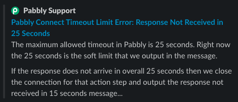

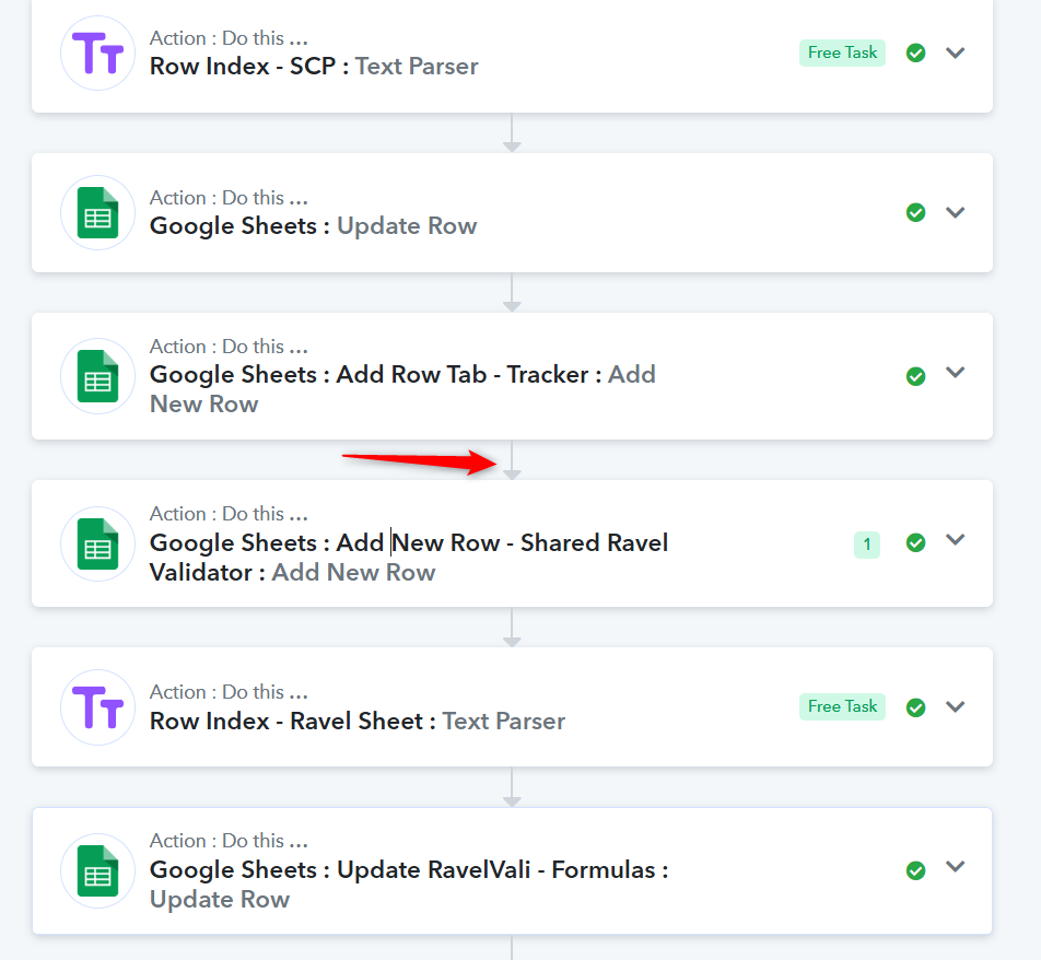

The issue occurs when an application takes more than 25 seconds to process a request and send a response back to Pabbly Connect. We suggest adding a Delay before the 'Add New Row' action step to see if that resolves the issue.

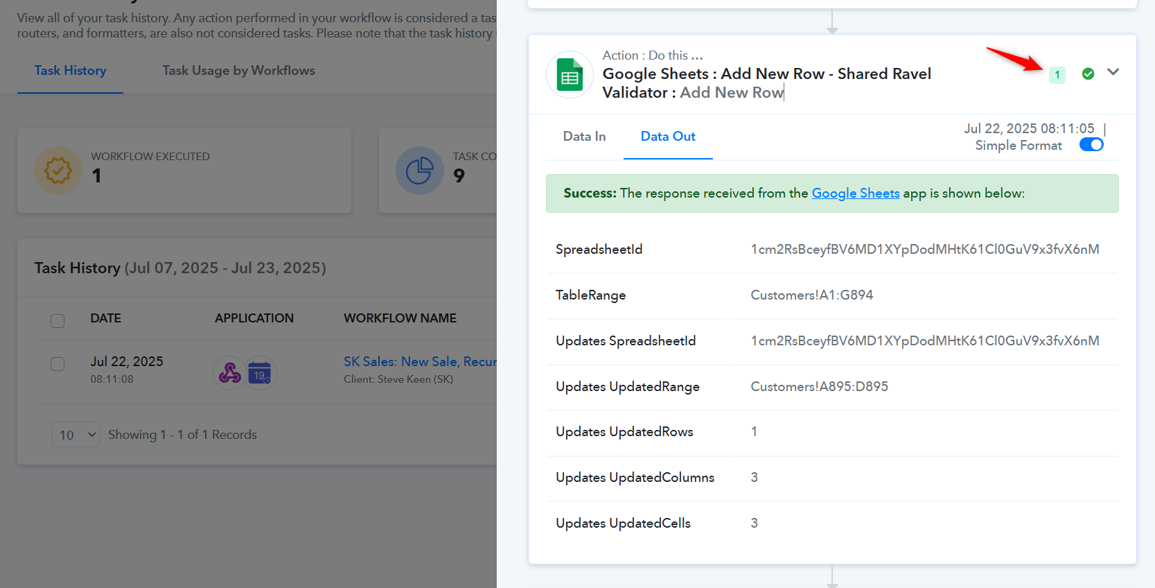

I see in Screenshots, you are pointing towards "1".
What does that mean?
and is any chance of getting same error even after using delay before "add row"?
It means the number of times the workflow was executed before you stopped encountering the error.
You can still get the same error even with the Delay step, but it should help mitigate the issue. As mentioned earlier, the issue occurs when Google Sheets fails to process a request and takes longer than 25 seconds to send a response back to Pabbly Connect. Since the source application is unable to respond within the required timeframe, we can only suggest workarounds to minimize the chances of this error.
