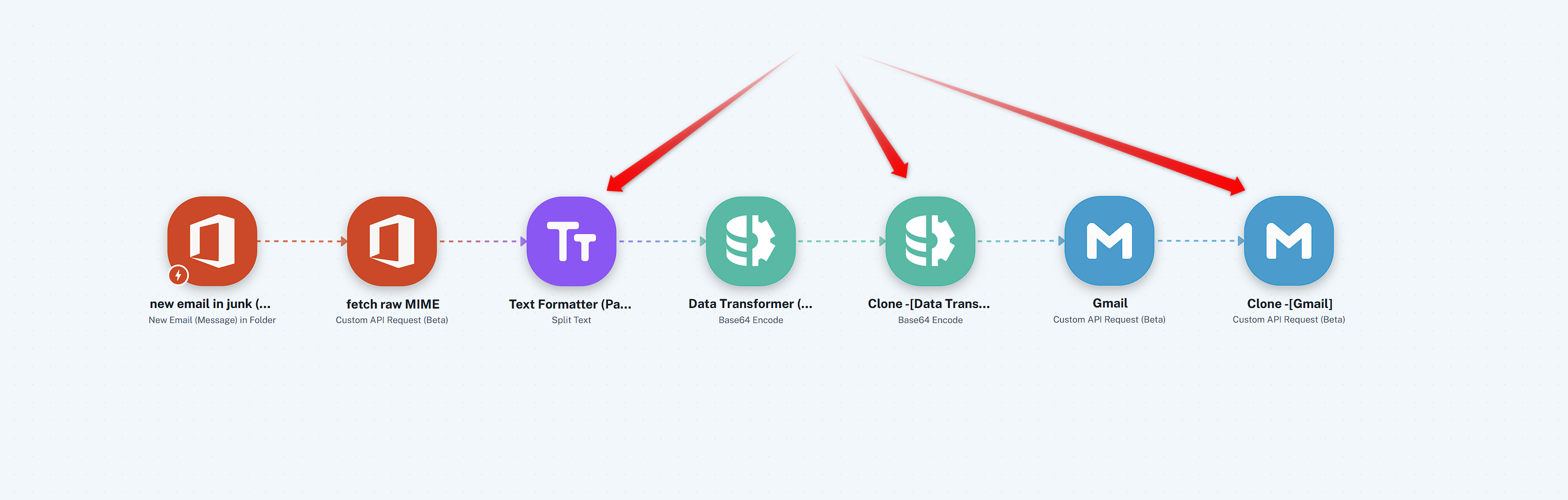

Thank you for sharing the workflow URL, we checked the workflow and the task history. The action is failing because there are multiple From Headers in the MIME message before encoding. Gmail allows only single form Header. Unfortunately, the response is received from Outlook only, which we tried to fix by adding 3 actions in your worklfow and without hampering the original steps. Here we tried to split the MIME version to remove the multiple From Header. If these 3 actions execute in your test then its possible else due to Gmail's policy it won't be possible.

I see you've added a new text formatter step.
So, I've ran this new workflow, and again as before: manual test worked fine, but live test failed in the Gmail step with the 400 error "Expected a single 'From' header".
Apparently the text formatter didn't provide a solution...
