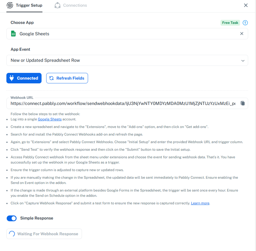

After i submit send test or submit, it says "waiting for webhook response" for 1 hour and its not connecting

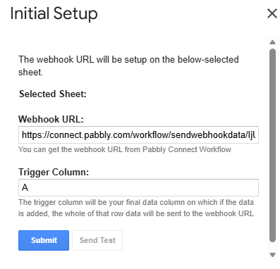

Hello @kellymann,
Could you please confirm whether column A contains both the header and the data in the rows? Additionally, have you tried clicking the "Send test" button, and if so, did you receive any errors?
If you could share a screencast of the test, it would be very helpful for us to understand the problem better.
kellymann — Reply ·
yes column A contains both the header and data in the rows. Also when i click sent test, i dont receive any errors, nothing happens

as you can see here, the send test button is unclickable after i click it and it shows no errors
kellymann — Reply ·
this keeps on turning around

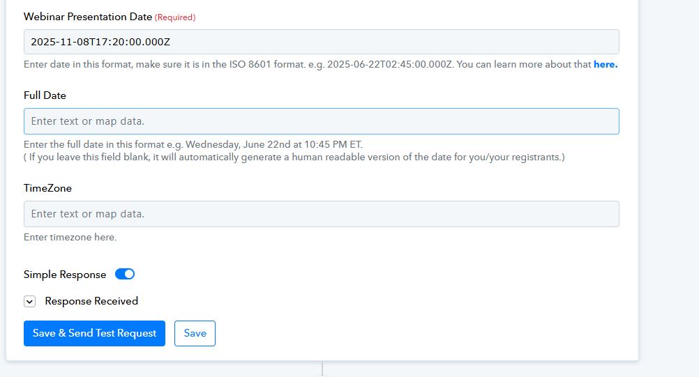

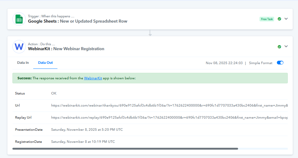

Ok thanks, I think i figured out the google sheets problem. But now i am having a problem when i try to set it up on webinarkit. Here is what im looking to do:
Once a new row is updated in my google sheets, it registers it as a new webinar registration on webinarkit. However, nothing is happening. For example:

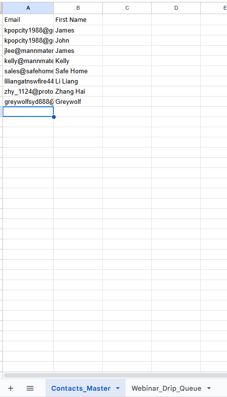

This is my contacts master list, which is then dripped to the next sheet successfully. However, no registration in webinarkit happens.

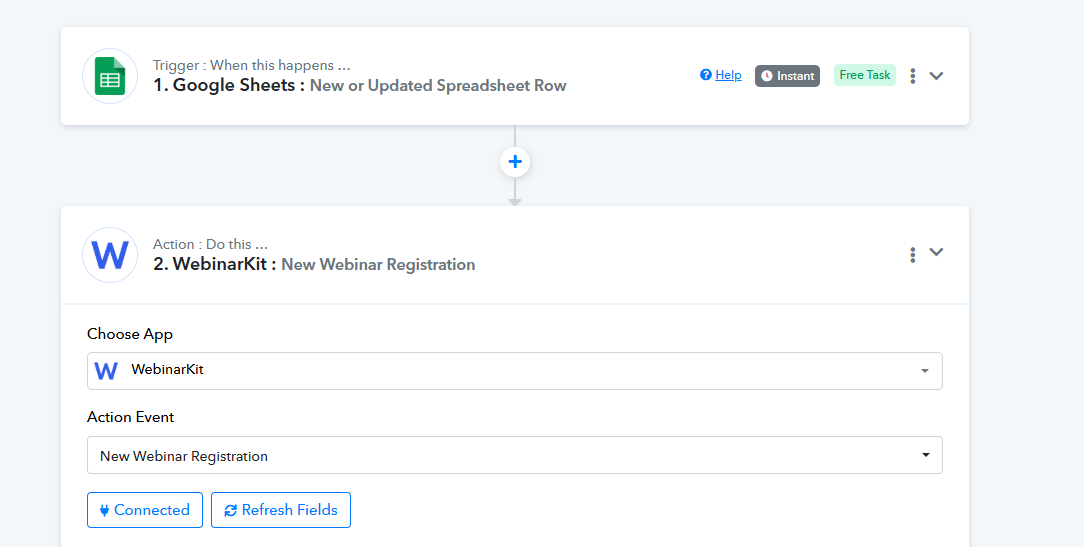

Hi @kellymann ,
We’ve reviewed your workflow, and the “WebinarKit: New Webinar Registration” step appears to be working correctly. The response being received from WebinarKit indicates a successful registration, confirming that the integration is functioning as expected on Pabbly’s end.
If the registration is still not showing up inside your WebinarKit dashboard, please verify the following on WebinarKit’s side:
  • You’re checking under the correct webinar ID (690e9125afcf3c4db6b1f36a).
  • The email used for testing matches the one in the registration response.
  • No manual moderation or approval setting is delaying registrations.
Once you confirm these details, please let us know if the issue persists — we’ll be happy to look deeper.
kellymann — Reply ·
Yes correct:
- I only have one webinar ID in webinarkit
- Yes
- No manual moderation or approval needed.

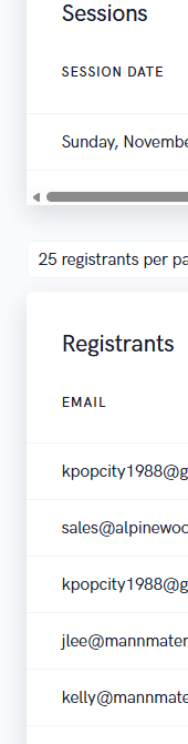

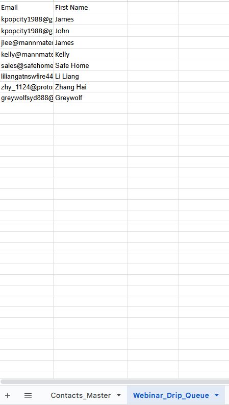

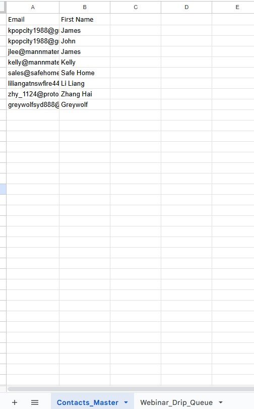

Here are the masterlist and then the dripped data onto the second sheet (and that is successful)
However, there have only been 5 registrants and it all were from when i manually pressed "testing"
So basically not a single person is being registered automatically, only when i click "save and send test request" in pabbly

Perhaps the problem is the webinar presentation date that is on the 8th November and not triggering? i tried to not put any date in Pabbly but it doesnt let me

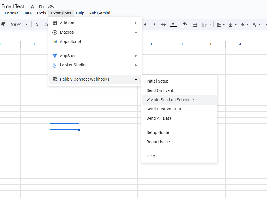

Hi @kellymann,
Thank you for the clarification.
It seems that your workflow is not triggering automatically. Upon checking the Task History section of your workflow, we can see that it last triggered on November 8, 2025.
Could you please confirm how the data is being populated in your Google Sheet?
  • If the data is being added manually, please ensure you have selected the “Send on Event” option while configuring the Google Sheets trigger webhook.
  • If the data is being added by an external application, then you’ll need to set the trigger to “Auto Send on Schedule”, as this trigger type uses polling instead of instant events.
Once you verify and adjust this setting, your workflow should start triggering automatically again.
kellymann — Reply ·

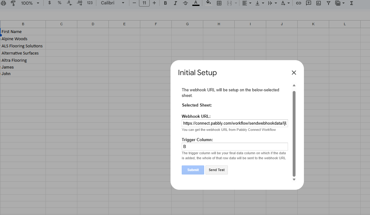

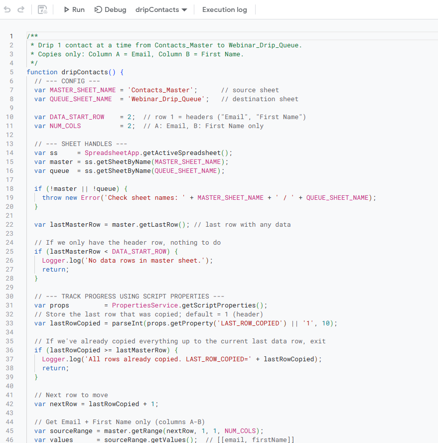

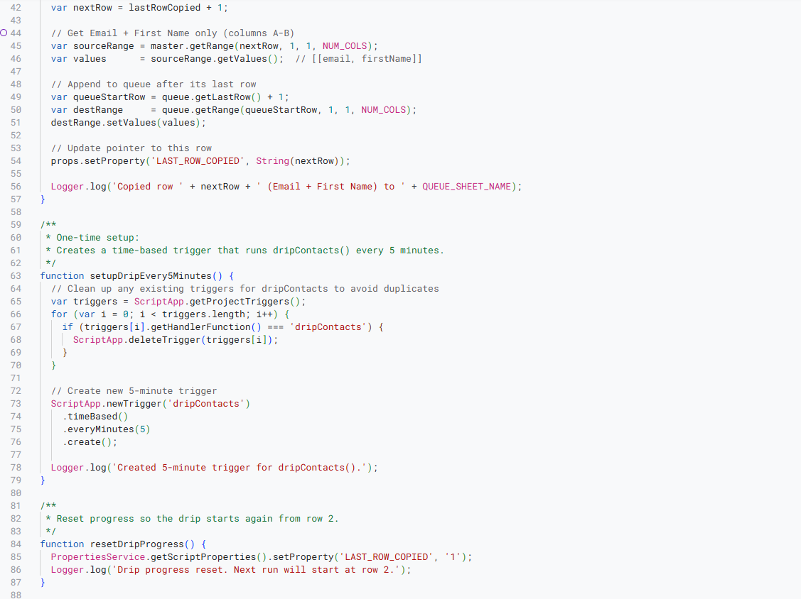

It is added via this script in Google Sheets:
kellymann — Reply ·
The data from one sheet is being drip-fed to another sheet via this script, so im not sure if this is "manually" or "external application"
Hrishabh Tiwari — Reply ·
Hi @kellymann,
Thank you for clarifying. Since your data is being added via a Google Sheets script, it won’t trigger the webhook instantly. In this case, please change your Google Sheets trigger in Pabbly Connect to “Auto Send on Schedule”.
This trigger uses polling to check the sheet at regular intervals, so your workflow will pick up the new rows added by the script automatically.
Once you switch to this option, your workflow should start triggering as expected.
kellymann — Reply ·
