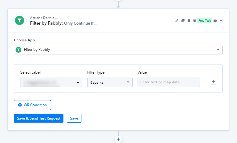

If in the response you are getting a status that can say that the Video is published and fulfills all the conditions then you can use the Filter action step accordingly.

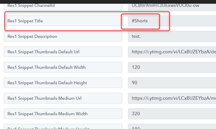

For shorts video, you find "#Shorts" in the Youtube trigger respone as shown below -

Hi @Pabbly,
i understand your solution, but i am using streamladder to create and post videos.
I literally never use "#shorts" and dont have that in any of my shorts, still they are shorts.
Before i was at another platform, one could filter for "duration like 'T00%'".
so this would mean "every video under 1 minute".
Can you do this?
That would be awesome, since you also can read the length of the video, we could use that for filtering.
