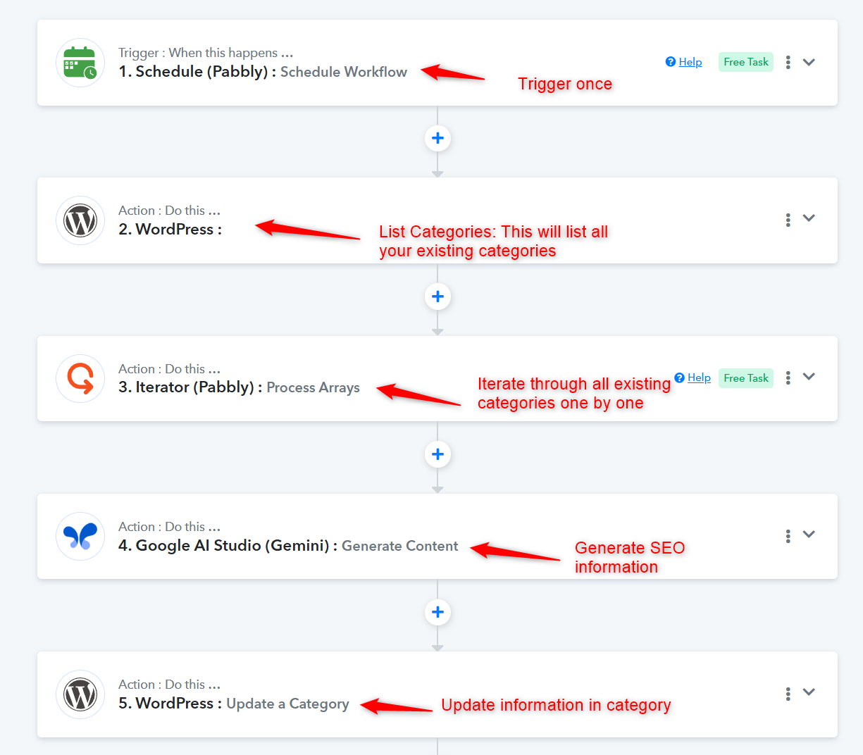

Workflow 1: To add information to existing categories
  1. The Scheduler will trigger the workflow once.
  2. The WordPress: List Categories action step will list all the existing categories in your WordPress account. This action step is currently not available in Pabbly Connect.
  3. The Iterator will process each category one by one.
  4. The Google Gemini action step will generate SEO information.
  5. The WordPress: Update Category action step will update the information in each category one at a time.
Please submit your request here for the addition of the 'List Categories' action step to the WordPress action application in Pabbly Connect. It is essential for your use case.

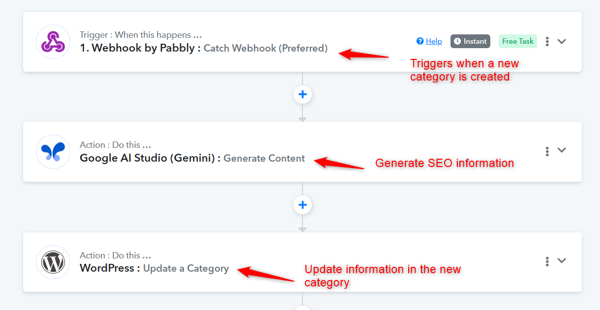

Workflow 2: Triggers when a new category is created
  1. Webhook by Pabbly will trigger the workflow upon the creation of a new category.
  2. The Google Gemini action step will generate SEO information.
  3. The WordPress: Update Category action step will update the information in the new category.
Above, we have shown how your workflow would be structured for adding information to new categories. However, there is a limitation here. WordPress does not appear to have any webhook event that triggers specifically when a new category is created.
We suggest getting in touch with WordPress support to check whether they have an alternative method that can trigger a webhook when a new category is created. If they do not provide such an option, then this part of the use case may not be possible.
