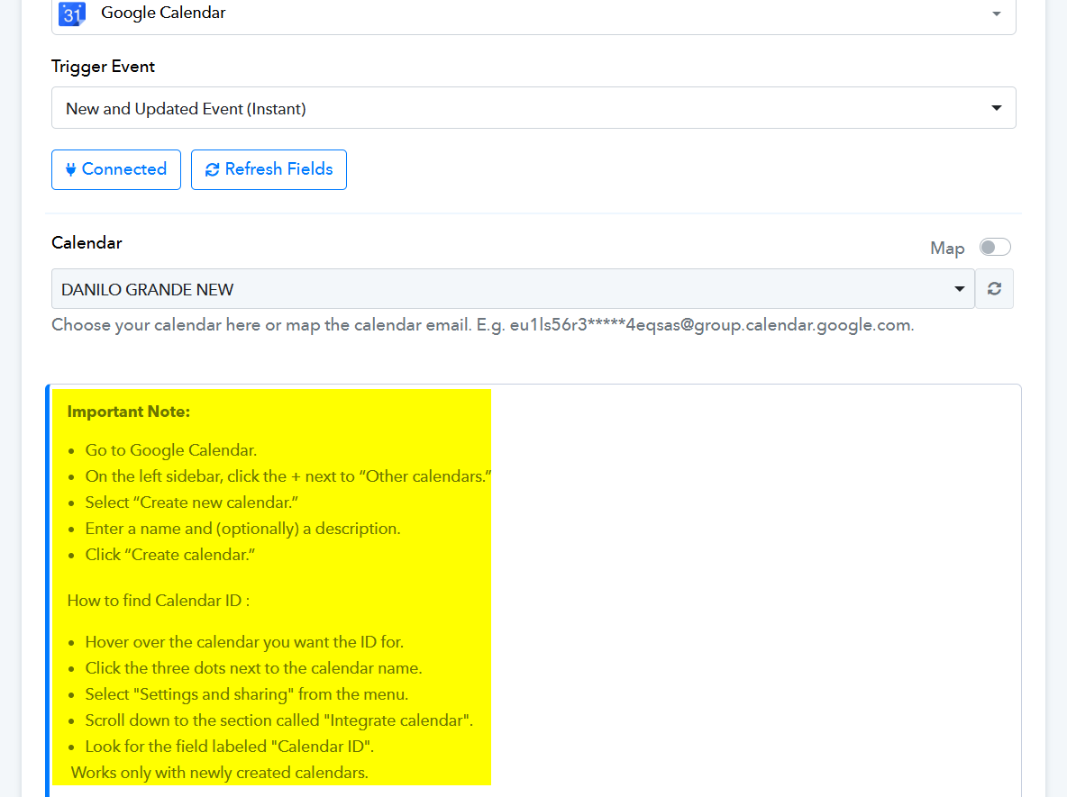

Hi @villaflaviana,
Google Calendar: New and Updated Event (Instant) trigger step requires you to create a new calendar while setting up the trigger. It cannot be set with an existing calendar; otherwise, you may encounter the issue mentioned above.
Please create a new calendar as per the steps mentioned in the Important Note, and then try setting up the Google Calendar: New and Updated Event (Instant) trigger step.

Hi @villaflaviana,

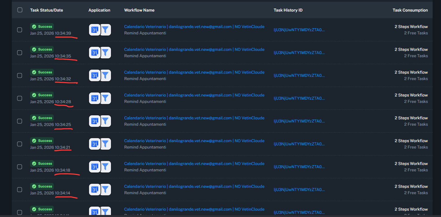

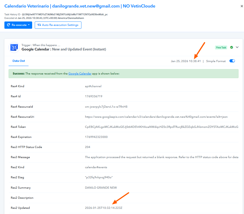

Hello @villaflaviana,
Thank you for sharing the workflow details with us.
Upon checking the task history from our end, the workflow appears to be triggering and executing correctly. To investigate this further, we have checked the specific Task History ID you have shared but it seems that it was updated on the date when it triggered the workflow, refer to the attached image for a better understanding.
You still don't understand the problem...the new ones I took today as a test didn't take them...but n8n did.

I’m really sorry that this experience has been frustrating for you, and I genuinely understand why you feel this way. Please know that you are important to us, and we do take every issue seriously, whether it affects one user or many. Your concern is not being treated as a “general” case and dismissed—we truly want to help you get this resolved.
We are absolutely ready to look into this further and work with you to fix it. To do that effectively, we’ll need a bit more clarity on the new events you tested today that did not trigger in Pabbly, but did trigger in n8n.
Could you please share:
  • The exact event details (date/time, calendar/event name or ID)
  • The workflow trigger being used
  • Any task history reference (if available), or a screenshot/log showing the event in n8n
With this information, we can directly compare the trigger behavior and identify what’s preventing the workflow from firing, and then guide you on how to make the trigger more reliable.
