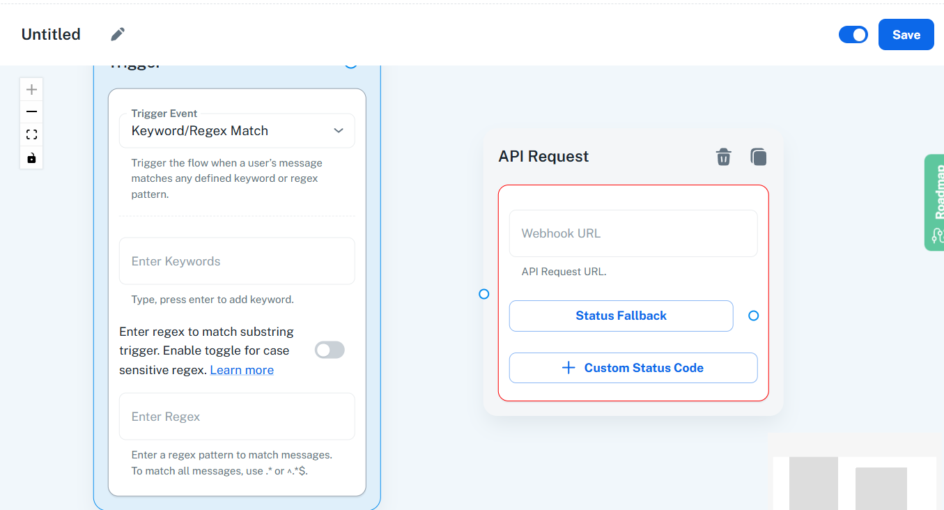

Thanks, Preeti. I'll try designing this, but as I am completely new to this, I might need your assistance.
Please watch the video shared below to understand how you can send data from Pabbly Chatflow to Pabbly Connect. In Pabbly Chatflow, you just need to create a flow with two steps: the flow should trigger on a specific Keyword/Regex Match, and then use the API Request step to send the data to Pabbly Connect.
youtube.com/watch?v=TMu35XAOK0A:558
Once you have done so, do let us know and we will guide you through the next steps.
