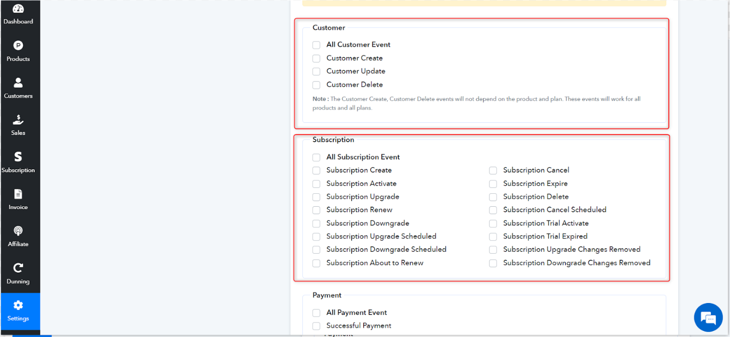

Additionally, to retrieve customer details such as email and subscription-related information, like failed payments or cancelled subscriptions, you can use the webhook option available in Pabbly Subscription Billing. There are multiple webhook triggers available, allowing you to use these triggers to obtain customer, subscription, or payment details. For a more details, please refer to the screenshot below.
I hope this addresses your query. If you have any further concerns or questions, please do not hesitate to contact us again.
