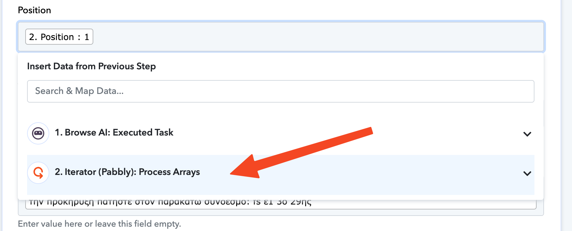

Then I send them to Add Row or Multiple Rows? Cause I used the Iterator Array on Google Sheets Add Row but only one got into GSheet.
see attached:
Hello @limitcracker,
In the workflow builder, when using the Iterator, it returns only the first object as a sample response, which you might have mapped further and added to Google Sheets. However, when the workflow runs in automation, the Iterator processes each object in the array individually—meaning it will execute all subsequent actions for every object in the array, as intended.

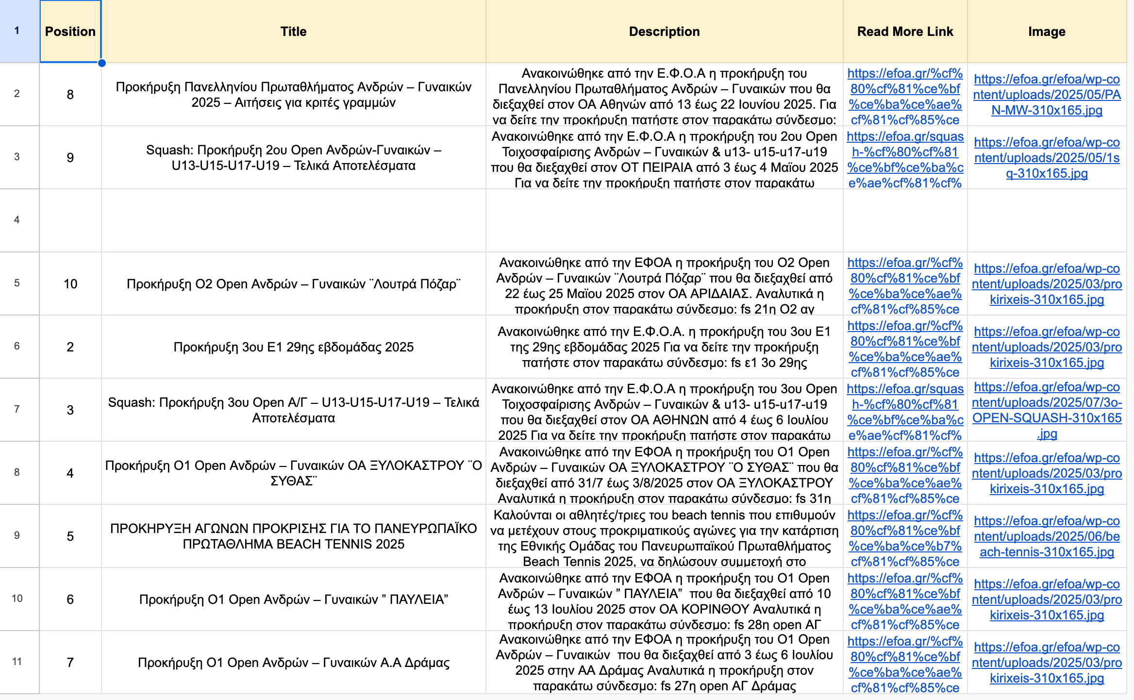

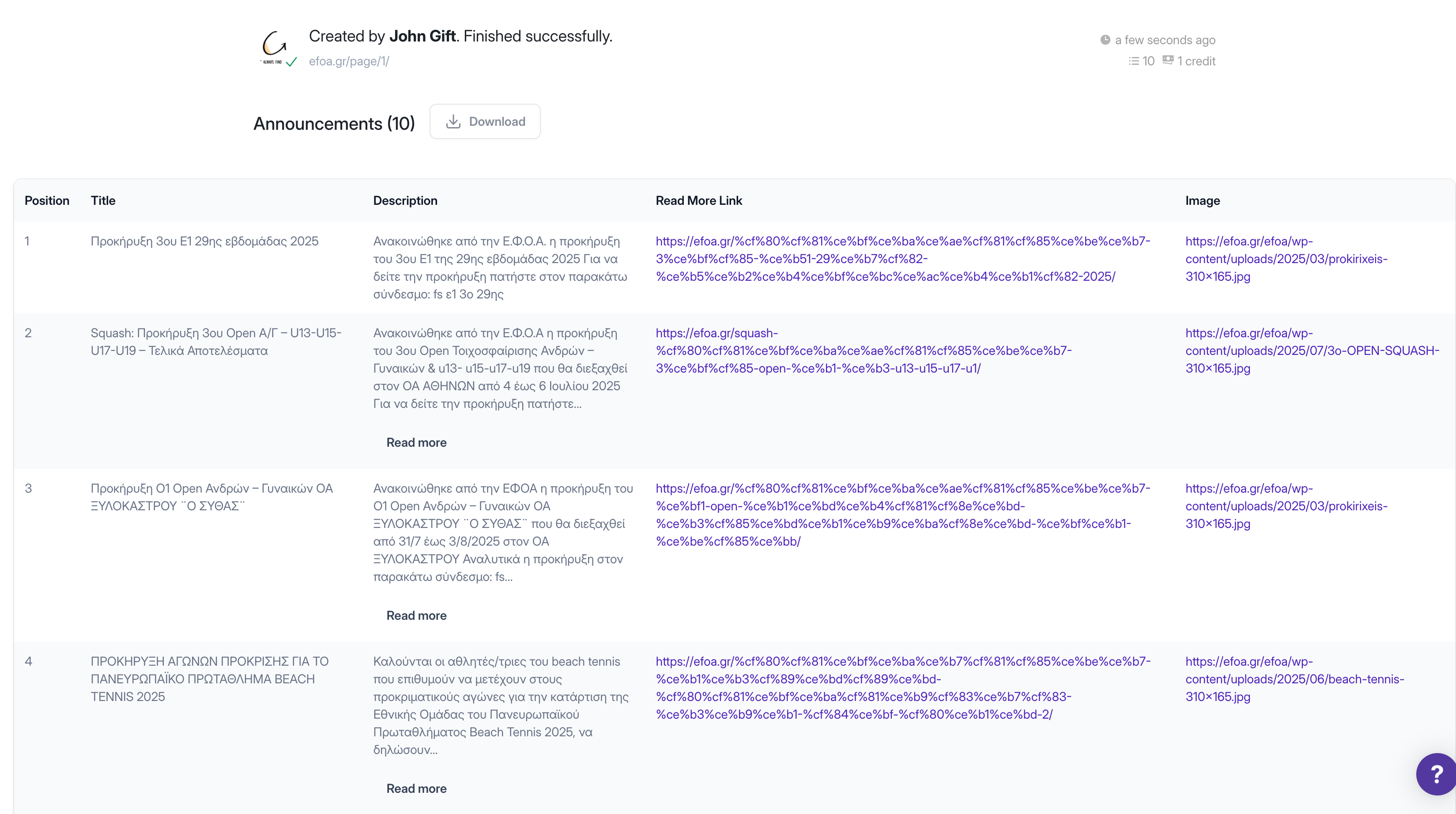

Hi, yeah it worked.

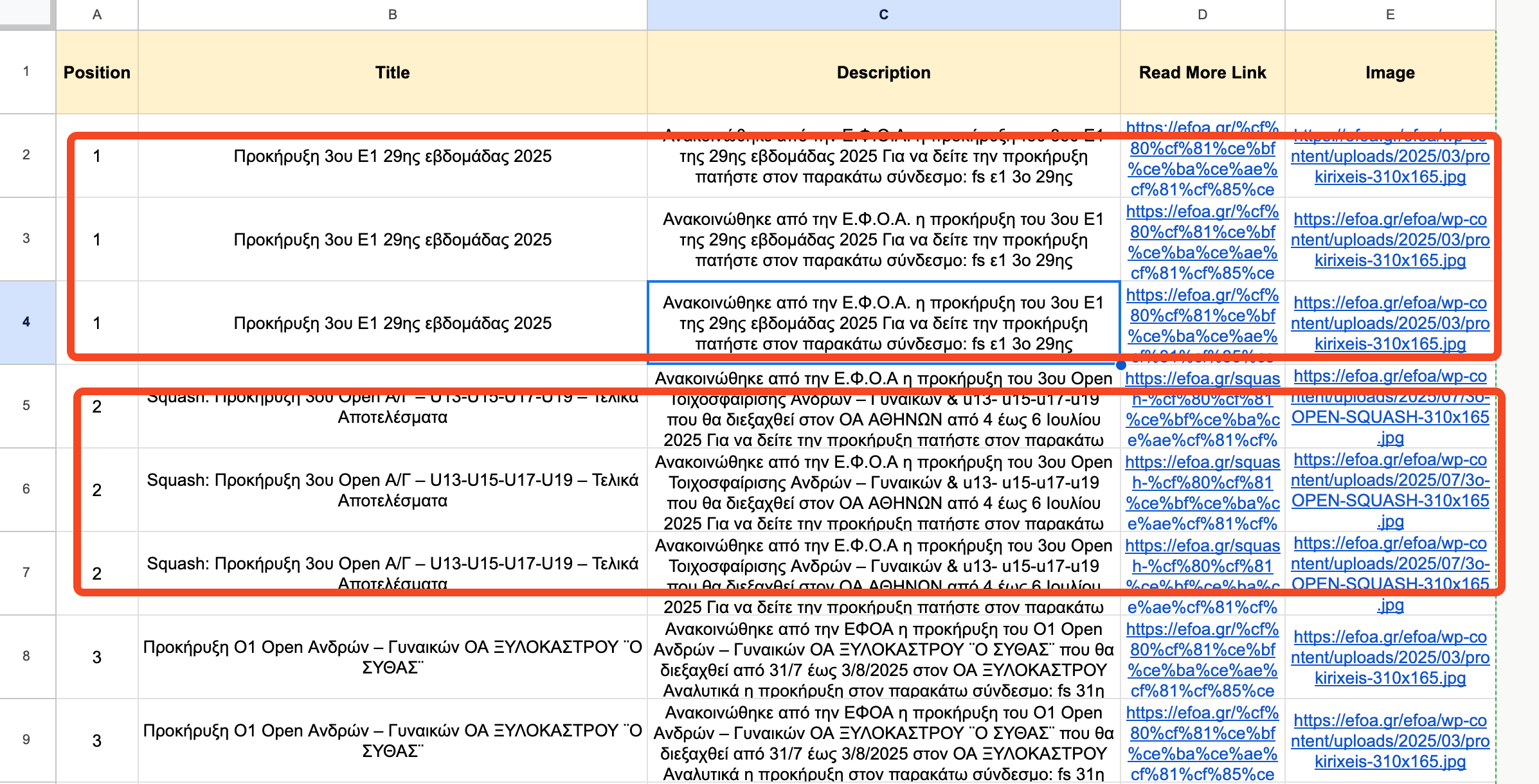

One last thing is that I get 3 times the same results although Browse.ai gives 10 unique results (see attached):
Thanks for bringing this to our attention.
It appears that the workflow is being triggered multiple times by Browse.ai, which is likely causing the duplicate entries. This usually happens when the "Save & Send Test Request" button is clicked multiple times during setup.

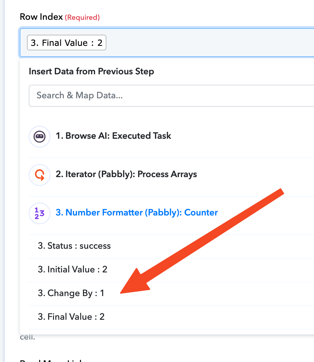

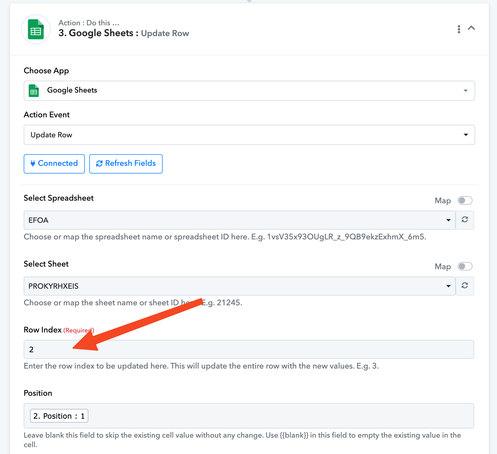

If I want to update 2nd to 11th rows with the same fetched results what I put into the Row Index? (see attached).
Could you please share the workflow URL so we can better suggest?

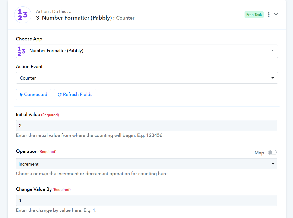

Hi, it does not work. Update row changes 10 times the same row (2nd row). Why?
I then used Change by but had same result:
It does not hop rows.

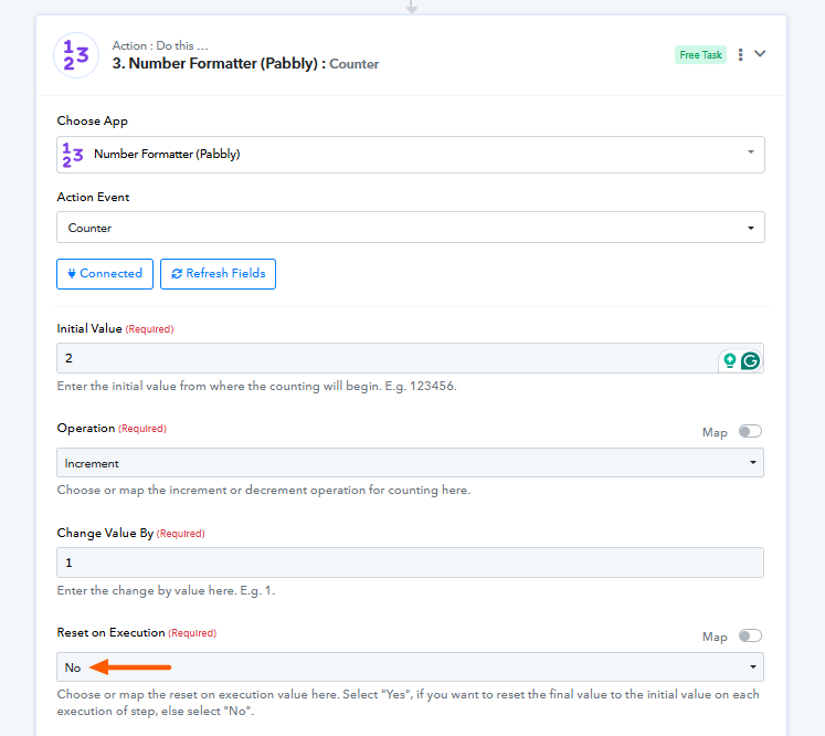

We wanted to inform you that the issue was occurring because the “Reset on Execution” option under the Counter action was set to YES, which caused the value to reset to the initial value on every execution.
We have now updated this setting to NO, so it should work as expected going forward.
Please run a test and let us know how it goes.

Great, it worked almost perfect.
One last issue. Is shows the results in shuffled order.
Does this has to do with Browse.ai (maybe async threads) or with Pabbly?

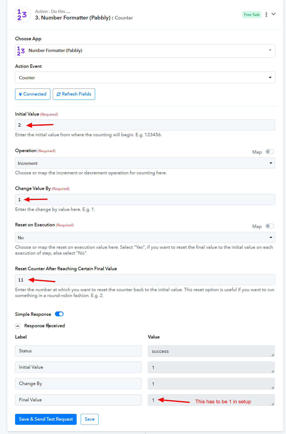

Yes now it worked perfect! Thanks! Solved!
What was the fix?
Yes now it worked perfect! Thanks! Solved!What was the fix?
The use case you are trying to achieve is very sensitive to the Counter step — even minor changes can disrupt it. When we click on 'Save & Send Test Request', the Final Value changes, and during automation, it starts updating from that row. For example, if it shows as 4 in the workflow setup, the first row that will be updated during automation will be 5, then 6, and so on. So, you need to make sure that the Final Value is set to 1, so it starts updating from row 2 during automation. We just made that minor change, and it worked.
