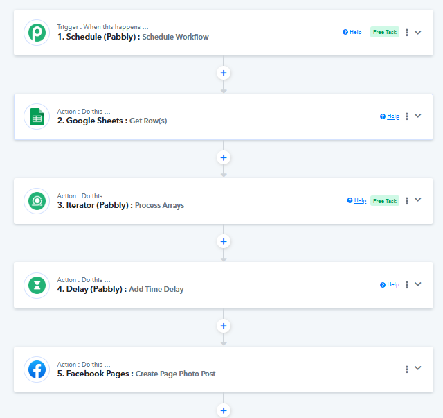

To set up this workflow, please follow the steps below:
  1. Set up the trigger as "Schedule by Pabbly" to run the workflow at the required time.
  2. Add the "Google Sheets: Get Rows" action to retrieve rows from Google Sheets in advanced format. Turn off the Simple Response option and capture the response.
  3. Add an Iterator and map the array from Step 2 to process each row individually.
  4. Add a Delay of 1 hour.
  5. Create a Post on Facebook using the retrieved data.
This setup will help you access the shareable link from Google Sheets one at a time.
Hello @sonuku,
Upon reviewing your workflow, it appears to be set up correctly and should help you achieve your use case.
Since an Iterator is being used, the workflow will process each row in Google Sheets individually. To ensure smooth execution, a delay of one hour has been added between each row's processing.

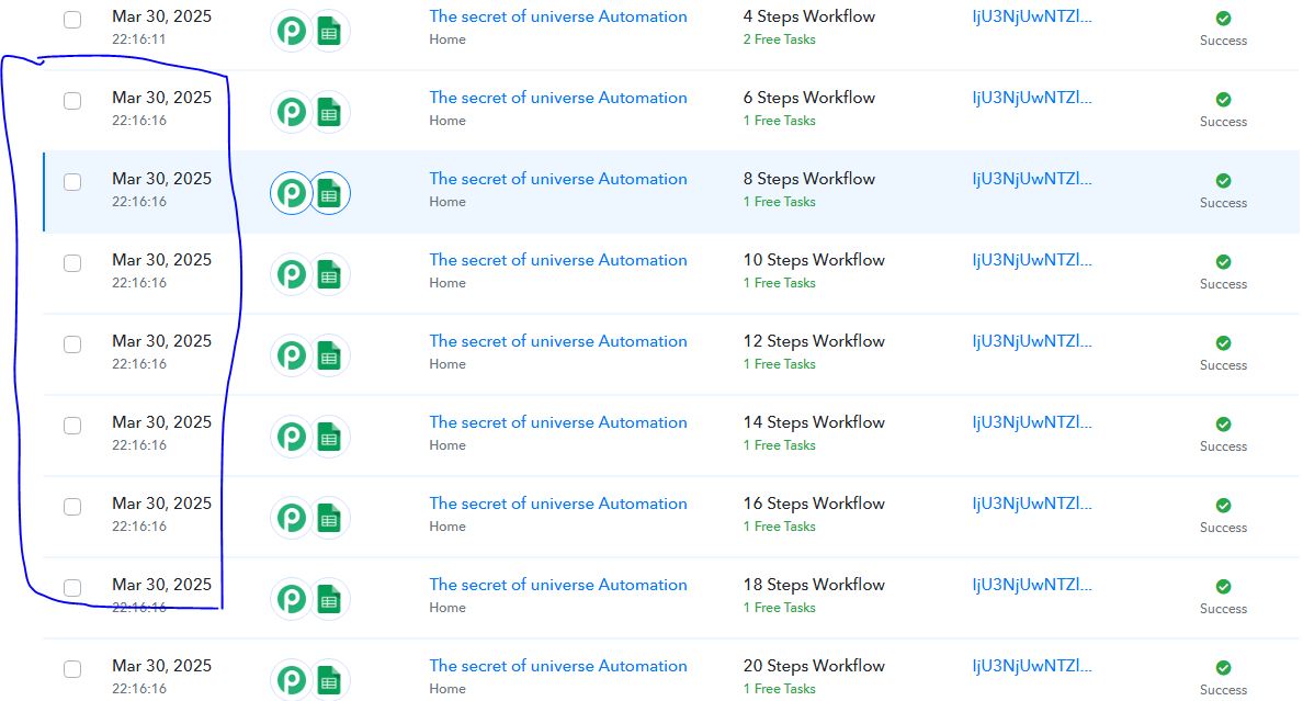

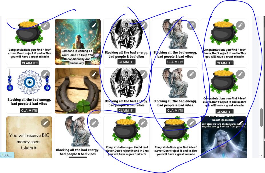

It is not functioning correctly.
  • On the first trigger, it uploads one image to Facebook.
  • On the second trigger, it uploads two images to Facebook.
  • On the third trigger, it uploads three images to Facebook.
For example, when it triggers for the third time, it takes images from the first, second, and third rows and uploads them together.

See the task history , see the timing all task executing on the same time .
see the all images repeating , I cannot share the link. these pages are blocked in India.

As per the task history, the delay between the posts appears to be around one hour. However, to further investigate and determine if the delay is exceeding the expected time, could you please share the following:
  • Any unique identifiers (such as post IDs or timestamps) that we can use to verify the delay
  • Screenshots showing the delay
  • File URLs or any relevant logs that can help us review the issue more effectively
Once we have this information, we’ll be able to look into the matter in more detail and assist you further.

I have set this workflow with 3 pages and with same google sheet. when these images which is shown in link post every pages has 4 hours gap posting , after this it works fine . I means In this gap these are some images in google sheet what they are not being posted . I have checked all these images which is missing to post , they are public and have checked in incognito mode also.

Current Workflow setup :
Suggested workflow:
