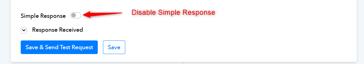

Please check out the video shared below; it may help you receive the response in a structured format. Make sure to disable 'Simple Response', then capture the data.
youtube.com/watch?v=kkE42z6wC1Y

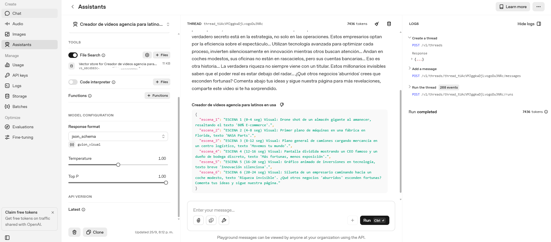

Hello Pabbly Connect community! ?
I'm setting up a workflow using the ChatGPT (Advanced) module to generate a visual script in JSON format, which I then need to process scene by scene using the Iterator module.
I previously received an outdated video guide for the OpenAI/ChatGPT setup, and after asking for help with no response, I tried to adapt the code myself.
1. ChatGPT (Advanced) Setup and Response
I successfully configured ChatGPT to enforce a strict output structure using the response_format with json_schema.
The response from ChatGPT is a perfect JSON object containing an array named escenas:
JSON
Choices: [{"index":0,"message":{"role":"assistant","content":"{\"escenas\":[\"ESCENA 1 (0-4 seg) Visual: A clock alarm ringing in the morning, with a ray of sunshine entering through the window.\",\"ESCENA 2 (4-8 seg) Visual: A tech leader sitting at his desk, writing in a notebook with a smile.\",\"ESCENA 3 (8-12 seg) Visual: Graphs on a screen showing a 20% increase in productivity, with happy employees working.\",\"ESCENA 4 (12-16 seg) Visual: A CEO meditating on a factory rooftop as the sun rises, surrounded by tranquility.\",\"ESCENA 5 (16-20 seg) Visual: An image of a scale showing clear decisions and money, symbolizing the millions saved.\",\"ESCENA 6 (20-24 seg) Visual: A logistics entrepreneur reviewing a list of daily goals, with a relaxed and smiling team around him.\"]}","refusal":null,"annotations":[]},"logprobs":null,"finish_reason":"stop"}]
2. The Problem with the Iterator Module
When I pass the response to the Iterator module, it fails to "drill down" into the JSON structure. Instead of iterating through the items in the escenas array, it treats the entire JSON object as a single item in an array:
Iterator Input (Process Arrays):
index 0: {"escenas":["ESCENA 1 (0-4 seg) Visual: A clock alarm ringing in the morning, with a ray of sunshine entering through the window.","ESCENA 2 (4-8 seg) Visual: A tech leader sitting at his desk, writing in a notebook with a smile.","ESCENA 3 (8-12 seg) Visual: Graphs on a screen showing a 20% increase in productivity, with happy employees working.","ESCENA 4 (12-16 seg) Visual: A CEO meditating on a factory rooftop as the sun rises, surrounded by tranquility.","ESCENA 5 (16-20 seg) Visual: An image of a scale showing clear decisions and money, symbolizing the millions saved.","ESCENA 6 (20-24 seg) Visual: A logistics entrepreneur reviewing a list of daily goals, with a relaxed and smiling team around him."]}
Because of this, I cannot map the individual scenes in the next action step of my workflow.
? My Question / Required Solution
How can I properly configure the Iterator Module to access and iterate over the escenas array within the JSON output from ChatGPT?
I suspect I need to use the escenas key path when mapping the Array field in the Iterator, but I can't seem to get the syntax right in Pabbly Connect, or perhaps I need an intermediate step like the Data Transformer to extract the array first.
Any guidance on the exact mapping syntax or the best way to handle this JSON parsing/extraction would be greatly appreciated! Thank you for your help!
