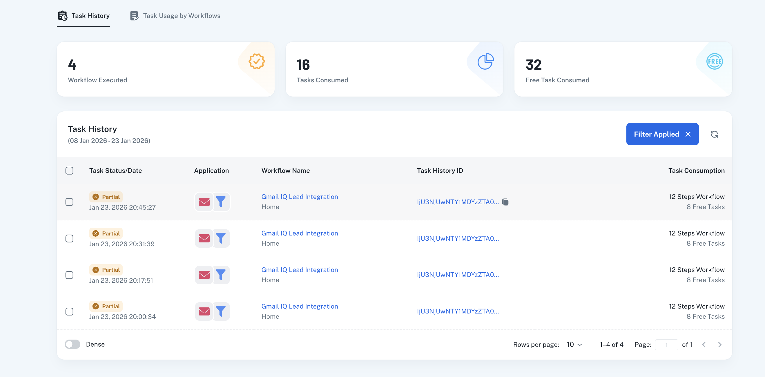

I just have 3 task consuming stage, but still the workflow is considered as a 4 task-consuming stages workflow.

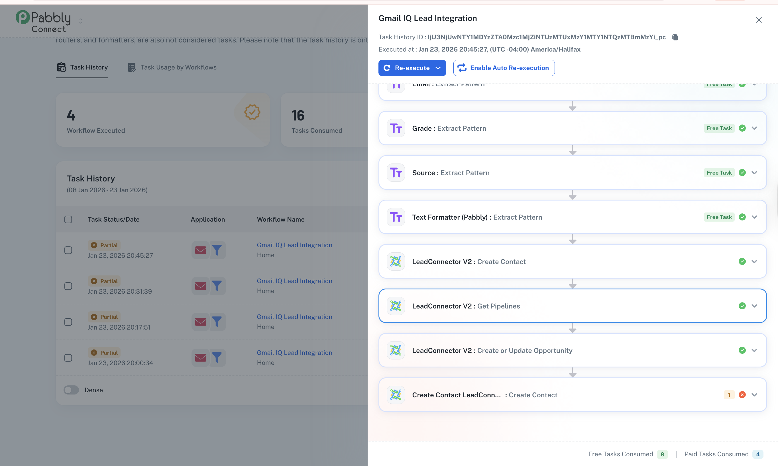

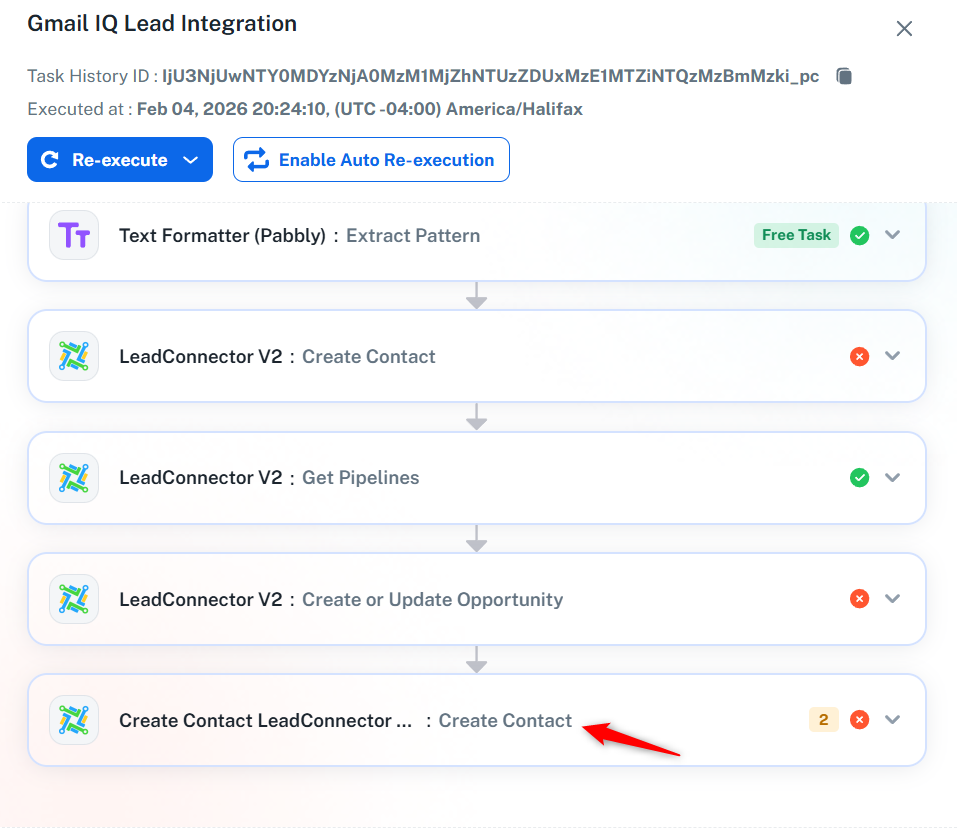

Upon checking the task history, it appears that there are four LeadConnector actions executed in your workflow:
  1. Create Contact
  2. Get Pipelines
  3. Create or Update Opportunity
  4. Create Contact (again)

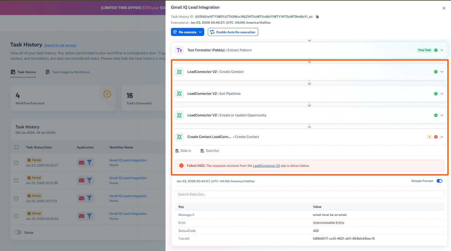

Additionally, the last Create Contact step is failing with Status Code 422 (Unprocessable Entity).
To confirm and help us investigate this properly, could you please confirm if you had added the Create Contact step twice in the workflow and later deleted/modified one of them?

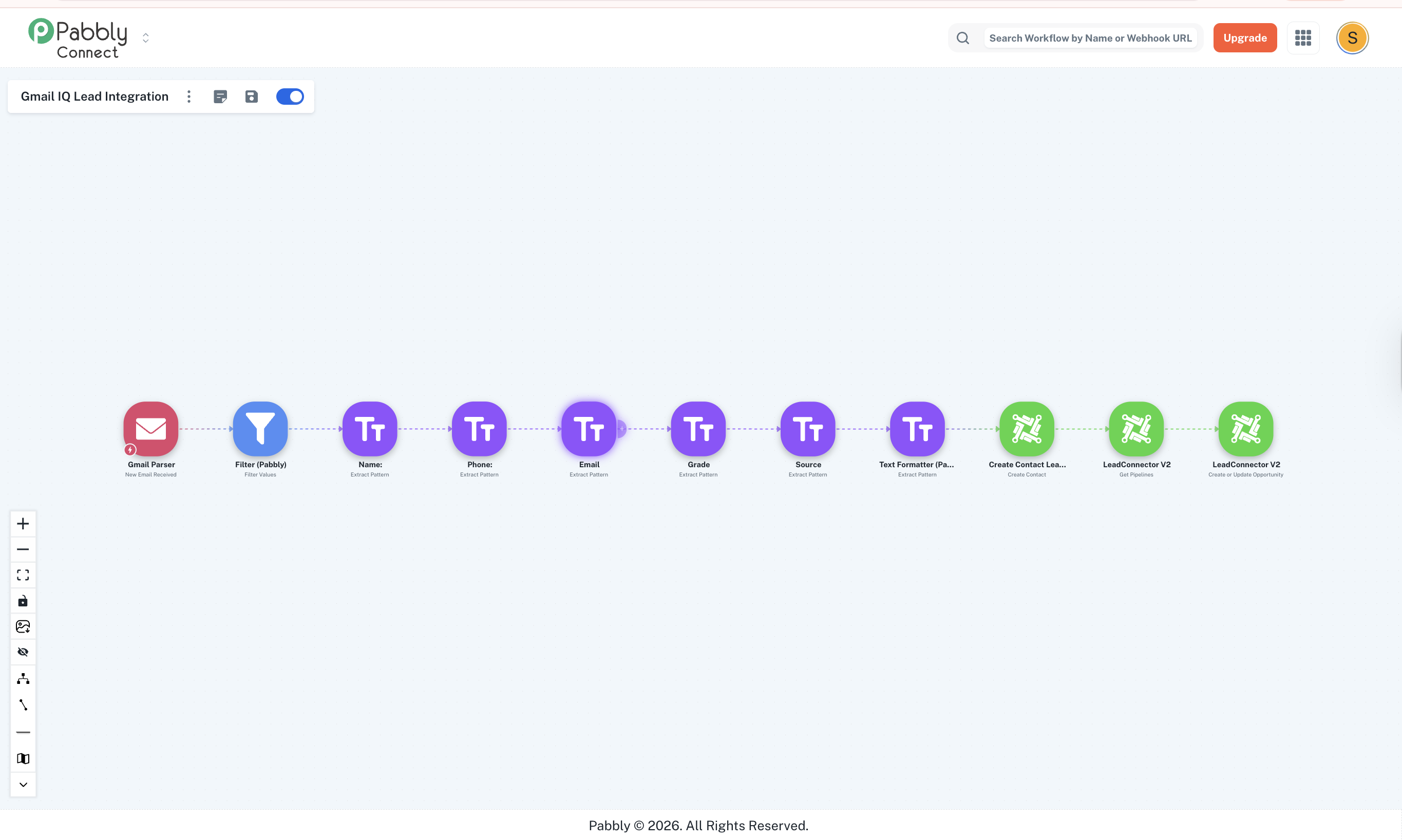

Hello Preeti, As you can see from the images of the workflow shared above, there is no stage that we have created or that is connected in the workflow. Could you please look into this and help us.

The workflow has been there like this since starting, and we can't see that node/step. We don't know how to get rid of this.
