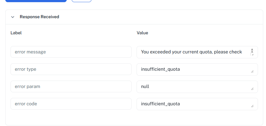

I am getting an error message as following: You exceeded your current quota, please check your plan and billing details. For more information on this error, read the docs: https://platform.openai.com/docs/guides/error-codes/api-errors.
I am using a free account to test and I have 96 free tasks remaining so I am not sure if it is API problem with OpenAI (software I am using) or Pabbly Connect.
(I have attached a ss of error message)

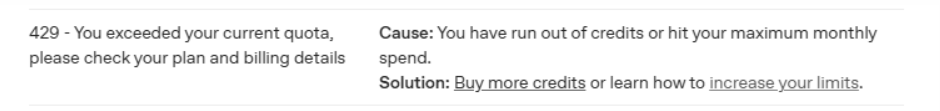

The 'Insufficient Quota Error' if from OpenAI's end. It indicates that you have exceeded your current quota.
Cause: You have run out of credits or reached your maximum monthly spend.
Solution: You will need to either buy more credits or increase your limits from your OpenAI account settings.
You can manage this from the following links:
- Billing: https://platform.openai.com/settings/organization/billing
- Limits: https://platform.openai.com/settings/organization/limits
For more details, you may also refer to the official documentation: https://platform.openai.com/docs/guides/error-codes/api-errors
