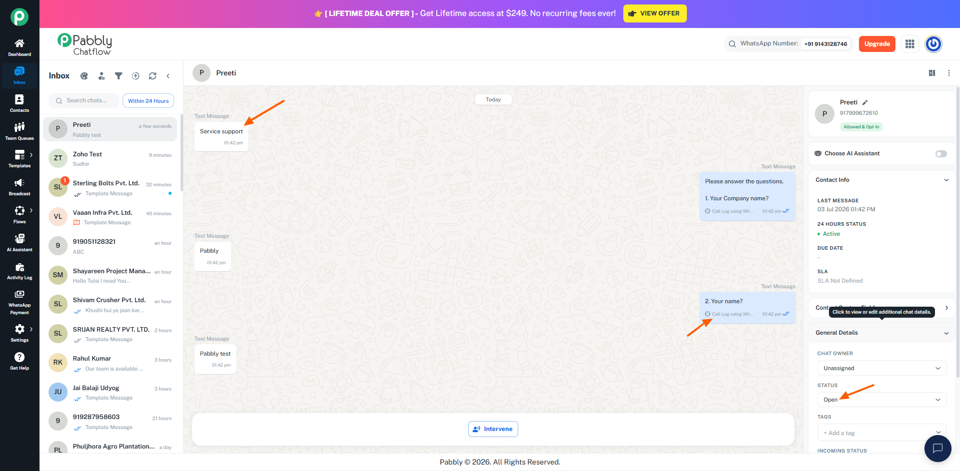

Based on our testing, it is possible that the WhatsApp number you are using to test the flow is currently in an Intervened status. Please note that Pabbly Chatflow automations are triggered only for chats that are in the Open status. If a chat is in the Intervened state, the flow will not trigger, and no entries will appear in the Flow History.
We recommend checking the status of the chat from which you are testing and ensuring that it is in the Open state before sending the trigger message.
Once the chat is open, please test the flow again and let us know the results. If you continue to face any issues, we'll be happy to investigate further.

From our previous testing, the flow appeared to be working correctly when the trigger keyword was sent. Could you please confirm whether you have tested the flow again from your end?
If you are currently facing any other issues or if the flow is still not triggering as expected, please let us know the details, and we'll be happy to assist you further.
