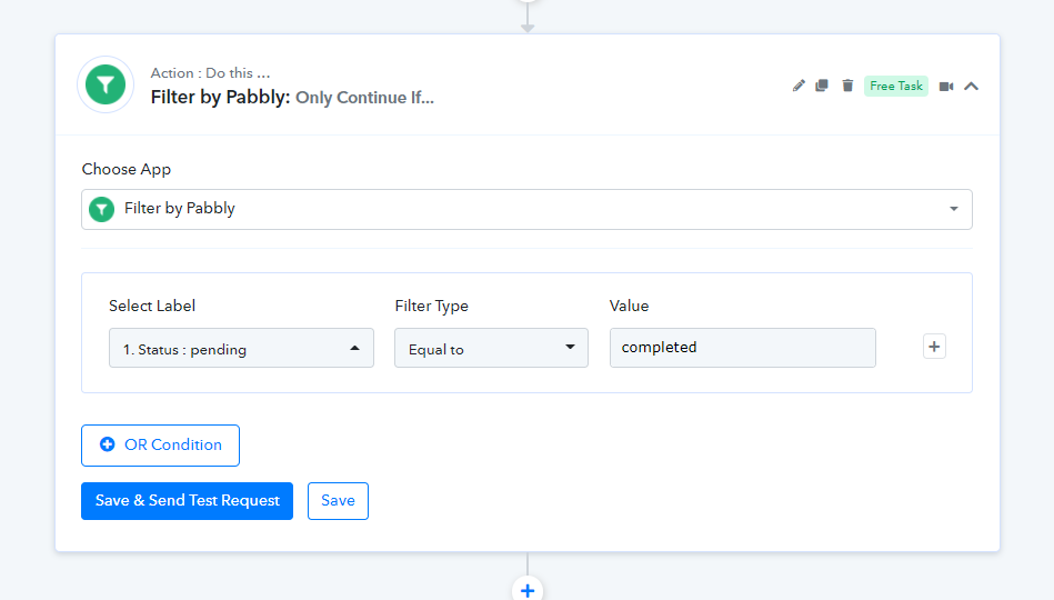

Hey @bvolts
In your workflow, you can include a filter action step to exclude other order statuses from WooCommerce. This ensures that messages are only sent to customers with a completed or successful order, according to your requirements.

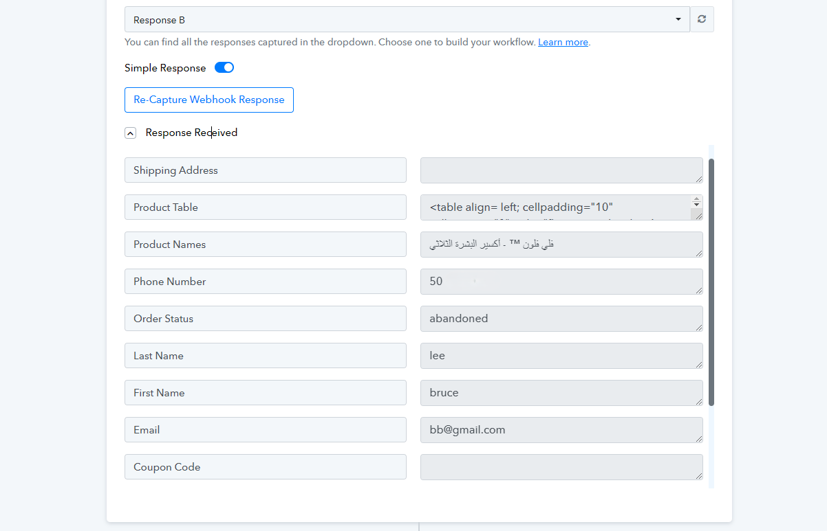

Following up on our previous correspondence regarding the integration issues between WooCommerce and WhatsApp, we would like to clarify the scenarios under which we encounter what we define as an "abandoned cart," and seek your guidance on setting up filters accordingly.
We have identified two primary cases of abandoned carts:
1. **Pending Payment Abandonment:** The customer adds items to the cart and initiates the checkout process. WooCommerce then creates an order with the status "Pending Payment," but if the customer does not complete the payment it will be automatically changed to "Failed" status and be captured as abandonment.
2. **Pre-Payment Abandonment:** The customer enters their details (like email and address) but abandons the cart before proceeding to the payment options. In this scenario, WooCommerce does not create an order.
Our main challenge in addressing these scenarios is that the "Abandoned Cart" trigger in Pabbly Connect does not include the "Status" of the order in the responses received.
We need assistance in setting up these two scenarios effectively. Our goal is to ensure that our WhatsApp notifications for abandoned carts are triggered accurately.
Could you please provide detailed guidance or instructions on how we can configure our Pabbly Connect workflows or filters If there are any specific settings or conditions we should apply, please advise.
Thank you for your continued support and assistance. We look forward to resolving this issue promptly.
To identify the status of the order in these scenarios, you can use the "Retrieve an Order" action step in Pabbly Connect. This step will allow you to pull detailed information about the order, including its status, helping you differentiate between "Pending Payment" and other types of abandoned carts. By incorporating this into your workflow, you can set up more precise filters to manage and respond to these abandonment cases effectively.
