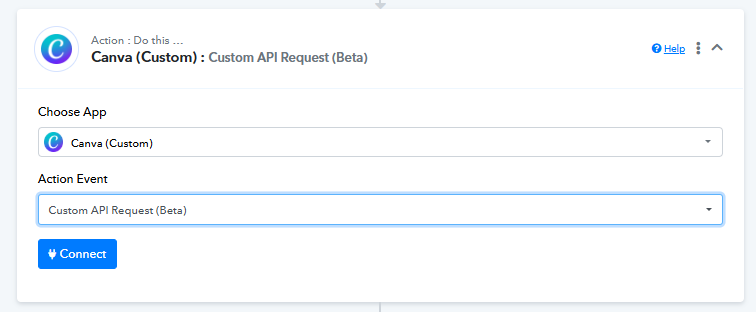

Hello @jmjmjm,
The Custom API Request action under Canva is now available. You can now use the Canva API as per your requirements.

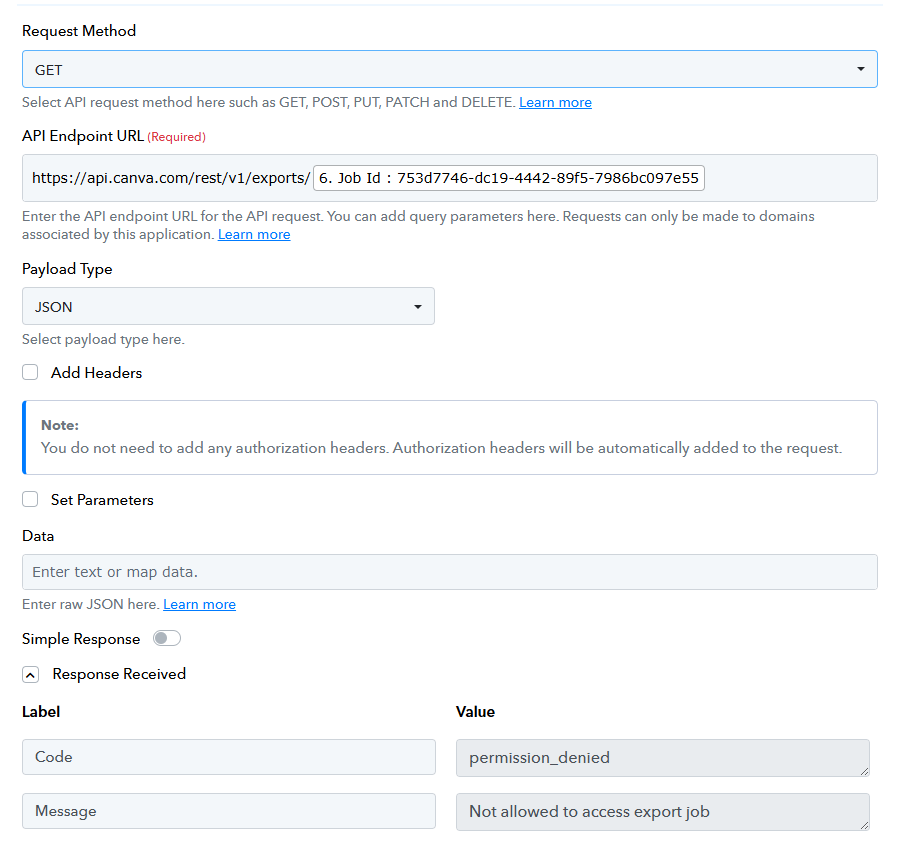

Thanks for implementing so quickly. Trying it out now but on the endpoint shown it's saying I don't have the permission to export? Is it correctly providing the authorisation headers required? Thanks
jmjmjm — Reply ·
Screenshot here
Could you please share the cURL command of the endpoint you attempted to execute? Also, share the Workflow URL where you tried this.

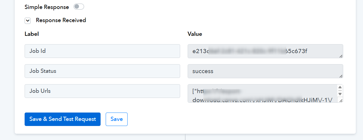

You were mapping the Job ID from Step 6 of the workflow. We mapped it from Step 7 of the workflow, and it appears to have fixed your issue.
