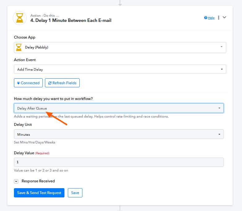

I've made a clone from the original workflow which I've used before & worked fine.
However, in this clone - my iterator isn't going through the entry one by one after 1 minute delay in-between. Instead, it bulk send everything & the Gmail account got rate limited. It has consumed my tasks as well.
What went wrong?
I also have another workflow that faced the same issue.
URL: https://connect.pabbly.com/workflow/mapping/IjU3NjcwNTZkMDYzMjA0MzI1MjZiNTUzNTUxMzIi_pc
Hello @HelpMeLearn,
Thanks for reaching out to us. Please try replacing the Delay For with Delay after queue and let us know if it helps.

Hello @HelpMeLearn,
Hi, Preeti.
Thank you for your reply. I'm trying out your suggestion.
