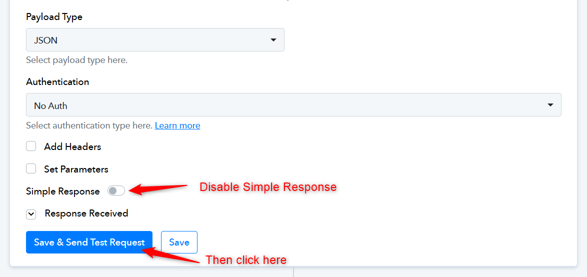

You need to disable 'Simple Response' and then click on 'Save & Send Test Request'. This will allow you to capture the response as an array, which can be recognized by the Iterator.

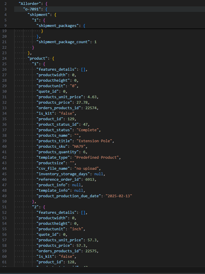

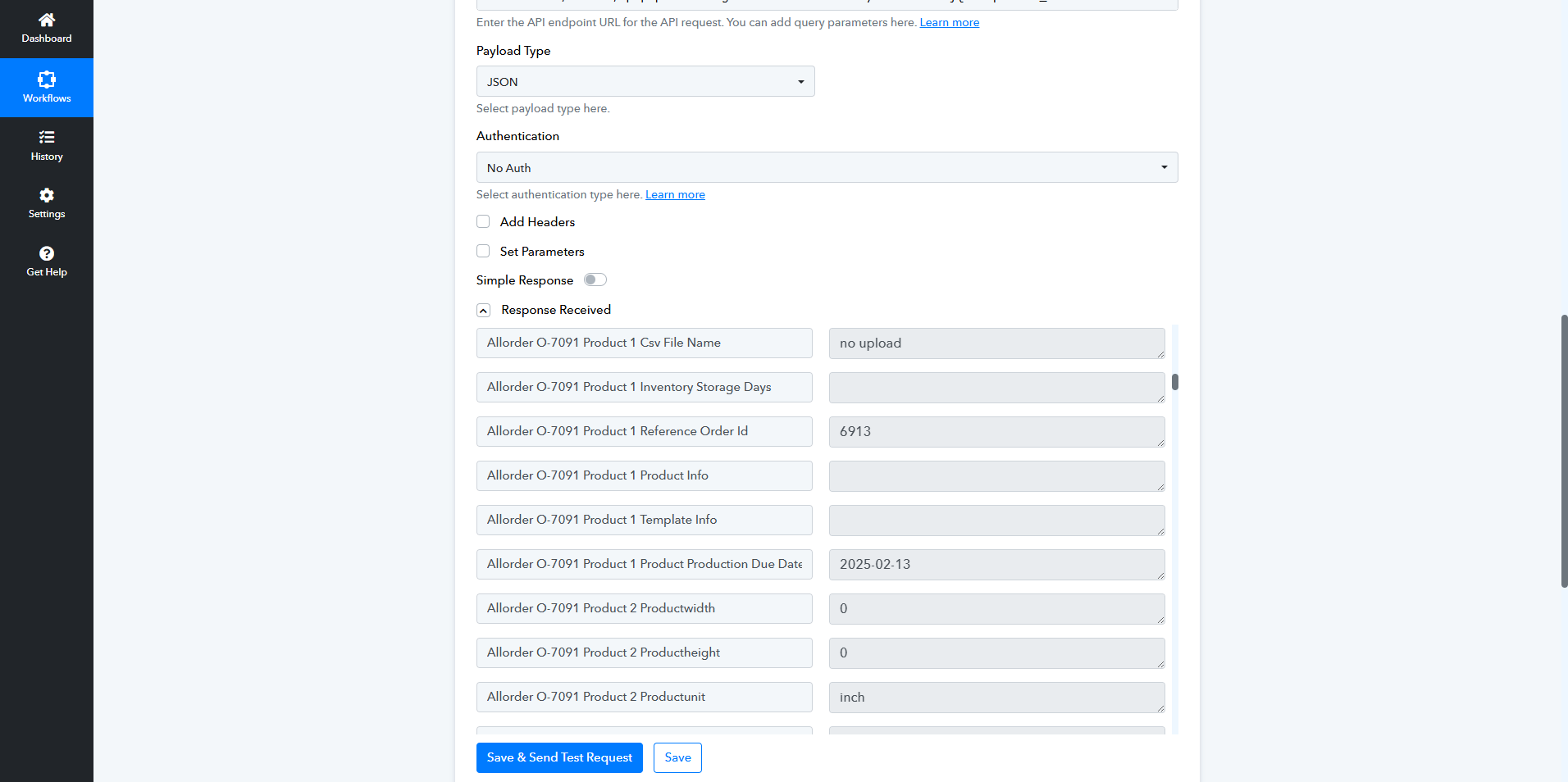

I am experiencing this same issue. Even when I disable Simple Response, the response is still showing as simple. So the Pabbly Iterator is not able to see or process the data. Attached is a screenshot of the Workflow results and also a JSON file with the 'Product" data that should qualify to iterate.
Thanks, that solved my issue.
