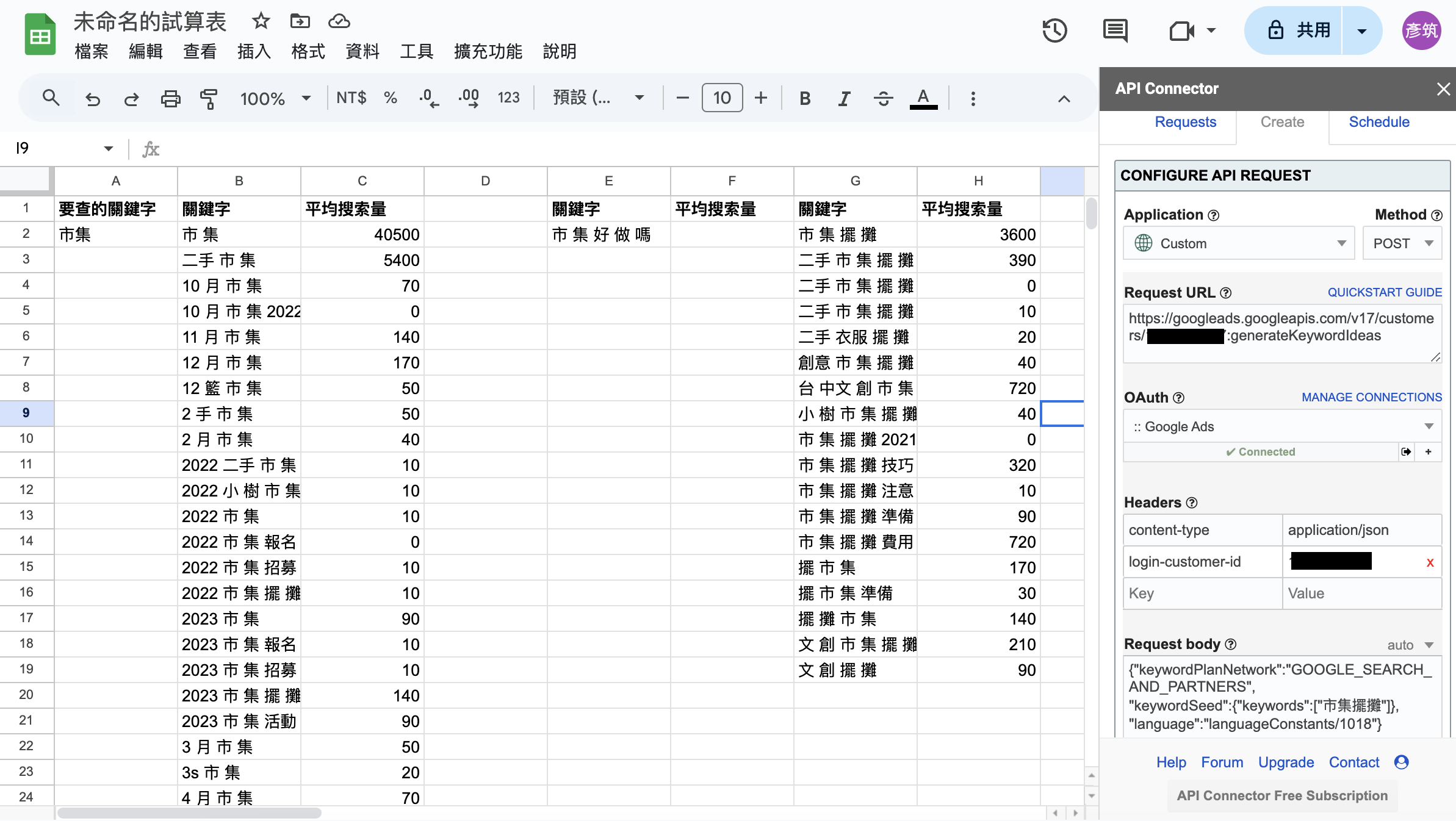

My ideal scenario is to type a keyword in Slack, then be able to call the Google Ads API and list the keyword and search volume in a Google Sheet.
I'm using the API Connect tool and I can successfully call the Google Ads API (Keyword Planner). Below is a screenshot of the successful call.
Since API Connect can make the call, I think Pabbly should also be able to make the call, but I'm not sure how I should configure it.

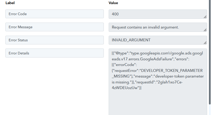

Hello @BambooC
Upon checking we found out that the error says that the developer token parameter is missing. Please check and add parameters to pass the developer token and let us know if it works for you.
