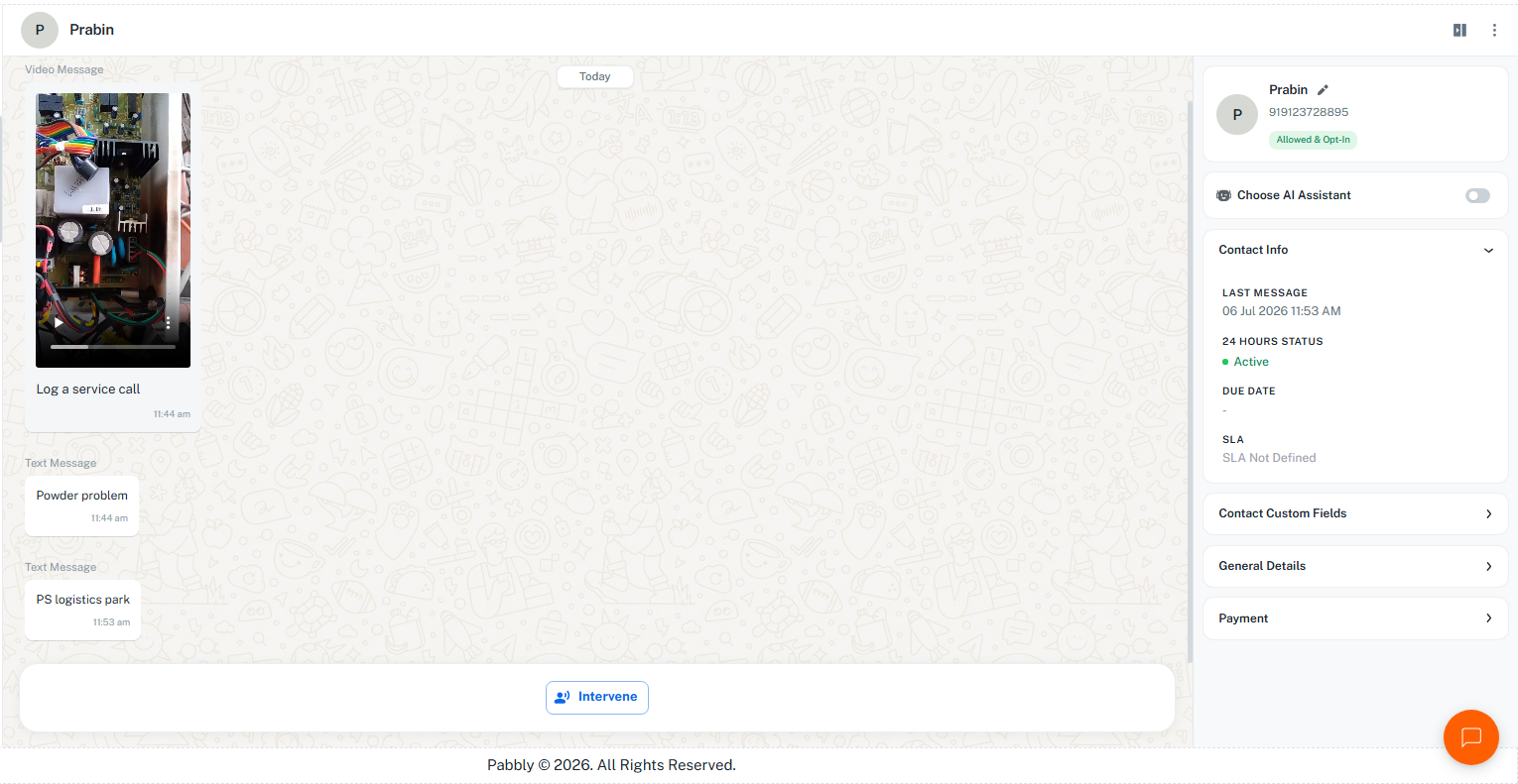

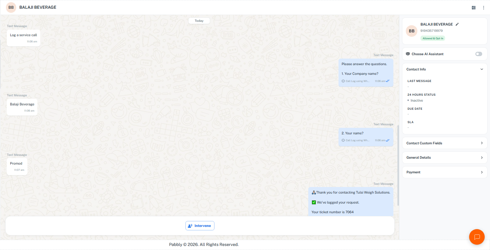

We are facing an issue in Pabbly Chatflow with the Keyword/Regex Match trigger.
We have created a flow where the trigger should start when the customer sends the text:
“Log a service Call”
The flow works properly when the customer sends this as a normal WhatsApp text message.
  • However, when the customer sends an image or video with the caption/text “Log a service Cal, the flow does not trigger.
Our requirement is:
If customer sends “Log a Call Manav” as text, the flow should trigger.
If customer sends image/video with caption “Log a Call Manav”, the flow should also trigger.
  • The flow should work with or without media attachment.
Please confirm:
  1. Does Keyword/Regex Match trigger support caption text from WhatsApp image/video messages?
I have attached screenshots showing the flow setup and the WhatsApp test where text works but image caption does not trigger the flow.
Please check and guide us with the correct solution.

Pabbly Support — Reply ·
Thank you for your patience.
We would like to inform you that if a user sends an image with the keyword/regex included as the caption, the flow will not be triggered.
This is because the incoming message is classified as an image message, whereas the Keyword/Regex Match trigger evaluates only text messages. Since the message type is image rather than text, the keyword/regex condition is not matched, and the flow does not trigger.
If the user sends the same keyword as a normal text message, the flow will trigger as expected.
Anushka Sahu
🌐 Pabbly.com
