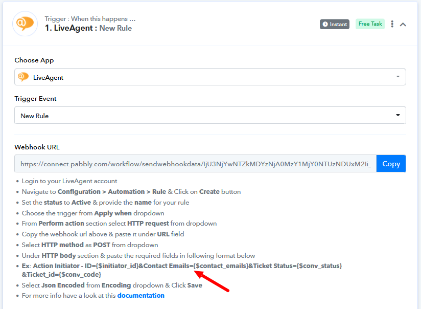

I am trying to automate our support as much as possible by retrieving data from LiveAgent.
Based on the steps provided by Pabbly, I can only retrieve 4 fields and none of them are the content of the ticket.

Hello @neilnapier,
To retrieve all the required fields, you can add them under the HTTP Body section. As shown in the example below, you can include additional fields as needed:
Example:
Action Initiator - ID={$initiator_id}&Contact Emails={$contact_emails}&Ticket Status={$conv_status}&Ticket ID={$conv_code}
