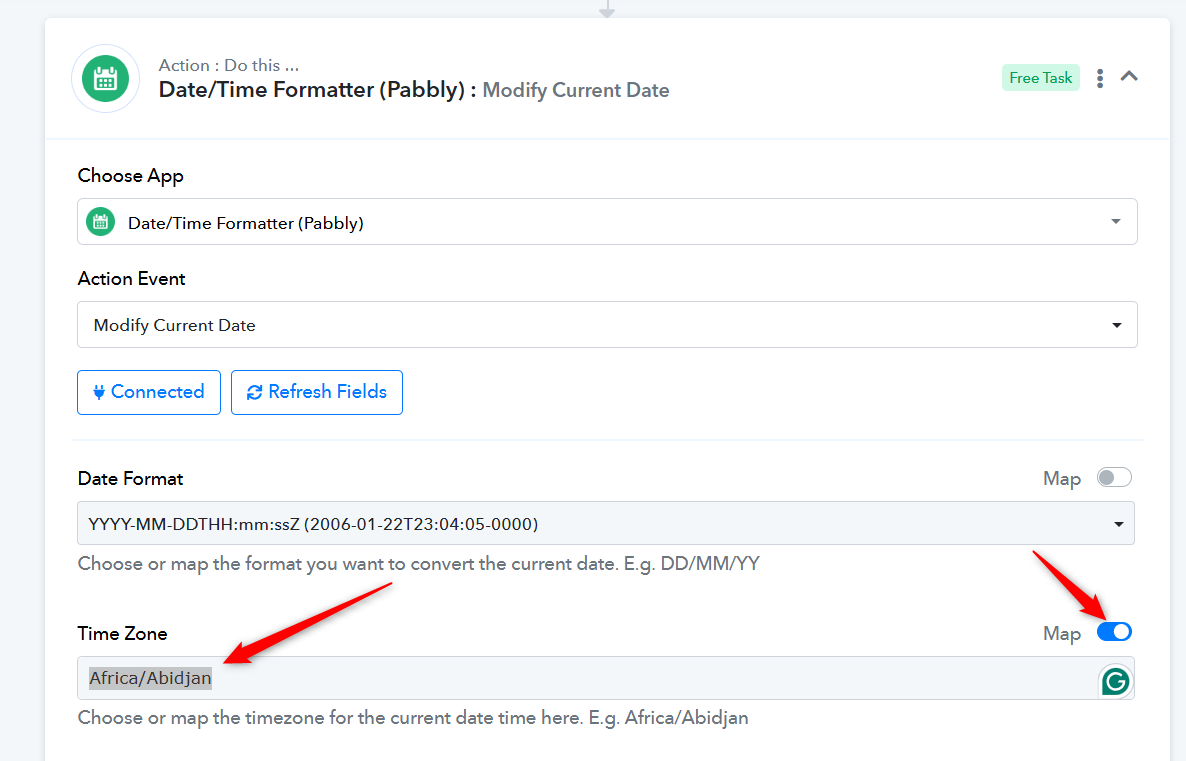

Fagun Shah — Reply ·
You need to make sure that your lead form has timezone dropdown matching pabbly connect's date and time formatter actions' timezone dropdown.
That way you will be able to capture the lead's timezone and map that in date-time formatter actions dynamically.
Then you need a form builder that detects the location and timezone on the backend based on IP Address.
Or take zipcode from user and then use some other api in pabbly API action to get the timezone based on zip code.
