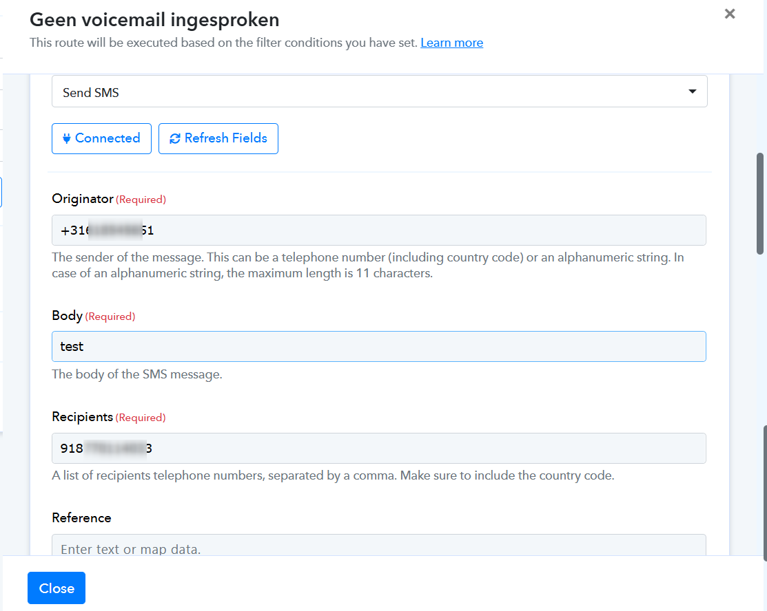

I want to send a SMS with messagebird, the step is within a router.
I have the required field filled and mij 'originator' verified at the side of messagebird.
When testing the step it all ways returns the error

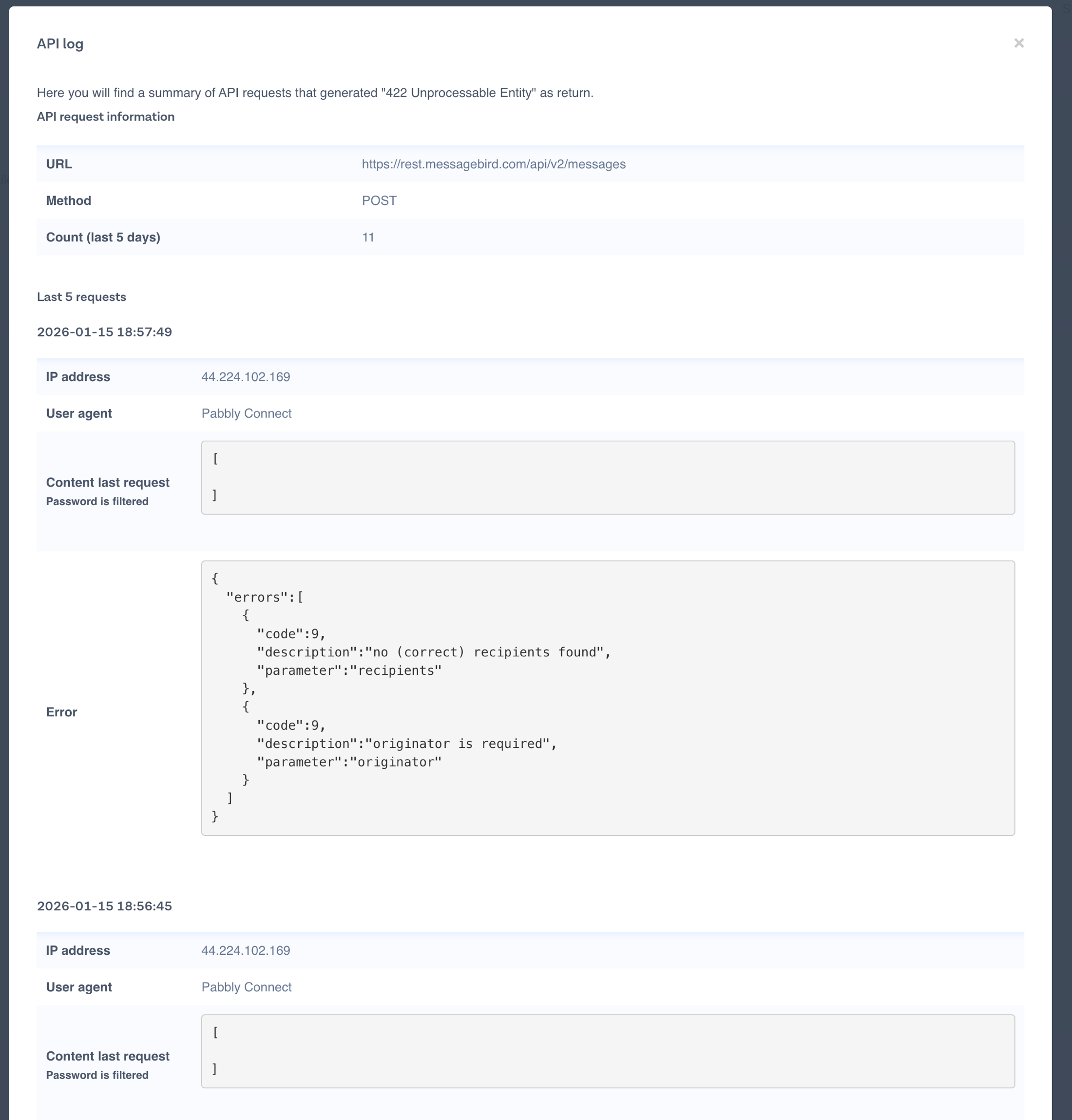

}When looking in the api-log at the side of messagebird it shows as no data at all was send to messagebird as the "Content last request" field is completely empty.
Hi @Richard_wp,
Thanks for sharing the screenshot. Upon checking the configuration, it looks like the issue is coming from the values entered in both required fields:
- Originator
You have entered “WPHelpdesk” as the originator. In many MessageBird accounts, the originator must be a valid sender number (with country code) or an approved sender ID, otherwise MessageBird may reject it.
Kindly try using a valid sender phone number (as per your MessageBird account configuration) and test again. - Recipients
Please ensure the recipient number is entered in the correct international format and is a valid mobile number (including country code). If required, try removing the “+” and test once again, as some providers expect only numeric values.
Once you update these values, please re-test the action and it should work correctly.

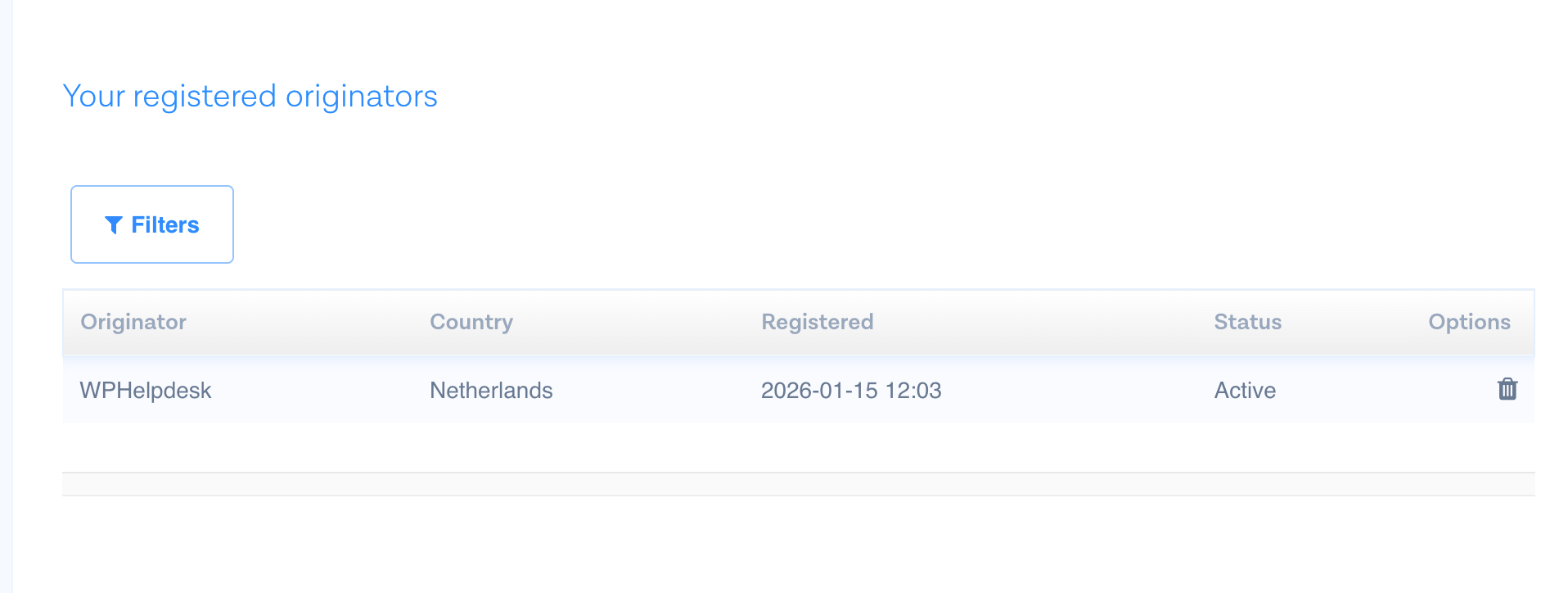

with messagebird the sender can be a alpha&numeric name with a limit of 10 characters, and as stated I have the sender name verified.
already tested different recipient number formats (for netherlands +31, 0031, 31, none of these work)
As stated in the api logs on the end of messagebird the entries are empty, none of the data is send by pabbly to messagebird.
Thank you for sharing the additional information. Could you please share a screenshot showing the originator verified in your MessageBird account so our technical team can look into this issue?

images of the registered originators and of the messagebird api log.
I assume the 18:57 time entry was a test by one of the support agents of pabbly?

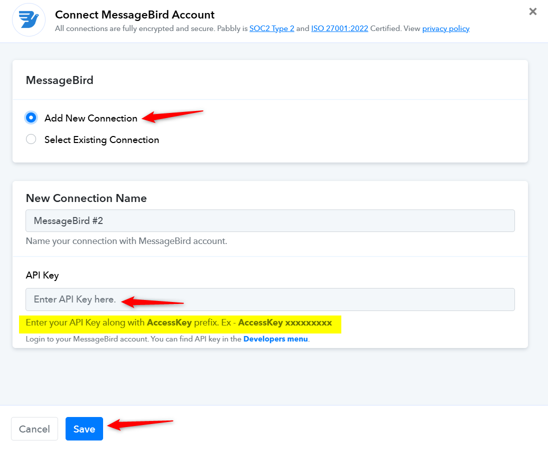

Thank you for sharing this information. Please establish a new connection with your MessageBird account, make sure to enter AccessKey as a prefix to your API key while setting up the connection, and see if that fixes the issue.

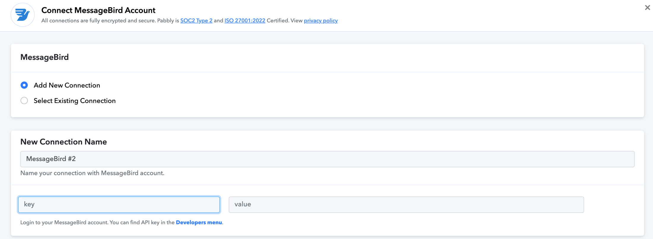

updated connection but no change.
could predict that, as the api response had nothing to do with an invalid api key and as shown in my earlyier screenshot messagebird did got a call on the api-endpoint with my api-key. just not the correct data/in correct format from pabbly
when adding a new account in pabbly the input is changed with an additional field that isn't documented as what there should be put.

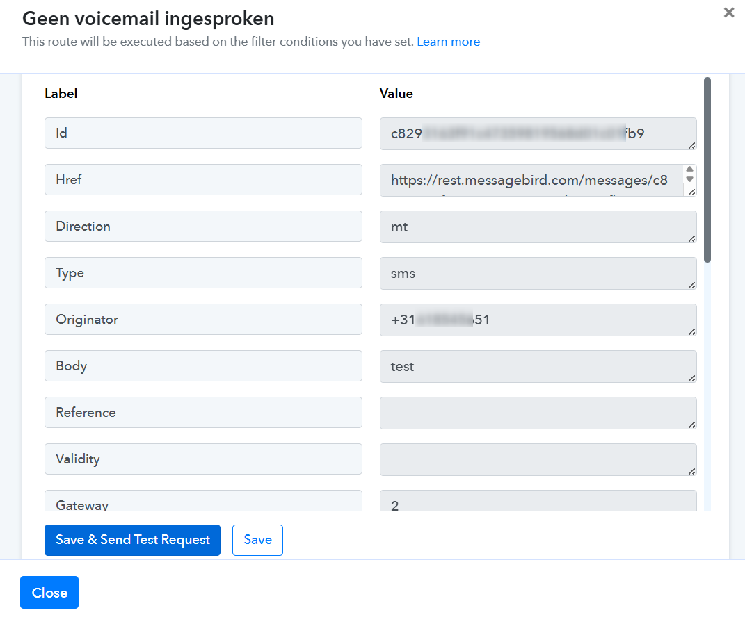

The issue appears to be related to using the same number in both the Originator and Recipient fields. We used a different test phone number in the Recipient field, and this seems to have resolved the issue. We successfully received the SMS on your test phone number.
