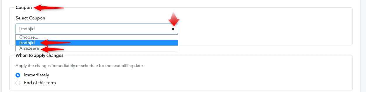

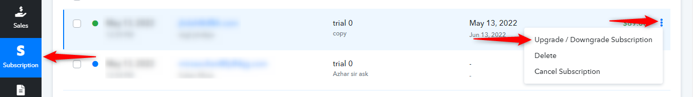

Also, you can Add or Remove the coupon for an existing customer or we can say that you can change the coupon for the ongoing subscription for a customer.
Subscription >> Click on 3 dots (given against the subscription) >> Upgrade/Downgrade Subscription >> Coupon (Select Coupon - the coupon which you want to apply in place of the other) >> Save
So, the 4th and 1st Scenario is not possible since we do not allow to edit the coupon except Valid Upto and Maximum Redemption fields but 2nd and 3rd Scenario is possible on our Pabbly Subscription Billing and you can achieve that by following the above given steps.
