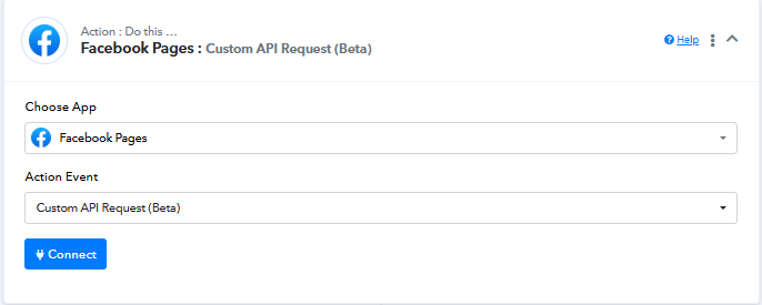

In the meantime, we also recommend using the Custom API Request option available under the respective Facebook application in Pabbly Connect

Hello @sonuku,
Please try using the Custom API Request action under Facebook Pages to see if it helps resolve the authentication issue. If there is a specific action you would like to use that is not available in the current application, you can submit a request for it on our roadmap at https://roadmap.pabbly.com/.
