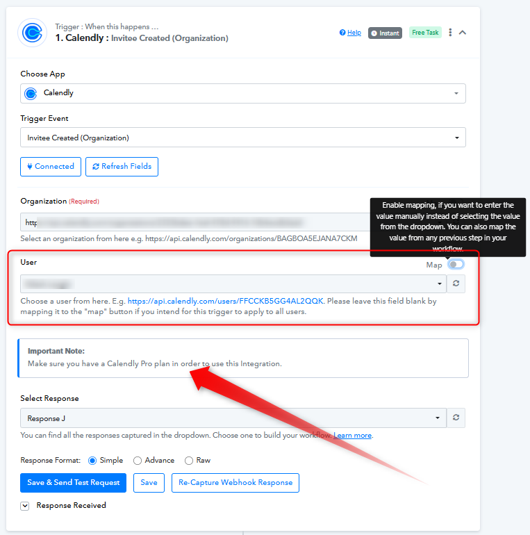

Additionally, kindly verify the following from your end:
  • Please leave the User field blank by mapping it to the Map button if you intend for this trigger to apply to all users.
Once you confirm these details, we'll proceed further with the investigation.
