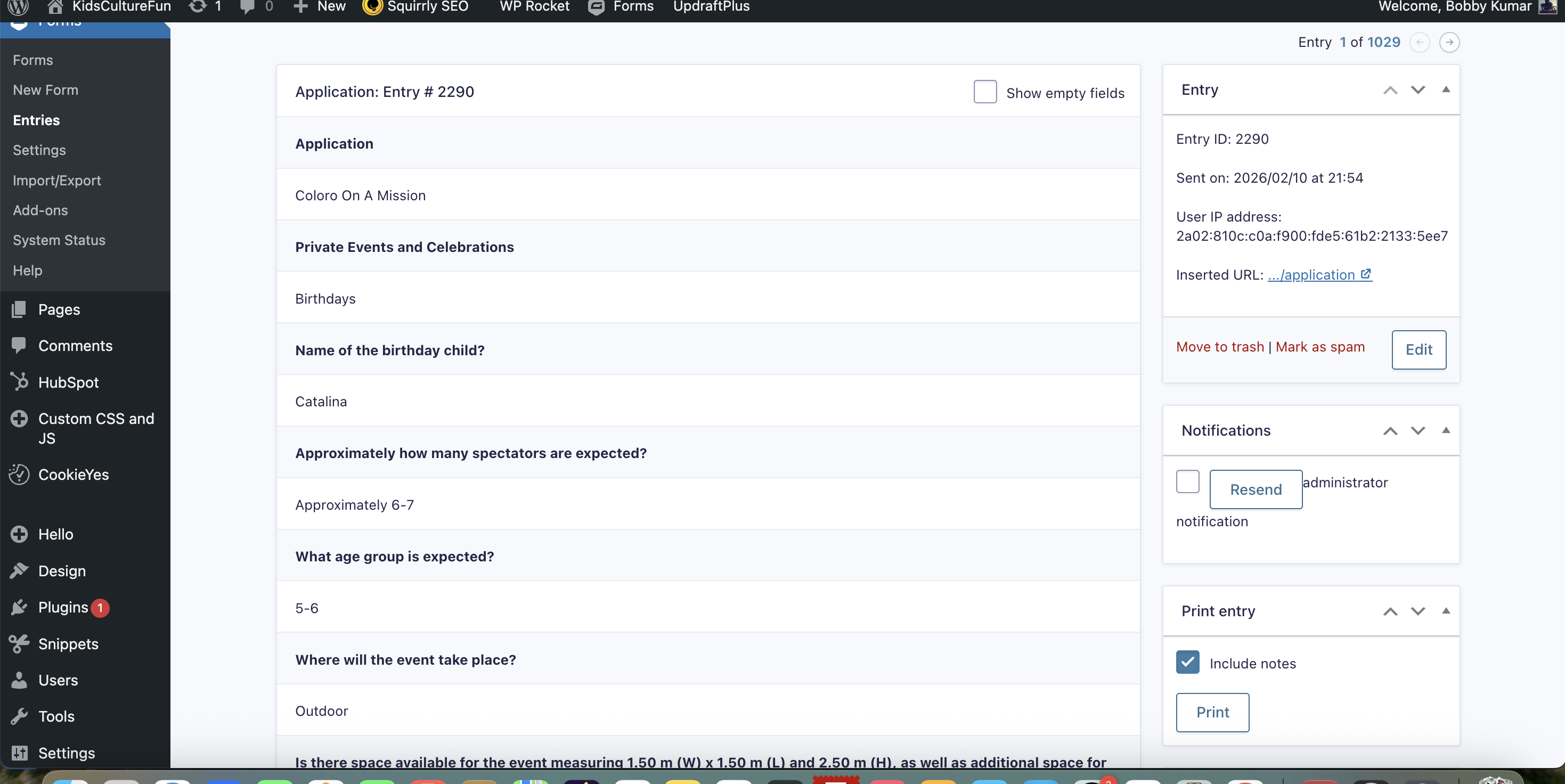

I’m having an issue where Gravity Forms should trigger a request to Pabbly after submission, but the request is not appearing in Pabbly. This has happened twice now (it happened previously as well). Can you help me understand why the request isn’t reaching Pabbly?
Bobby — Reply ·
see this date is in today not i did not showing any entry in pabbly in today why ?

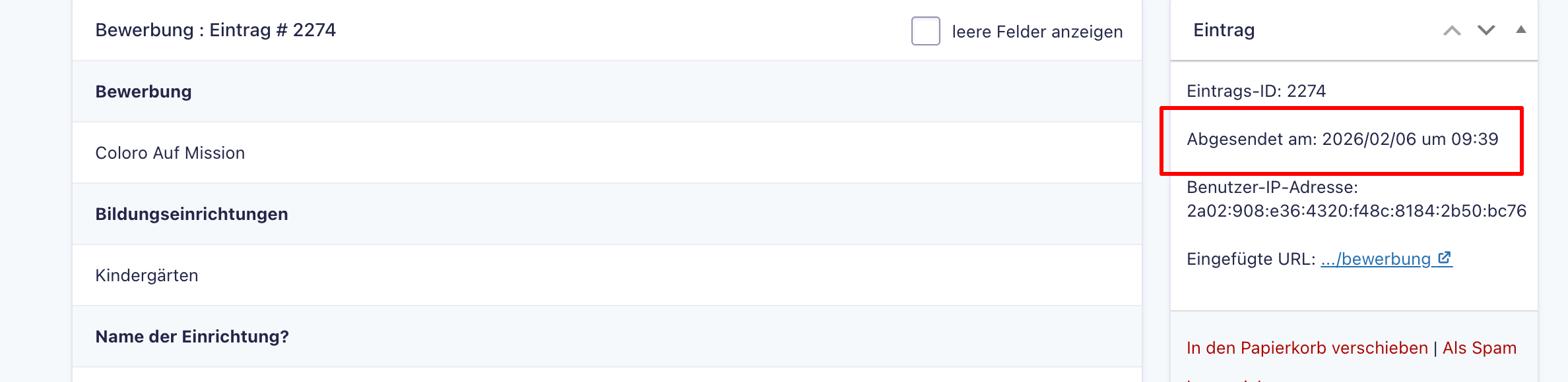

Hey @kumarbobbyldh,
Thank you for sharing the screenshot. Upon reviewing it, we can see that a timestamp is mentioned. Could you please confirm the time zone in which this time is recorded? This will help us evaluate whether it falls within the downtime window we experienced.
We also recommend monitoring the workflow for some time to see if the execution gets captured, as webhook responses sent during the downtime may have been queued in our system and should execute shortly.
Please let us know once you have the time zone details.
Bobby — Reply ·
Thanks for your message. The timestamp shown in the screenshot is recorded in the Berlin, Germany time zone (Europe/Berlin) — i.e., CET (UTC+01:00) or CEST (UTC+02:00) depending on daylight saving time.
Pabbly Connect experienced downtime today between 12:38 PM IST and 03:17 PM IST. Since your webhook was supposed to trigger at 02:09 PM IST, you encountered this issue.

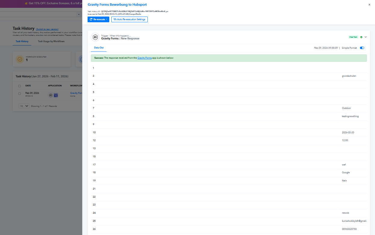

hi i have a one other problem check on this id IjU3NjUwNTY0MDYzNzA0M2M1MjZiNTUzMDUxMzI1MTYyNTQzMjBmMzYi_pc
in pabbly Response its empty i did not received any data why this happen again and again
also this one
IjU3NjUwNTY0MDYzNzA0MzE1MjZkNTUzMjUxMzc1MTZiNTQzMDBmMzAi_pc
Hi @kumarbobbyldh,
Could you please confirm which specific step is returning an empty response?
From our end, the trigger response appears to be captured correctly in the Task History. Kindly refer to the attached task screenshot for clarity.
Once you confirm the exact step, we’ll be able to assist you further.

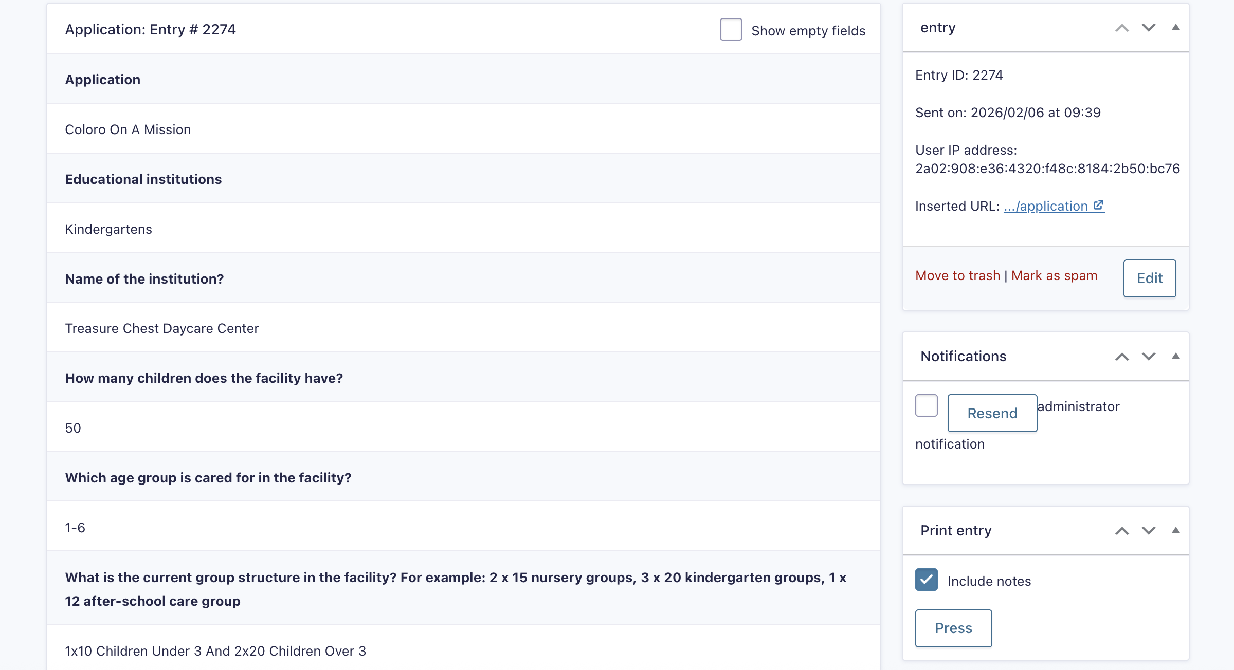

It doesn't always happen; it only happens sometimes here is a form entry its showing all data not in pabbly please see this issue i face to many time this problem
Hi @kumarbobbyldh,
Thank you for the clarification.
From our end, the Task History entries appear to be capturing the trigger data correctly. We are not able to see missing fields in the executions we checked.

Bobby — Reply ·
all from data is missing you can see on History entry. i show you 2 Task History entry
