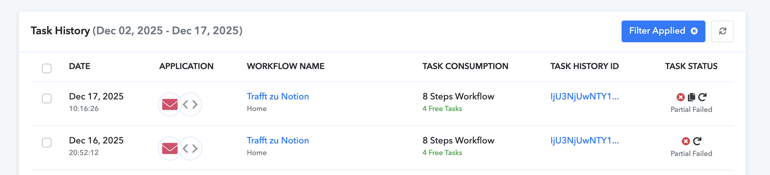

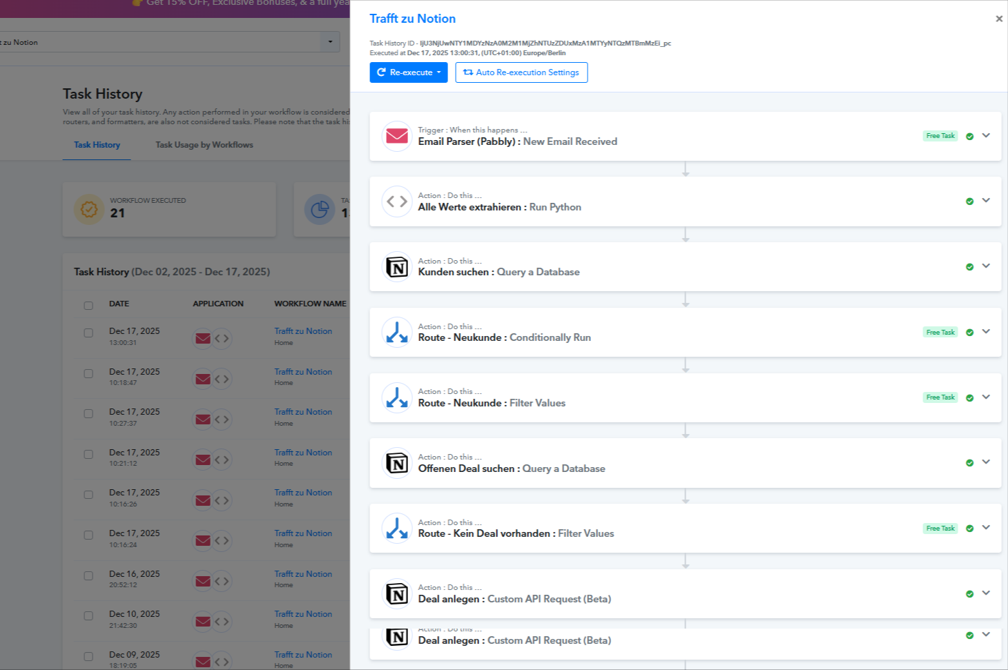

I have tried what you recommended but still the error persists. You can see it in the workflow "Trafft zu Notion"
Original run: IjU3NjUwNTY1MDYzNzA0MzM1MjZhNTUzNTUxMzI1MTY1NTQzODBmMzYi_pc
First re-execute: jU3NjUwNTY1MDYzNzA0M2M1MjY4NTUzZDUxM211MTZhNTOzMDBmMz0i_pc
Second re-execute: 1jU3NjUwNTY1MDYzNzA0M2M1MjY5NTUzNDUxMz|1MTY2NTOzMzBmMzgi_pc
Hello @Volker,
I was only able to access this task history ID; the rest two were not accessible. However, when I executed it, it worked well.
Task History ID - IjU3NjUwNTY1MDYzNzA0M2M1MjZhNTUzZDUxMzA1MTYyNTQzMTBmMzEi_pc
Volker Klärchen — Reply ·
Yes, it worked now because in the meantime I updated to connection again.
If you filter the history by workflow and status you find these two. No amount of re-execution could fix it until I update the connection.
Hello @Volker,
Please try re-executing the task under the filter, and then remove the filter to check the re-executed task history.
