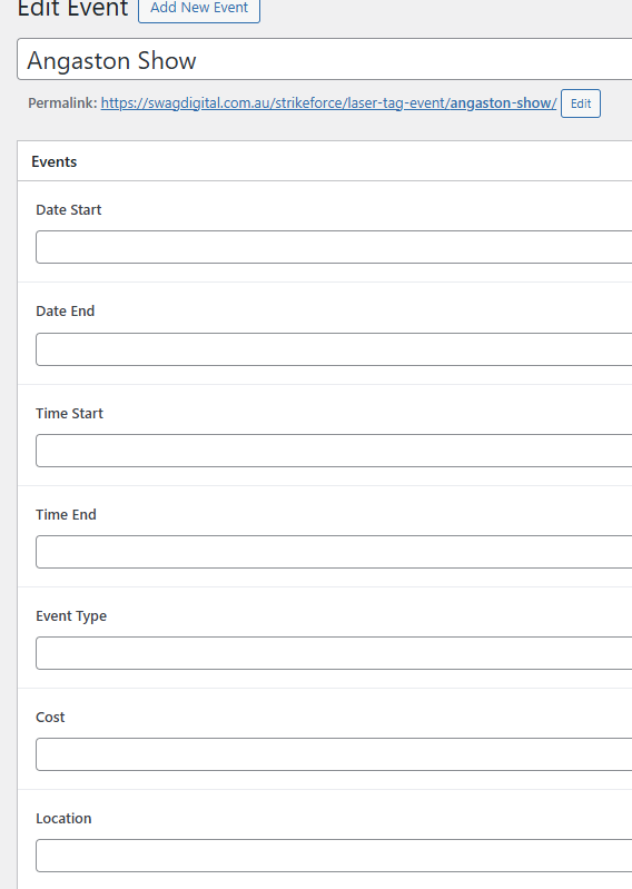

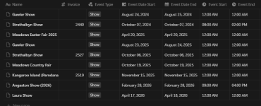

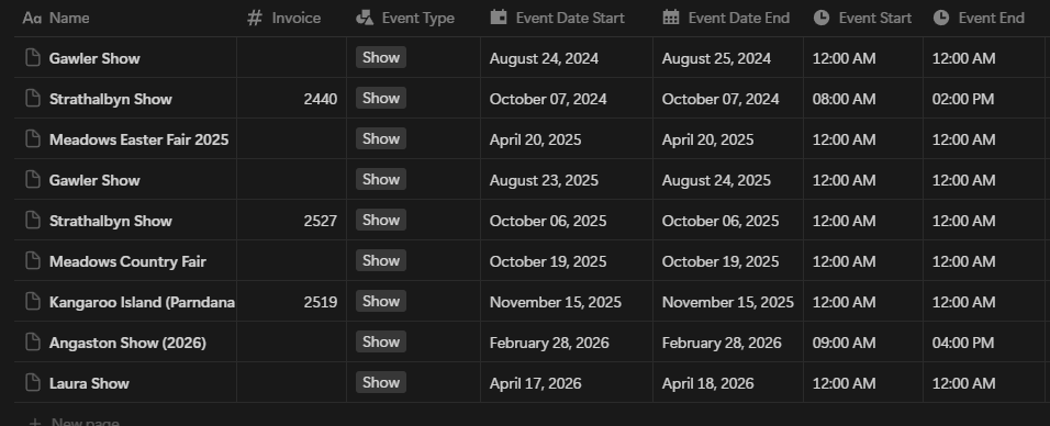

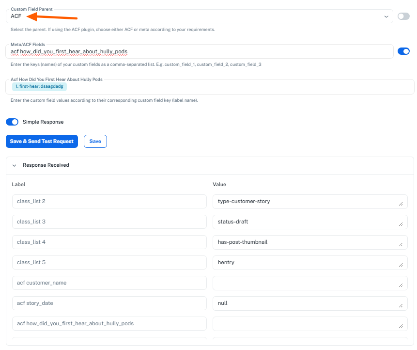

I am trying to map a notion database to create a new post for a CPT on my WordPress website. I am seeing the standard WordPress fields when trying to map fields but I need to map notion data to ACF fields.
Is this possible with Pabbly?
Troubleshooting and Testing:
- Confirmed Pabbly connection to Notion working
- Confirmed Pabbly connection to WordPress is authenticated and working

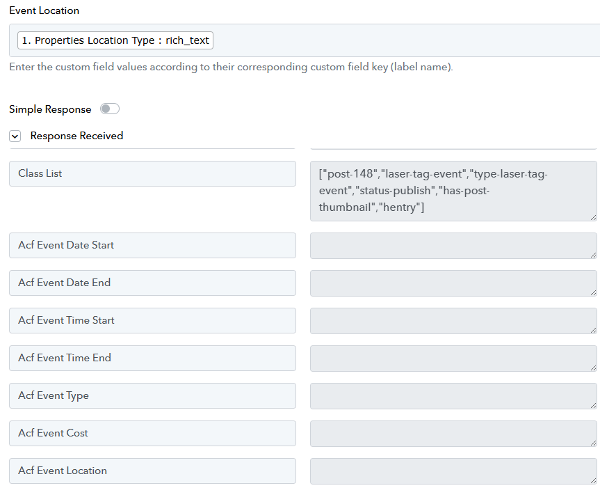

- My ACF Custom Fields are empty when the post gets created
- Confirmed my ACF Custom Post Type is enabled for REST API
Found a similar issue: https://forum.pabbly.com/threads/add-custom-fields-and-featured-image-in-wordpress.15176 with new posts from today describing my same experience
I am sure I'm probably missing something obvious to make it work and any help is appreciated.

[IMG width="646px" height="194.628px"]https://lh7-rt.googleusercontent.com/docsz/AD_4nXfK-r_xq5gj3mjhta-kLIfk4ULSxsvcRtvmqyY72iBCaEjKBpbBtyyrwC_zWRMnDcbGoJOp1xwe4aAF19DtQpgz0XpFXxniIWT1JNbUFg5EuuO_4sYMJrgGzGXLDpGvMPJwdcH72Q?key=nsDumdqHFySLv4i3KkkEsp9o[/IMG]

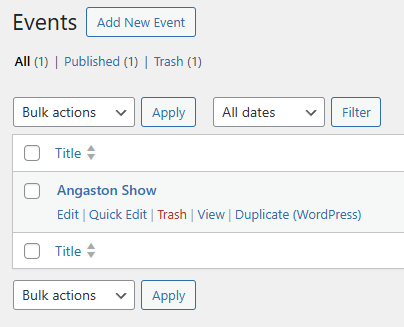

Thanks for sharing the permission. Please note that we are currently testing the issue, and during this process, some posts may get created in WordPress.

Could you please share a short screen recording showing the meta fields you have created inside WordPress, along with any expected format required for those fields? This will help us better understand and look into the issue. Please note that we may need to escalate this concern to our technical team, and during the process, some posts may be created for testing purposes.

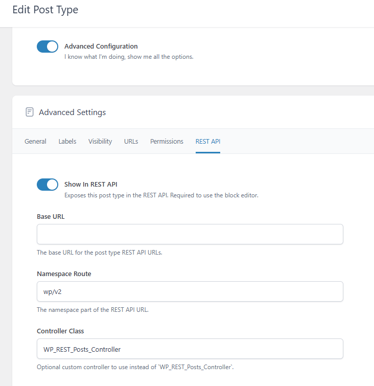

Hello @strikeforce,

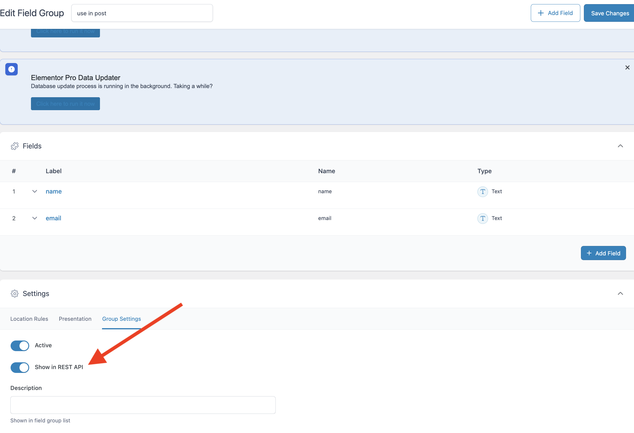

This is to inform you that ACF fields are now supported. Please enable the “Show in REST API” option under your ACF plugin settings (refer to the attached image). Once enabled, you can pass the custom fields under the acf object, and the values will be added when creating the post.
