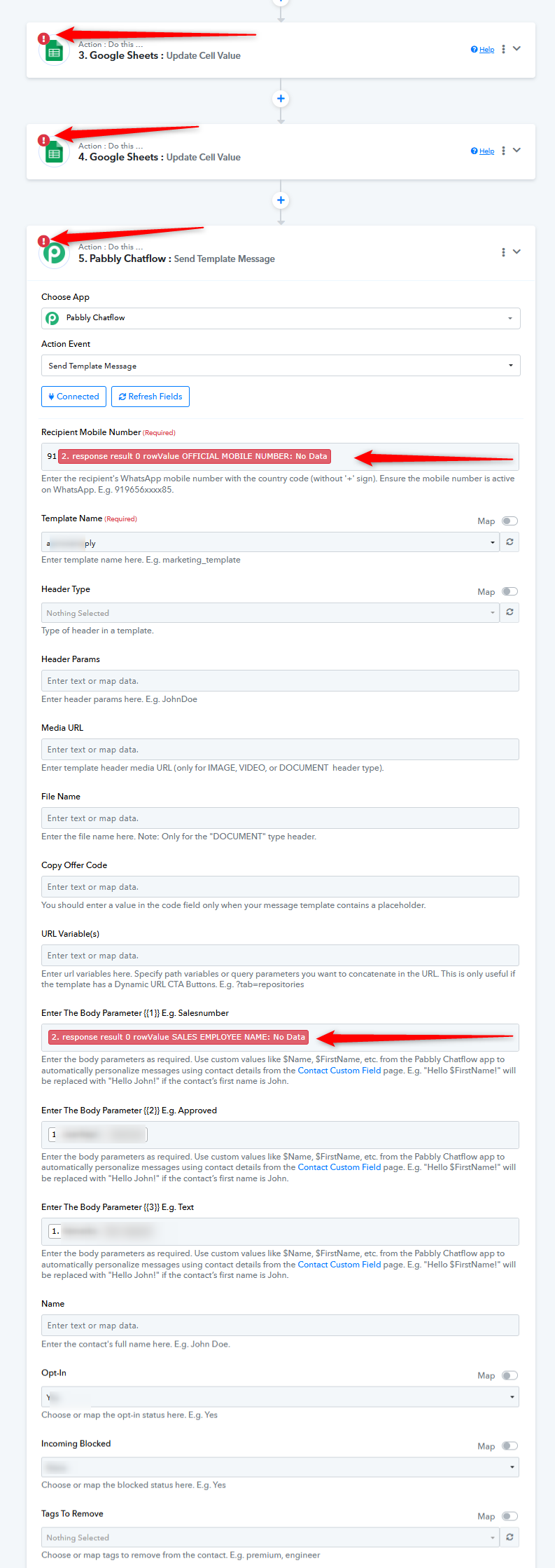

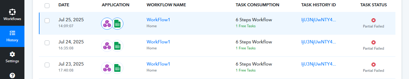

I'm using google sheet to whatsapp integration using Pabbly Connect, but there is some issue to updation is google sheet.
Error lookout data not found pls help to resolve the issue

Hello @BHUPENDER
Could you please let us know if you have changed the response of the trigger application "Webhook by Pabbly: Catch Webhook (Preferred)"? The previously mapped data is no longer visible, and it is showing an error.
We request you to re-map the action steps in your workflow accordingly.
